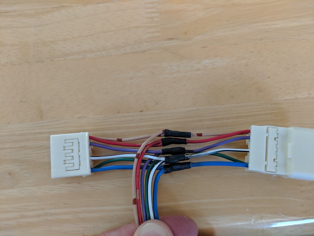

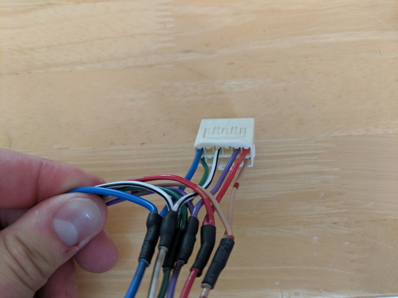

    Here is what I have for those of you that want to use the illumination circuit. This harness plugs into the cargo lamp switch (if you have one). Even if you don't the plug for it is there to the left of the steering wheel behind the useless cubby. This harness allows you do do a few other things that may or may not be of interest. You can check it out here: https://www.tacomaworld.com/threads/3rd-gen-added-lamps-to-cargo-sw.587660/#post-20918693
    Basically, it gives you access to the ILL+ (green) and ILL- (tan) wires that are needed to dim your switch LEDs. I just tested this on my truck. You get dimming on both LEDs and it turns on/off with your headlights. This harness will not be PNP, but the wiring is pretty straight forward. I can/will do a write-up, but basically you will cut the ground wire on the PnP harness near the 5 pin switch plug, and attach it to ILL-. The spliced wires on this will be about 24" long. I have this out for quoting now.

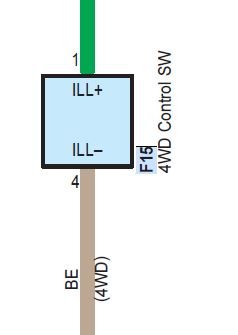

    If we go with the small switch for the center console, can we tap into the illumination wires of one of those nearby factory switches?

    You actually only need to cut one wire on the 5 pin plug of the PnP harness. You need both ILL+ and ILL-. Pin 4 is the ground and you can cut it about 2" from the plug and connect it to the tan wire (ILL-). You connect ILL+ to pin 2. This will dim both LEDs in the switch as well as turn on/off the text LED with your headlights. The symbol LED works with headlights on and off, but with headlights off, there is no dimming (normal).

    You can tap into it anywhere it exists. You only need the ILL- connection. If there is enough interest and I can find the connectors for the OEM switches I could potentially make a splice cable up so there would be no cutting. I would probably be making them to order myself.

    4x4 mode switch has it. Looking up the connector now.
    ***Parts on order to make this up*** I have the male/female 5 pin connectors also so I can actually make this PNP if you are mounting your switch in the center console or left of the steering wheel.
