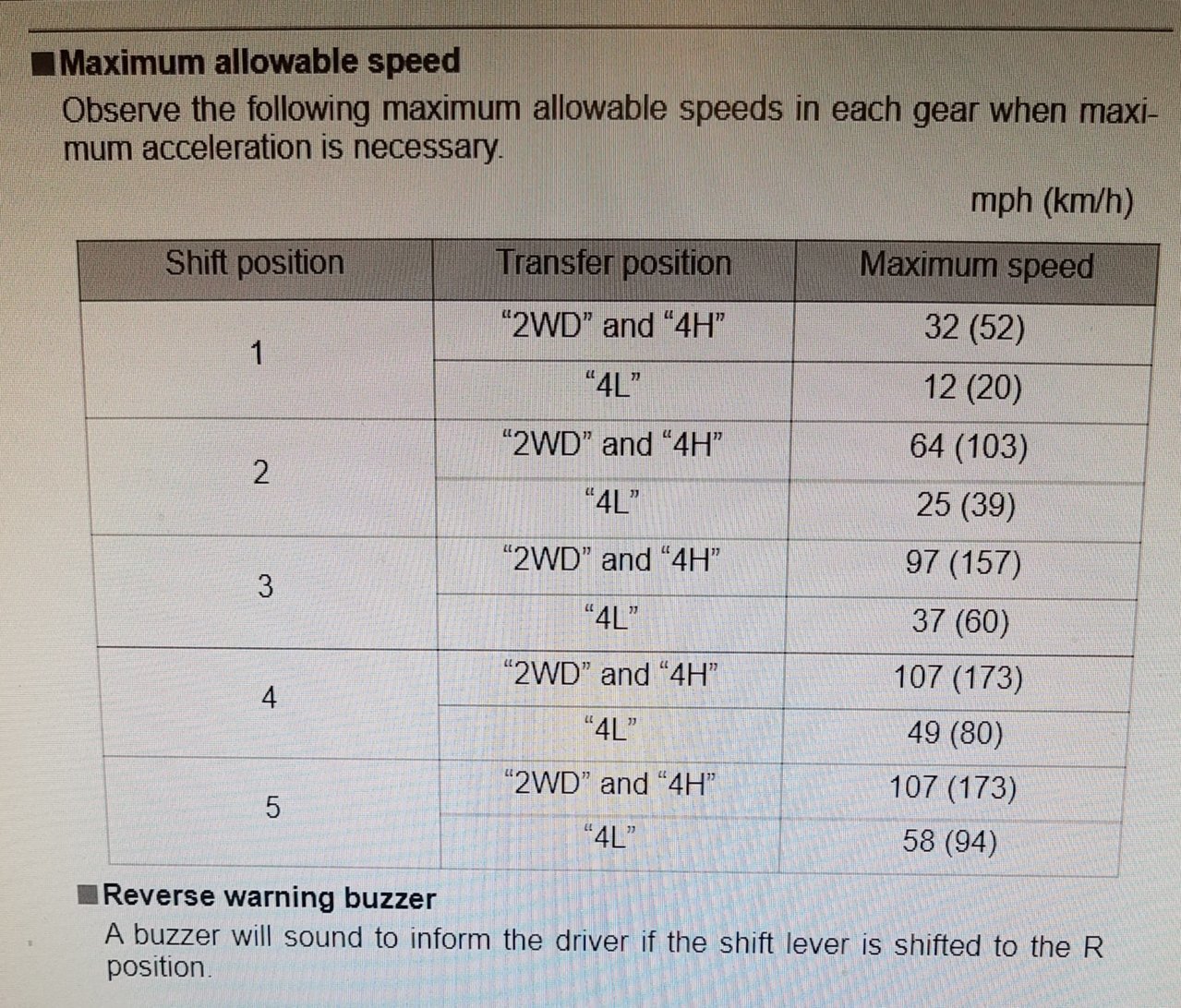

    2Lo not really made for "speed"
    This is a screenshot from online 2018 Tacoma manual (although it only lists 5 speeds)

    Doh! :homer:
    Yeah, but 58 is nice if you need to. Nothing is locking out 6th and 7,200rpm is available with OVT. :rofl::rofl:

    Can you even drive that fast outside of 2WD? Thought you really shouldn't be using 4Hi above 60mph, and 4Lo (and thus 2Lo) is more for crawling and shouldn't really be going much more than 10-15mph. Going over 100mph in 4Hi and especially nearly 60mph in 4/2Lo just seems crazy and recipe for something to blow out. Maybe I'm just stuck in the past of older 4WD systems? How fast have you all gone in 4Hi and 4/2Lo?

    Good lord, 107mph in 4Hi

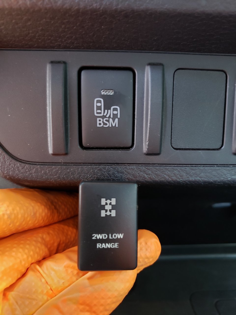

    My switch showed up today! The AOB color matches the oem switch but the lettering is a little small. I can't wait for this button to work in my truck.20200313_154807.jpg
