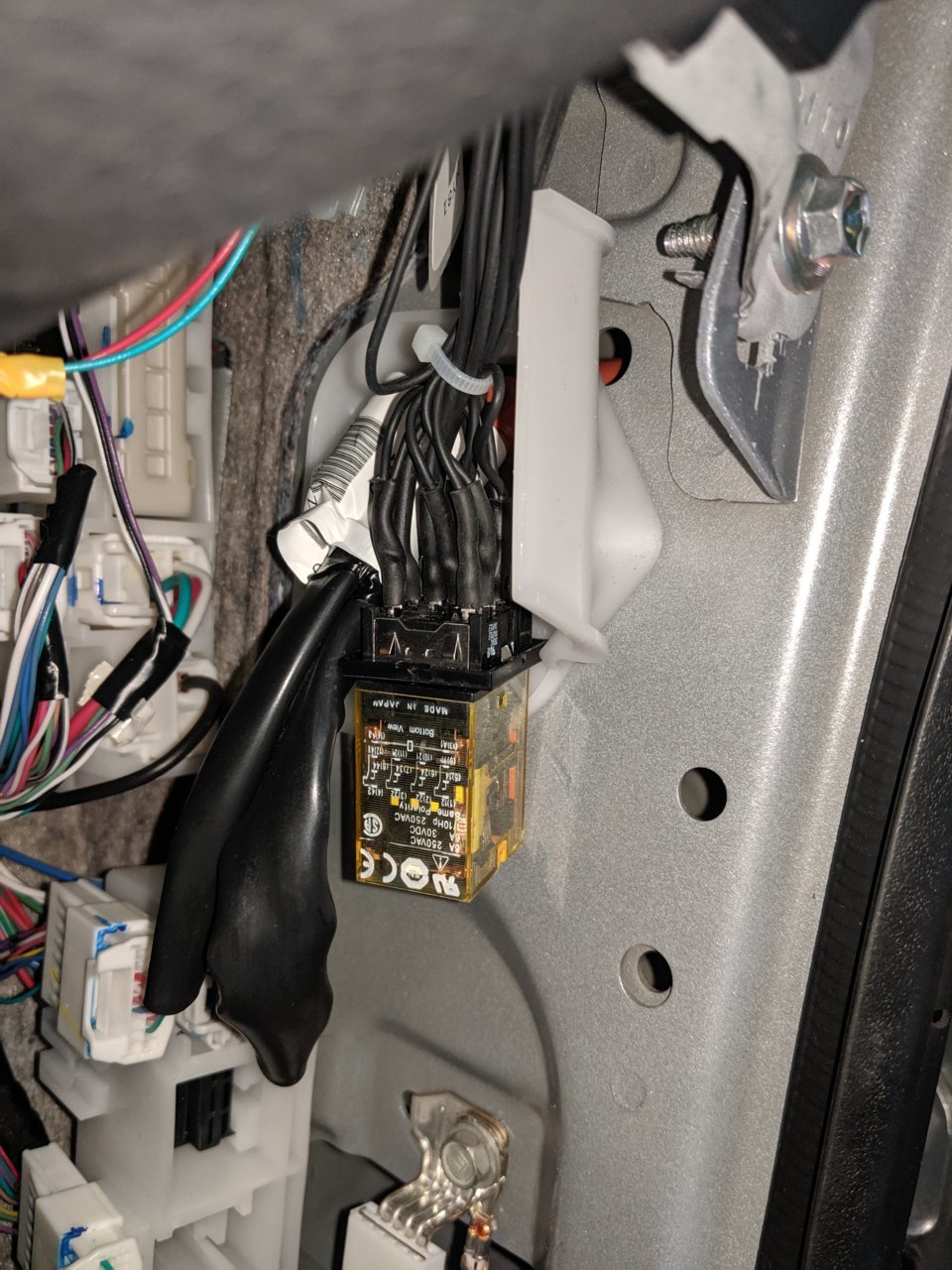

    Works like a charm.
    I was careful, and it took me about an hour and fifteen minutes with a small break.
    tip for those who are about to install: there is not much room behind the glovebox, you will need to put most of the harness above the 4wd ecu or youll have to redo steps like I did.
    if you do not follow the steps to engage and disengage EXACTLY you will get a 2wd/4wd error. Restarting the truck cleared it for me. I was curious.

    Same here. I took a lot of time being sure that the wires were not going to chaf over time and that I didn't strain any on the harnesses or bend them too tight. It took me about that long also.
    In the end, worth every second for this killer mod.

    did the relay end up above the 4wd ecu for yours? I wasnt too thrilled about that but it was the best place i could get it

    If you look at the pictures in the link of my install I put in the first post, there is enough wire length to drop it down to the right toward the door sill.

    I installed it where @lapoltba / @BigWhiteTRD showed. I might have flipped the orientation though? Relay up.
    I think that I rerouted that one a few times until I was happy.

    gah totally didnt notice that. I might tackle that another day. I think when i taped my harness up i made is so stiff that i couldnt reach there

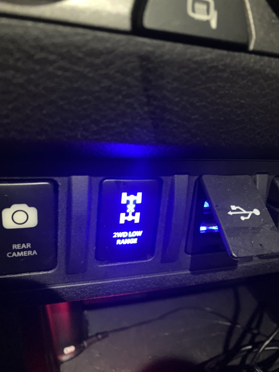

    Harness arrived a week ago. I waited until Saturday to risk learning how to pull the airbag and glovebox. It installed exactly as described. It works perfectly. I took it up Moody and Page Mill, down the back side of Alpine to La Honda, up Old La Honda and down the front side. I let it idle up and down a 10% to 12% grade. Taking curves and grades through the mountains without breaking a sweat. And best of all, I can back up a 10% grade.
    Thanks. Well worth a few $ to have access to the other half of my truck! Looking forward to when things get normal and I can take out the 3500 lb RV trailer.
    I used a small switch in the lower center console. Just below the 4WD selector. I was able to route the wire through from the glovebox side so I did not have to disassemble the center dash, just lift up the gear shift base so I could access the side.
    Easy to use.
    Engage before downshift. Disengage before upshift.
