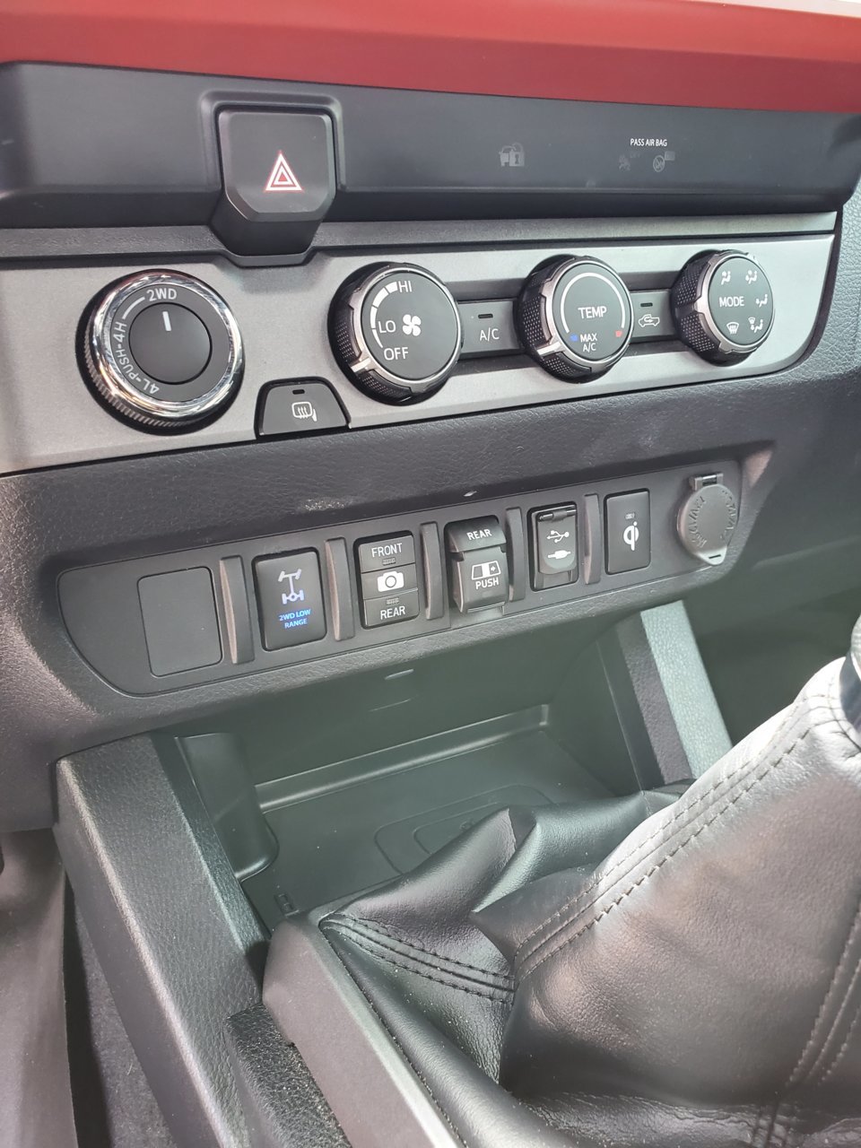

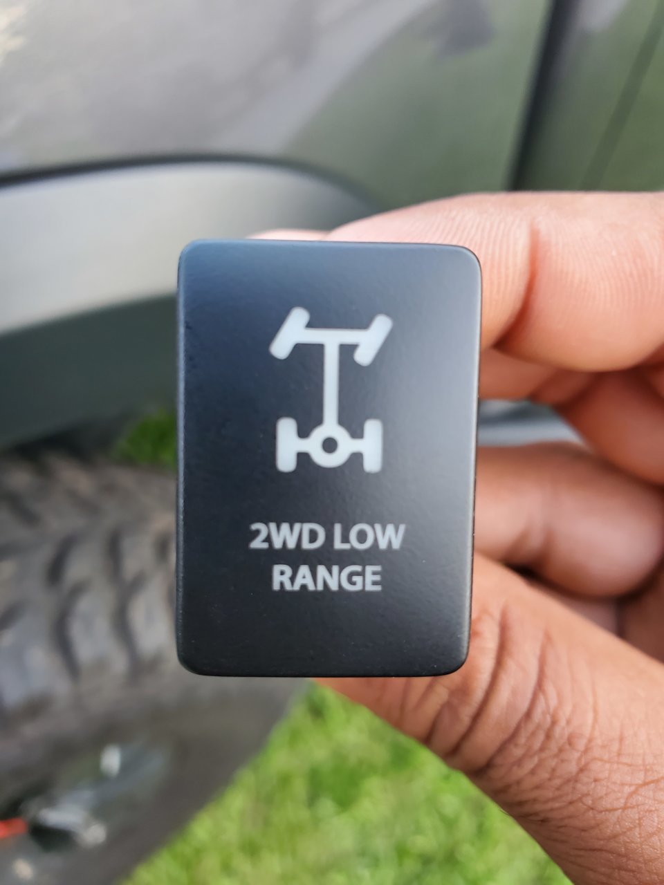

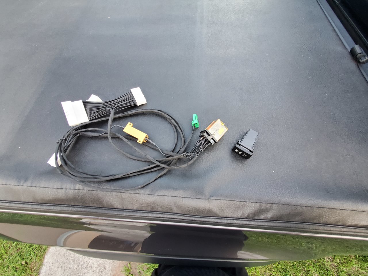

    I installed my 2WD 4LO and it is amazing! One of the best modifications you can do (especially if you have a manual).20200601_195646.jpg 20200601_195712.jpg 20200613_143517.jpg

    Awesome! Glad you like it. It is definitely one of my favorite mods and I use it all the time even when I am not towing anything. It will definitely prolong the life of your clutch.
