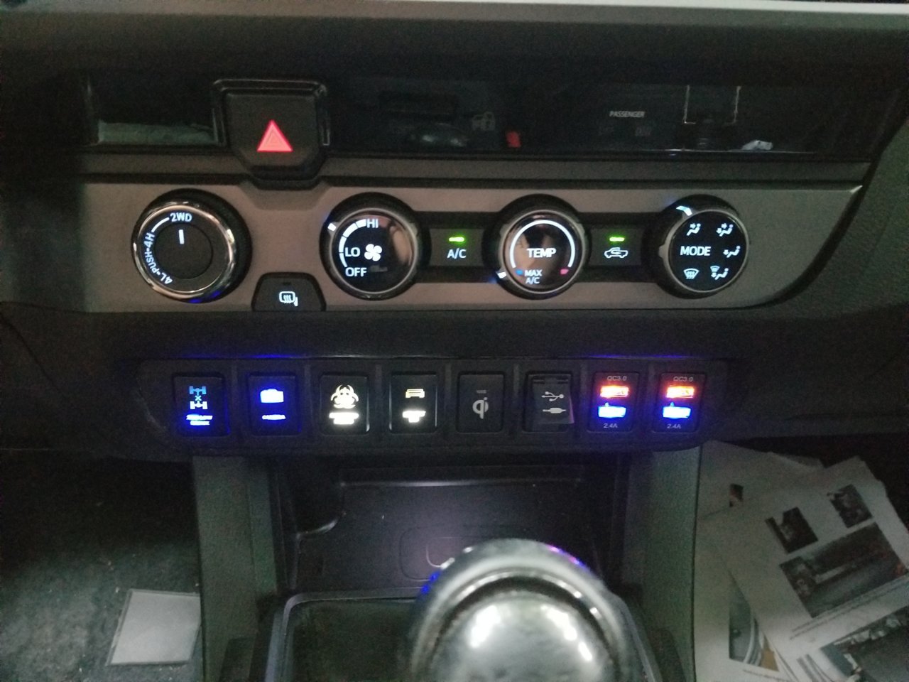

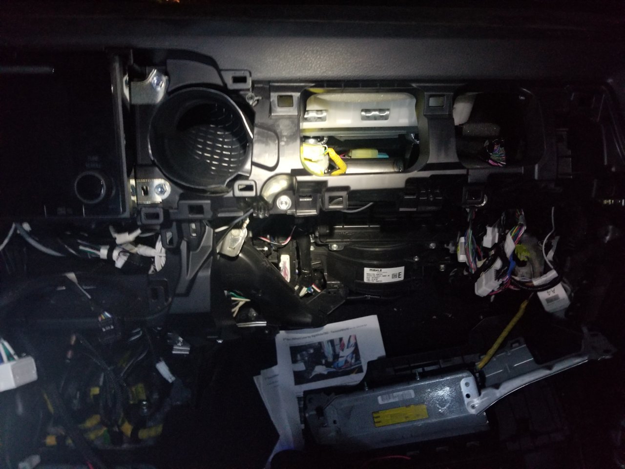

    Hey everyone, I just want to give my experience purchasing and installing from lapoltba. He shipped my order out very fast and I had it in my hands in a few days. Harness is high quality and made the process very simple. I've installed several car stereos so taking interior panels off isn't a big deal to me, but don't feel intimidated by this install, it is very doable. Install time was right around an hour or so, could probably do it in half that time now knowing exactly what I have to do. If you're burning up your clutch backing up a trailer like I was, this will solve your problem!
    Tested it out after install, made a mistake and had 2LO flashing at me because after having the clutch TSB i need to absolutely floor my clutch to start and I believe that was hanging up a successful switch to 4Lo (i mean, 2lo). So nice being able to crawl around and turn the wheel in reverse without baja'n around or slipping the clutch braking to keep it slow. Im so glad I got this done as I'm going on a camping trip tomorrow and I won't fear ruining my clutch backing up into our camp spot!
    Thanks so much!
