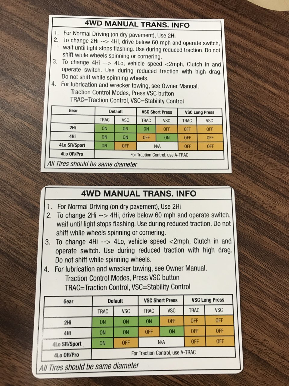

    In other news, proofs for the visor cards are in and we have a little bit of a tight squeeze on the corners. I’m playing with some ideas but maybe others have suggestions too.
