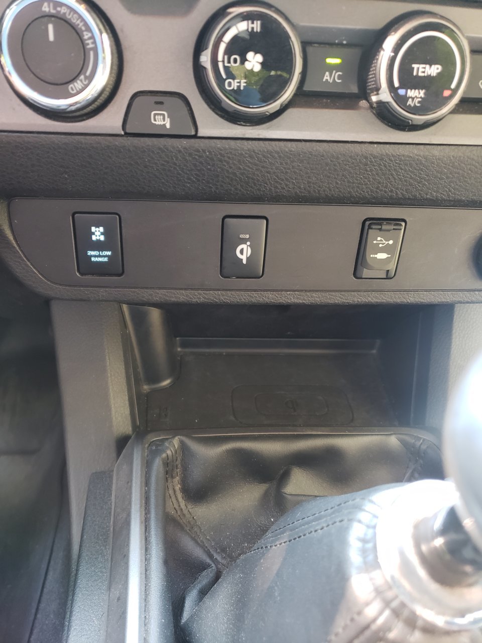

    So has anyone had trouble with a blinking 4wd indicator light when switching back to 2WD? Only way I can get the light to stop blinking is to shut off my truck.

    are you turning off the 2lo switch first?
    walk us thru the sequence precisely that you use.

    I leave the switch on. I select 4hi and once it completes the change I rotate the selector to 2WD. I don’t touch the added switch at all during this process. The 4wd indicator just remains flashing and nothing happens. I’ve tried driving with the light flashing and that does nothing. If I press the 2 low switch I get an error message.

    Sure. That happens when you don't get the sequence just right. If you got one of the cards one of the members had printed up then follow those instructions; otherwise take a look at the first post here. I've been hitting the 2Lo button first before starting to do transfer case switching in either direction, but I think there's a sequence that works with pressing the button in the middle. The error most often comes up when you leave the button press to last when coming back to 2Hi.

    my bad. Rereading the post I think I have the sequence wrong. I didn’t get the visor card back when I ordered mine.
