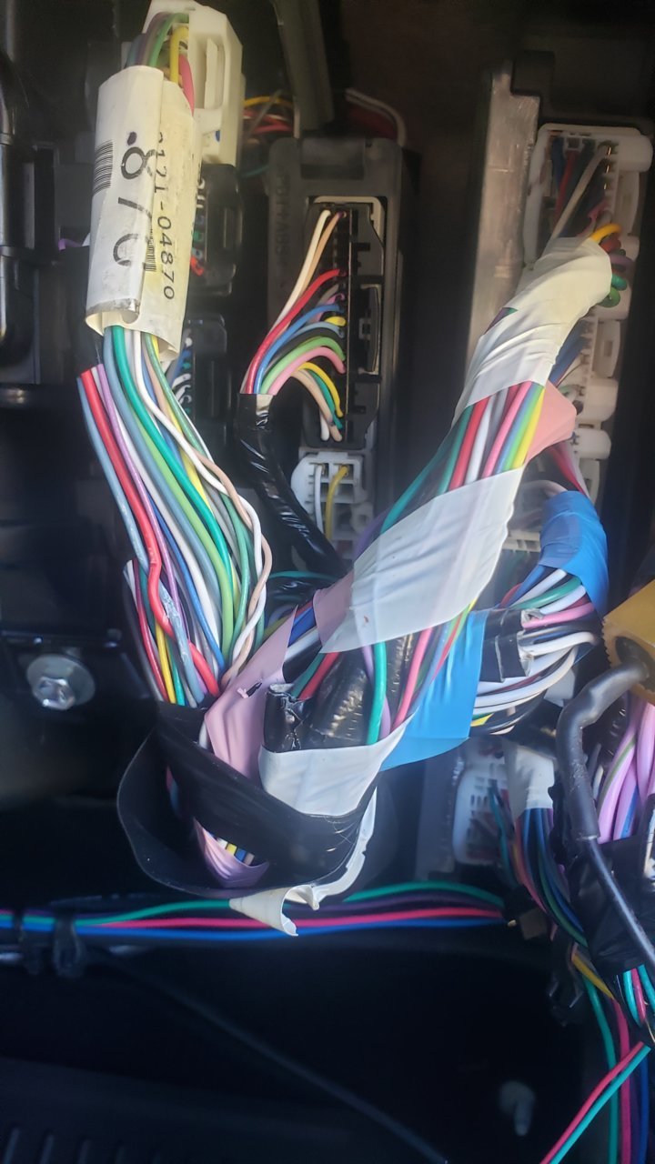

    Done TRD Sport 2020 thanks lapoltba for all

  2. Feb 6, 2021 at 9:42 AM
    #1442
    CygnusX191
    CygnusX191 Gangster of Boats
    Nov 29, 2016
    #203575
    20,943
    Timm
    St. Louis, MO
    So. Many. Stickers.
    So many goodies up there
    poroto[QUOTED] likes this.
