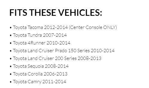

    CH4x4 small button order page says it only fits up to 2014, is that just webmasters not updating the text?

    This? From everything I have read, there are only two Toyota sizes, tall and small and any small is the same as any other small. I would consider this section to be out of date by 7 years. Might be nice to point that out to them, they likely don't notice.
    AFAIK, tall is 39 x 21mm and small is 34 x 23mm. If you have a decent micrometer or even a ruler you can likely measure the size of your blank to confirm.

    Well, so much for that. The CH4x4 shipping to WA is ridiculous, it does not cost that much to stuff a small button in an envelope and stick it in the mail. Gonna have to figure out a different option:
    Code:
    Subtotal $19.98
    Coupon: special20 -$4.00
    Shipping
    [LIST]
    [*] USPS First Class International: $17.95
    [*] USPS Priority Mail International: $65.56
    [*] USPS Mail Express International: $82.48
    [/LIST]
    Tax $0.00
    Total $33.93
    UPDATE:
    AirOnBoard is much better, and total is less than CH4x4 with coupon code:
    Code:
    Subtotal $19.98
    Shipping (USPS Standard Shipping) $5.65
    Order Total Incl. Tax $25.63

    That doesn't look right. It's showing international shipping. Their checkout is a bit weird. Make sure you selected USA.
