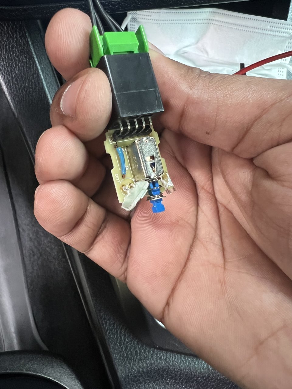

    My OCD kicks in when I look at the different light color, even after swapping LEDs between the two buttons I bought, so I checked and turns out the cheapest dash button i could butcher to pull the LED is the ECM power button at only $8 dollars. I added it to an order I was placing for oil filters and lug nuts to save the shipping cost. This will be tricky, but I need to find some time to see if I can remove this LED and solder “legs” to it to use on my current button without destroying the LED.

    I'm assuming the OEM switches use an SMD LED. You're going to have a pretty hard time making that work with the aftermarket switches. You would be further ahead just buyhing a switch from AOB. If you don't like the symbol, you can swap internals with the CH4x4 switch. They aren't 100% identical, but it does work. I did it with mine. Worst case you can swap LEDs.

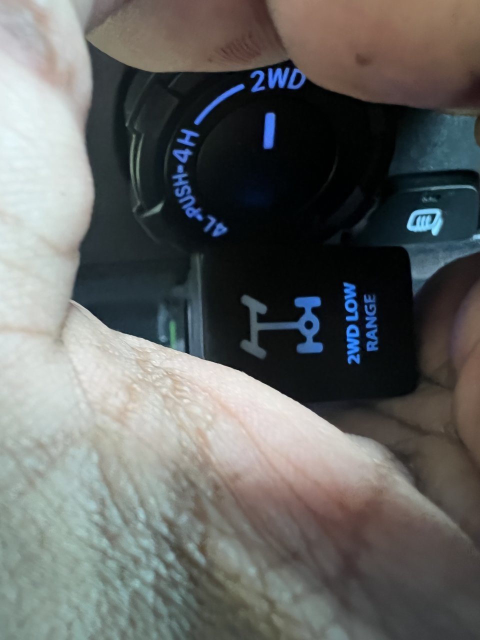

    That’s exactly what I did. Bought two switches and just swapped the LEDs to get the logo and color I wanted, but I find it to be pretty far off still. Maybe I just have too much time in my hands or my OCD is worse than I thought. :rofl:

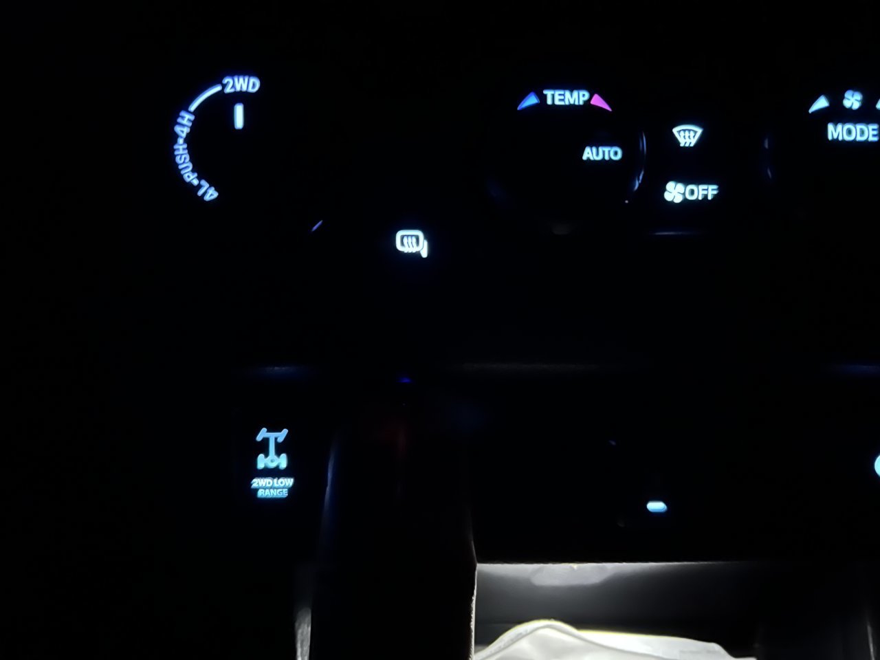

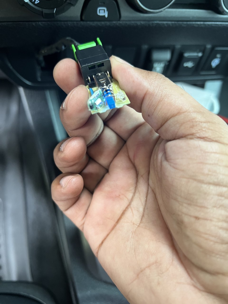

    Mission somewhat accomplished. I ended up cutting all material I could off the little board and soldered it at an angle so it would fit. Also, had to put a jumper to bypass the resistor on the switch, so my little contraption would get full 12v. I disabled the second bulb that comes on when switch is on, since I don’t care about that future and even if I had a second ECM power button to butcher, it wouldn’t fit using my method, but t I can sleep better at night now.:rofl:

    Another pic at night.
