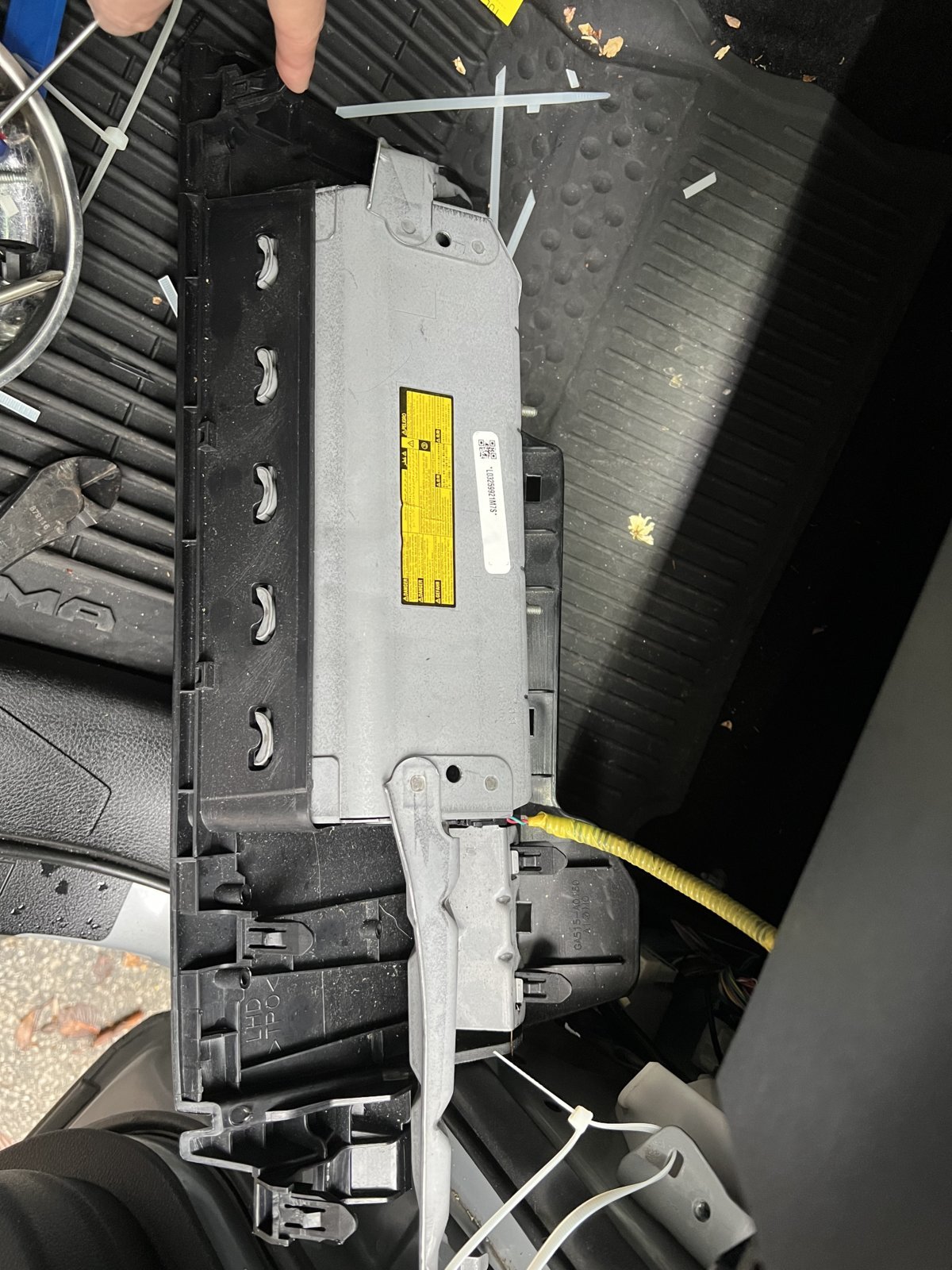

    This is the part I'm currently struggling with...any additional tips/advice to get those plastic tabs undone? I'm afraid to break them!
    "Next, wrestle with the plastic tabs. A medium width flat head screwdriver can help to coax them loose. My vehicle had 3 such tabs and I spent at least 15 minutes on this step wondering how to get it done. I'm guessing subsequent disassembly will be substantially easier than the initial one. The tabs can be squeezed from front or rear but rear is very difficult to access so front with some sort of flat blade screwdriver seems the best option. "

    Use the flathead to push the tabs in gently, then pull the dash. It was meant to come apart, so as long as you don't start going hulk on it, you should be fine

    I think the key is to simultaneously push tab w tool and pry back with fingers. Without visibility it’s more difficult the first time. Pull without forcing but with purpose. Push in the right spot and you should release the tab. Ideal is push then pull clean. But some pull tension before the push can help identify proper push technique.
    even if you mangle the tabs, they can be mangled back and aren’t visible. Just nice to not mess them up too bad the first time.
    difficult to explain with words.

    I was able to get it by reaching behind and pushing (up) on the tab from behind to get it to release--didn't have any luck any other way. The last tab gave me the most trouble...until I realized it was already loose and I was actually just getting hung up on the glovebox door and nothing else :facepalm::anonymous:
    Some of the write-ups mention two tabs (I actually count three:notsure:).
    I'm still pretty nervous about any of the tension tugging on the airbag wiring, but no visible damage or anything.
    On to the rest of the project...!

    Great work, take photos to help others if you remember. It’s been a while for me.

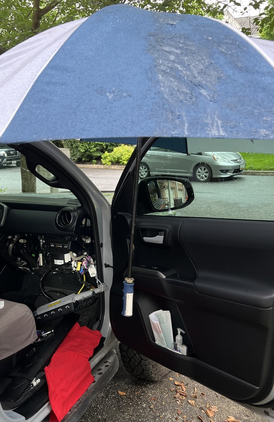

    Who’s good at Where’s Waldo?!
    I’ve seen a couple of different ways it was recommended to route the new wiring (for reference, see post #286 here: https://www.tacomaworld.com/threads/2lo-plug-play-harness-discussion.592035/page-15#post-20836143)
    This is what I came up with to make it as compact as possible...
    ***EDIT: See post #1922 for new “method” of wiring routing.***
    I’m totally new to wiring/electronics…if you have a keen eye, anything look like it should be rearranged here before button it all back up? Want to avoid pinching something LOL
    Also…How concerned should I be, if some raindrops and moisture got in under the glovebox, etc? Was working outside and it rained on me with the door open.
    Im putting some old newspaper under there overnight to wick, and will reassemble in the morning.

    If anything resists being buttoned back up, stop forcing it and start looking for a stray wire.
    A little water won't hurt, but the newspaper idea is solid. Run your AC next time you drive to truck to get maximum moisture removal.
