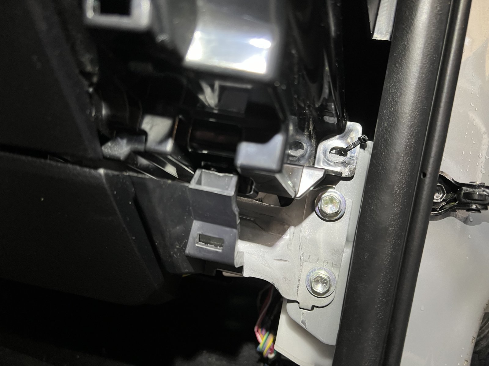

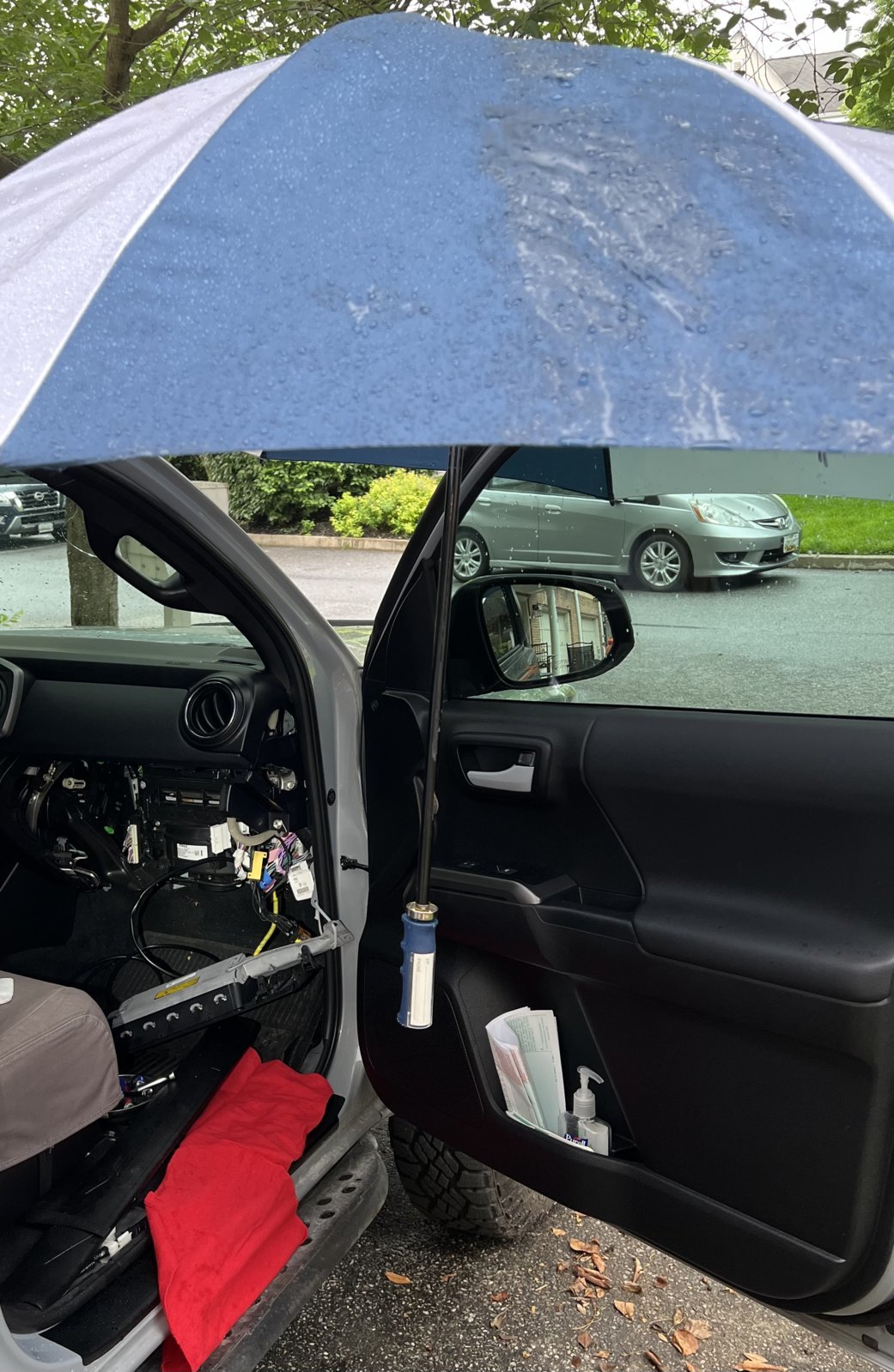

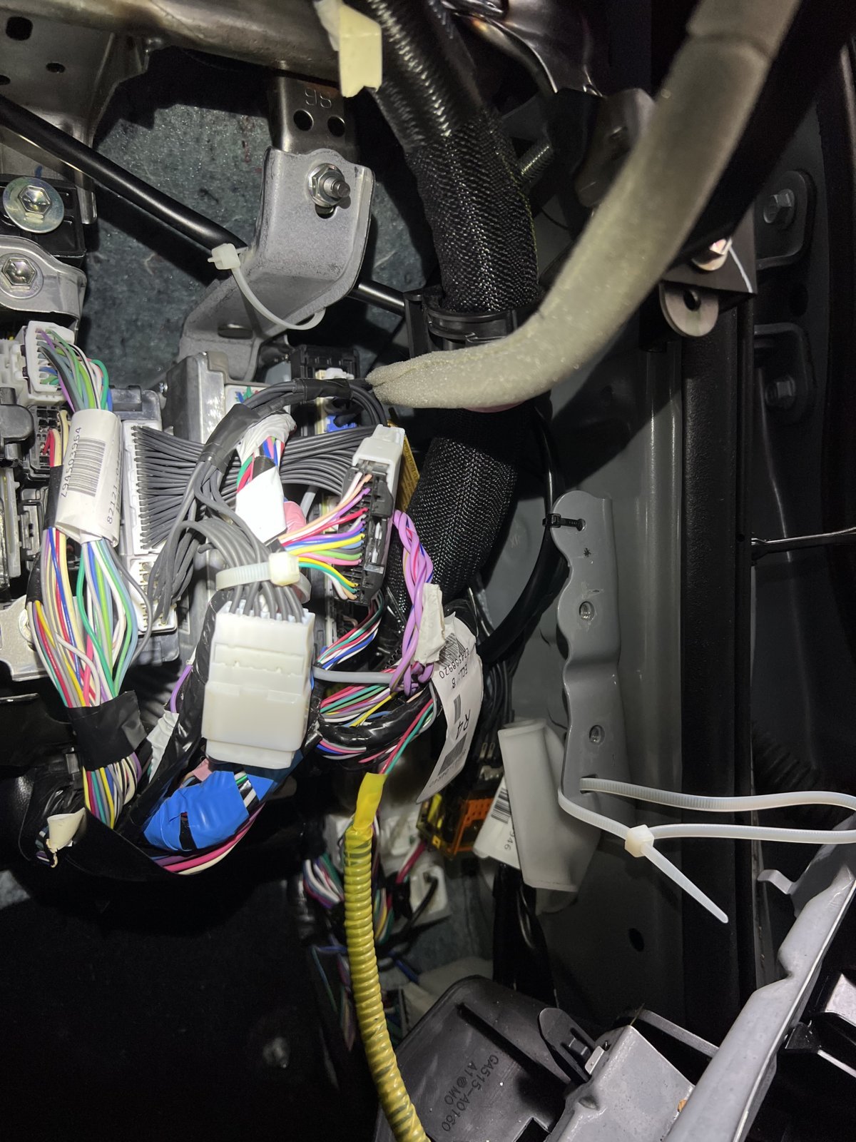

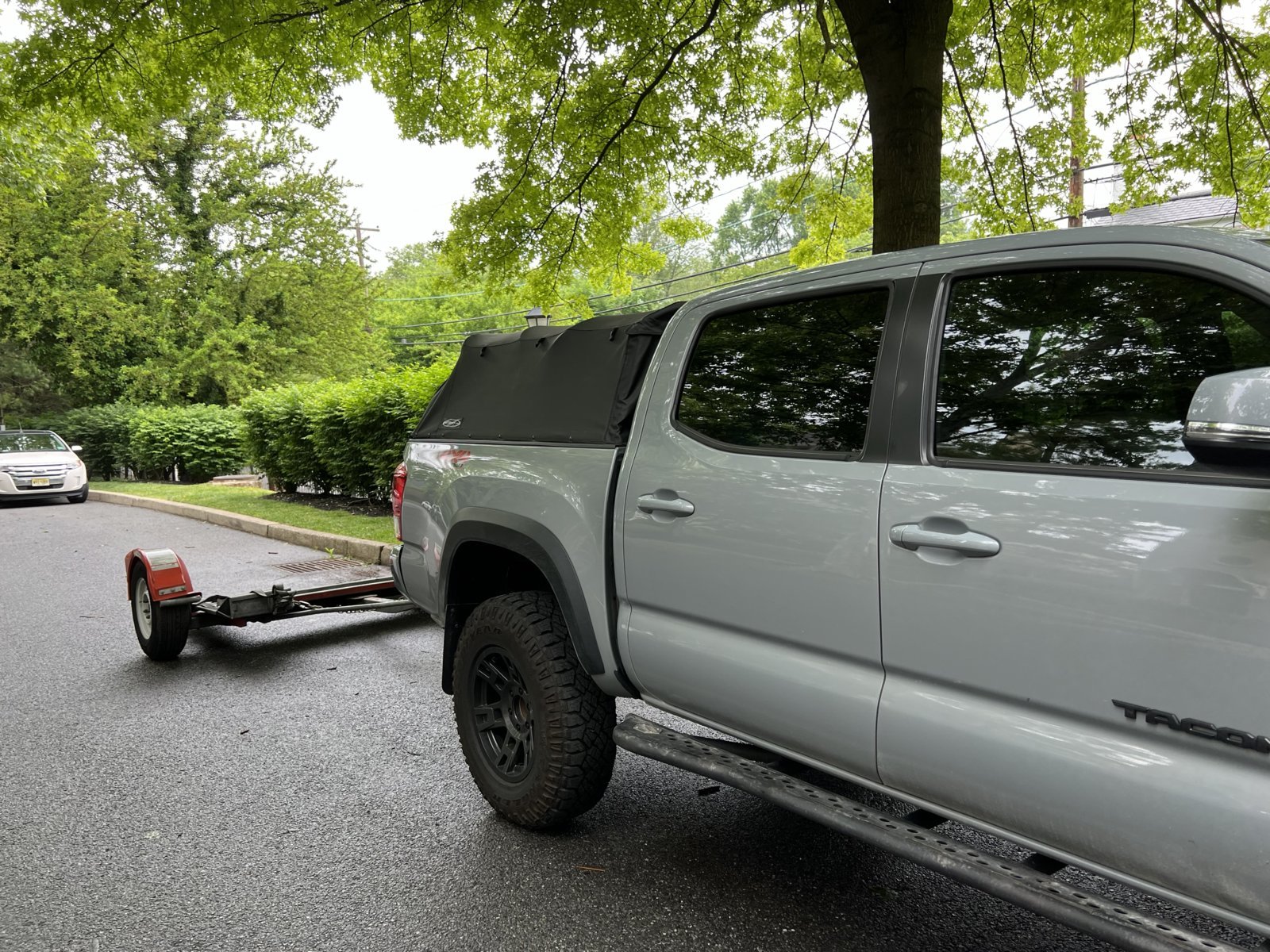

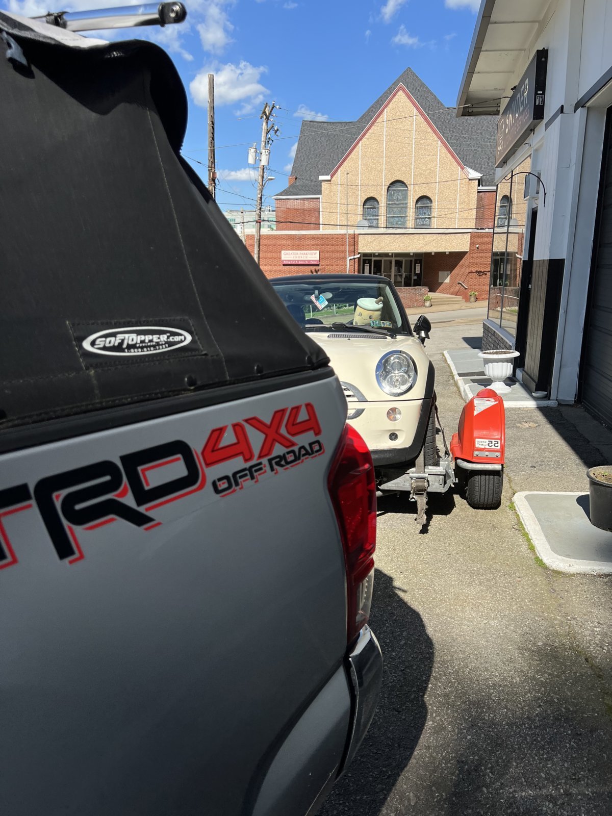

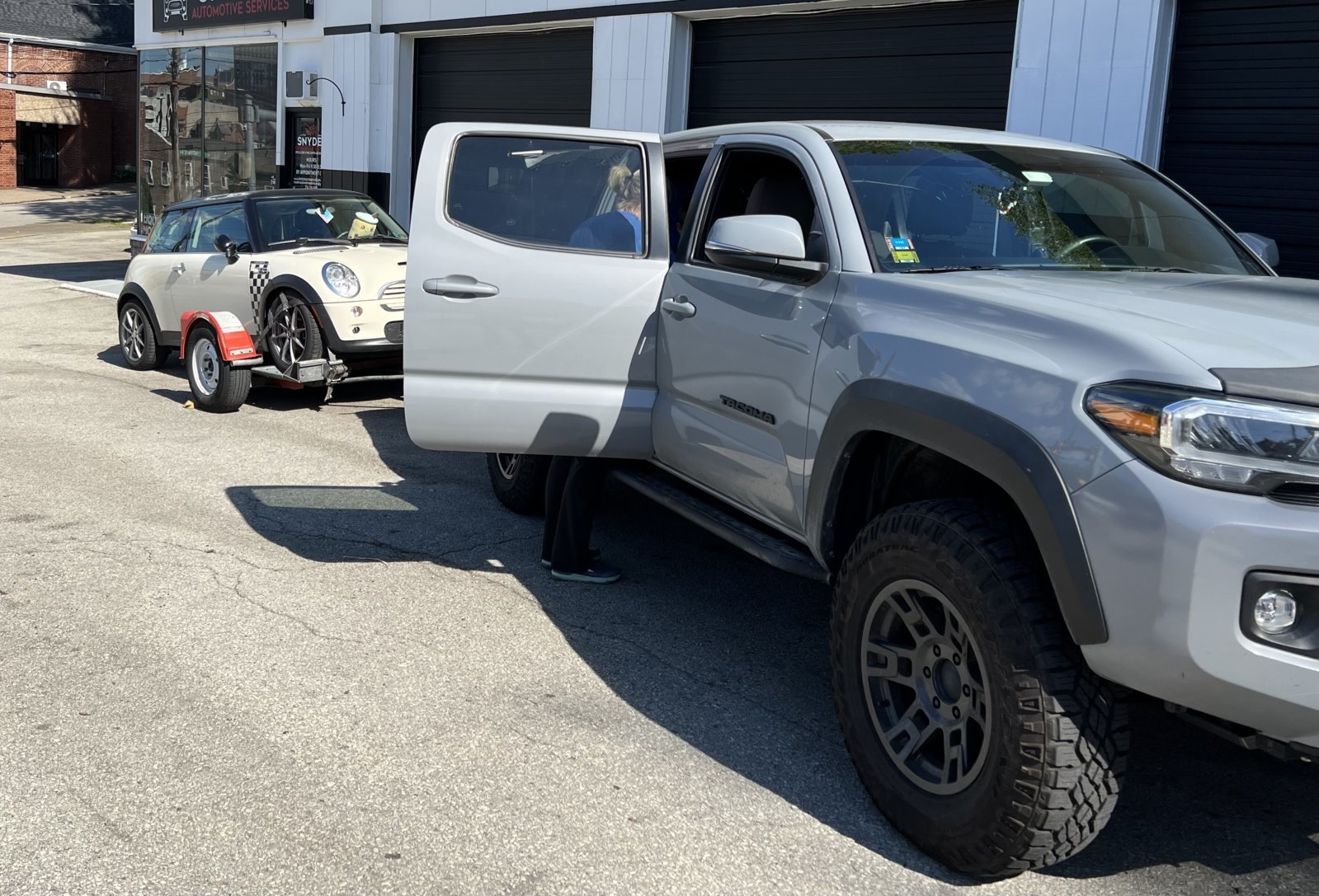

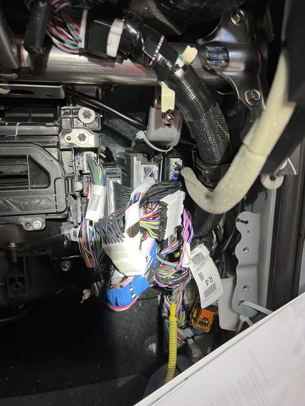

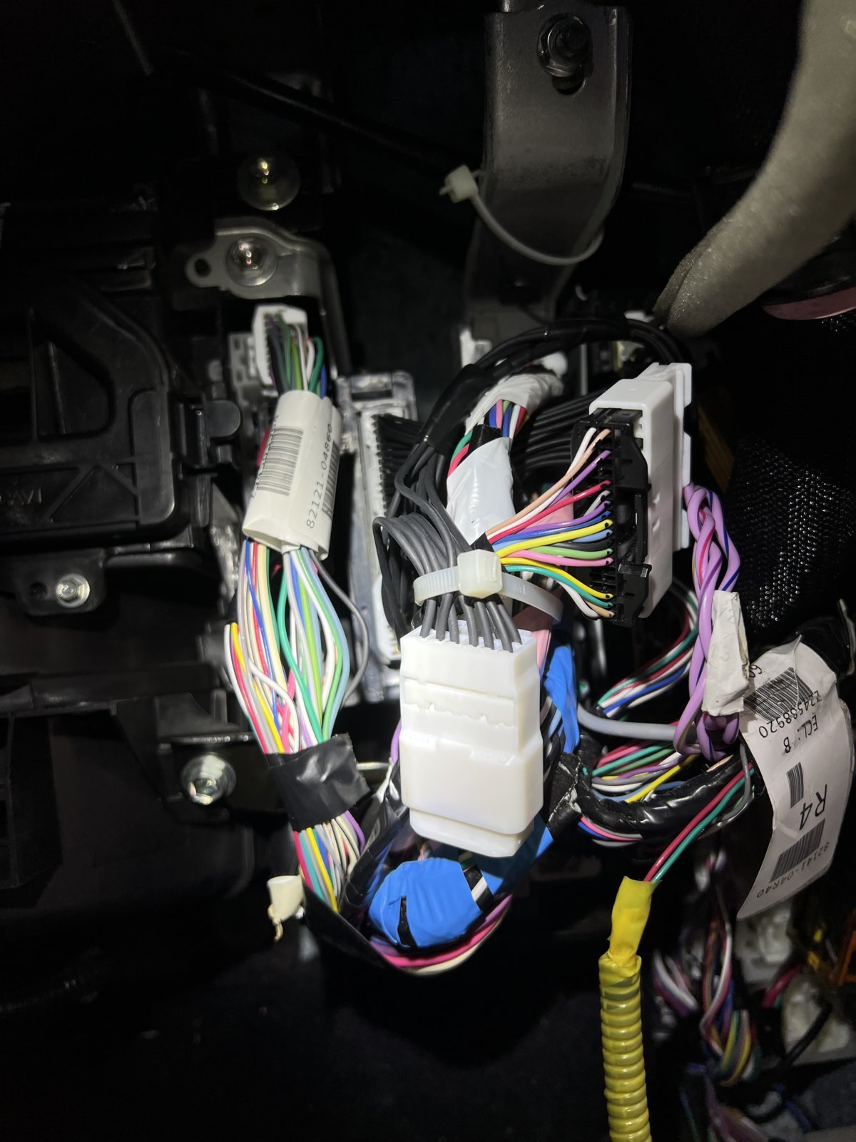

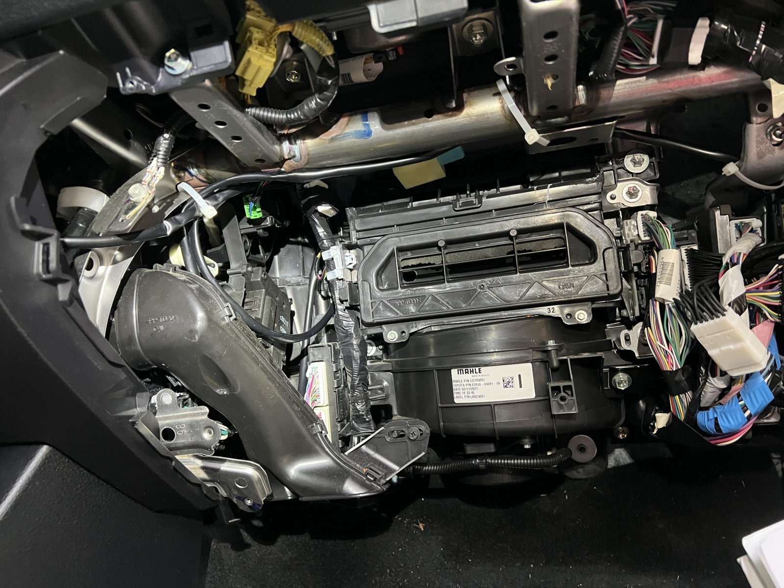

    Meant to circle back and follow up on my recent install (post #1916) with an update! Back in May, I was in a hurry to do this job on a Saturday because I sort of unexpectedly had to drive to another (hilly!) state on Sunday to go pick up a car on a dolly and was worried about not having enough torque on hills with the trailer. BTW, no rain in the forecast for that Saturday, but of course it rained on me the whole time while trying to do this install!
    Anyway...here's the update:
    On early Sunday morning before I buttoned everything back up, I decided I did not like how I had the wiring routed, especially after trying to re-install the glovebox, which wouldn't bolt on without a lot of pressure on the stack of wires. There's very little room in there! It kind of fought and resisted, and I didn't want to force it. So I undid the routing of the wiring shown in my last post and redid it in a way that was a little bit neater and fit better--see attached pic. It looks like a rat's nest, but everything seems secure. I went up, down, under, and over...pretty compact now.
    Couple of other important notes to add about my install (which might help someone in the future):
    1) unlike some of the dudes/gals in here, my arms were puny enough to fit behind the temp controls, so I didn't have to mess with the center stack trim or unscrewing radio, HVAC, etc. Simply reached in there carefully, popped out the far left blank in the row (blank/button directly below the 4WD knob in the center stack), handed myself the wiring for the new button (see pic here), routed it safely back toward the glovebox area, and snapped the new button in place. Then I zip-tied the excess at different points, being careful not to have it rub the servo mechanism (blend door?).
    2) I secured the end of the black wire (near the relay) to the glovebox mount in the kickpanel area (see small black zip tie in this pic). When I went to re-install the glovebox, I realized I blocked a mounting point--D'OH! I ended up NOT re-using the lower right screw point for the glovebox and just zip-tied it there. Seems fine this way.
    3) I towed the car dolly back no problem...didn't even have to use the 2LO mod once LOL. Towing with a 3rd gen Tacoma was not necessarily fun, but wasn't as bad as I thought it was going to be. Stop and go heavy traffic on an uphill highway sucked the most, but still did fine (probably shortened my clutch life). For the most part, towed without any major issue. Just took some effort and thinking ahead, which anyone should do with a trailer anyway--never let yourself get too comfortable!

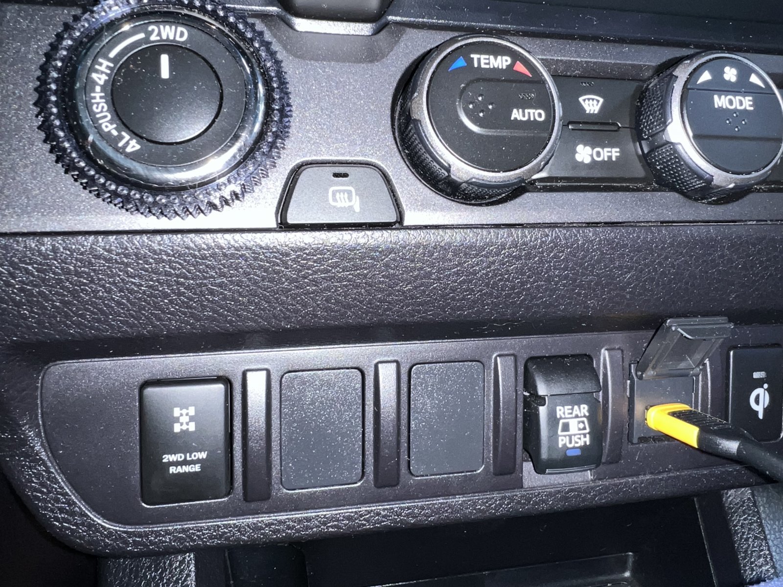

    Just installed! Works great.
    I do have one issue tho, and that is that the switch is illuminated if the key is on... Not when the lights turn on.
    I'm using the AIB switch.

    Not an issue, that is how it was chosen to be done. You can get a switch illumination harness that will tie it to dimmable dash power if that’s preferred.

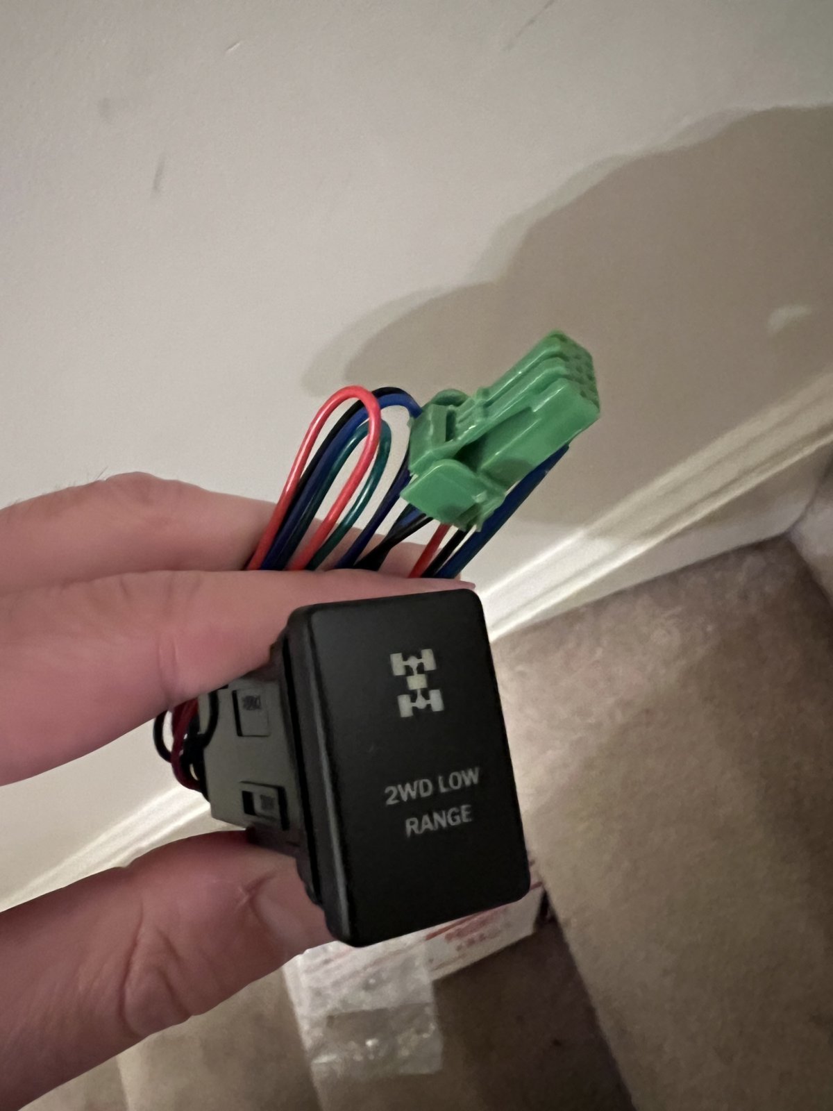

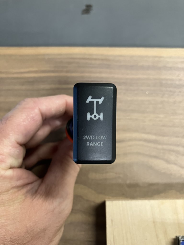

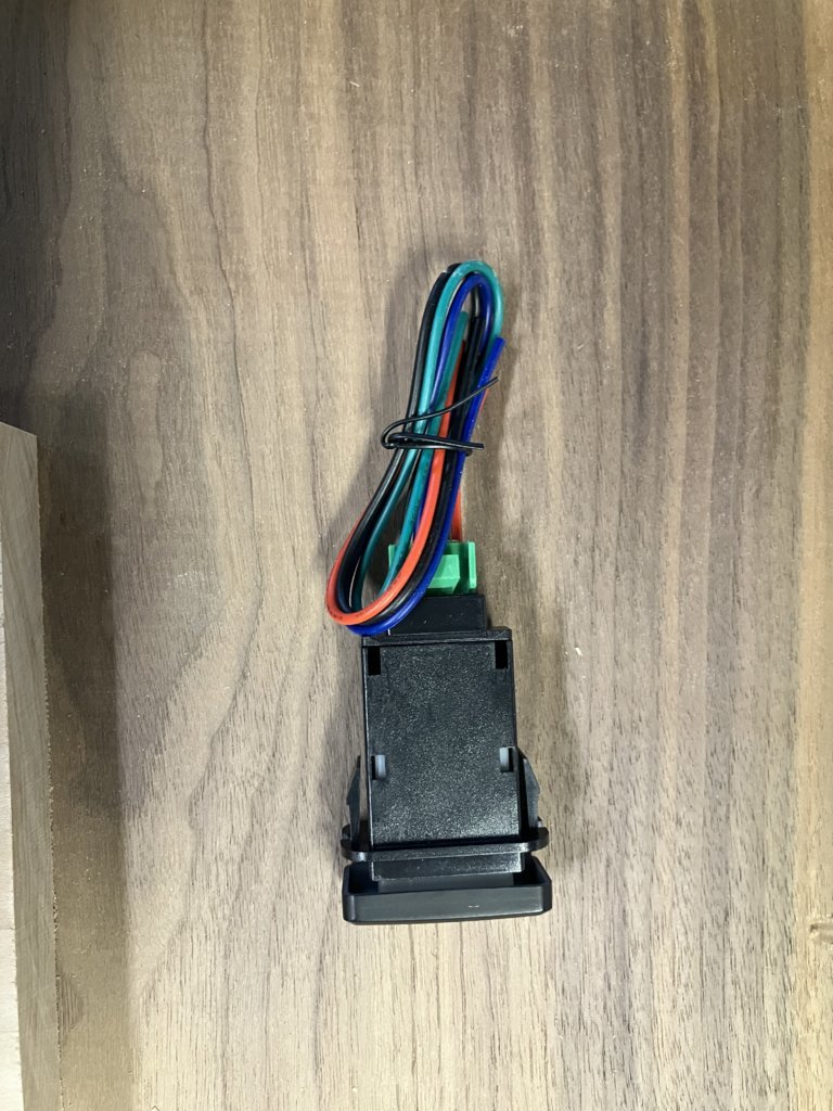

    Free switch for someone who can use it. I swapped with the “short” version. Had this switch installed and it worked perfectly. PM me…pick up local in the SF Bay Area or just pay for shipping and I’ll send to you.
