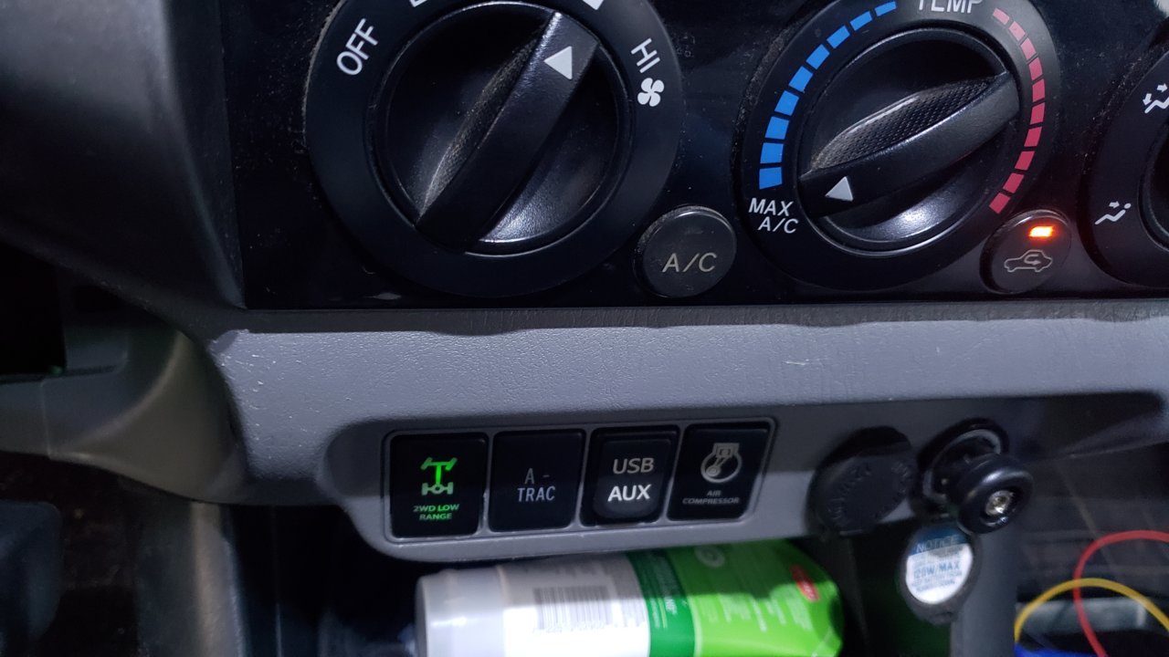

    Got around to installing my 2LO module and switches from CH4x4 today.
    Side note for those wanting the backlit switch but not wanting to splice into vehicle wiring there's a stud right next to where the module goes you can use for a ground and if you tie the switch output and switch led wires together (for the CH4x4 switch anyway) it will glow dim when it's off and bright when it's on so no need to tap into dash backlighting.

    Did you remove that lower plastic piece to get into those middle switches?

    No I popped out the A/C controls, I used a small flat screwdriver to pop out the blanks, and I unbolted the radio (4x10mm bolts behind the A/C controls) and fished the wires up and through behind the glovebox where the main harness runs.

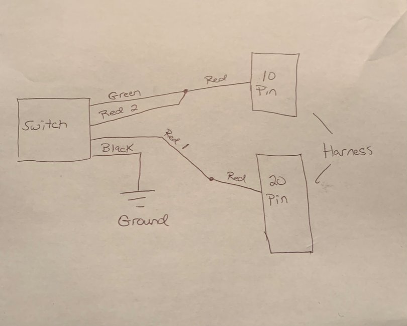

    A few things
    I contacted @Up2NoGood because the switch I bought from ch4x4 had slightly different color wires than the diagram this thread shows. He got back to me ASAP with the diagram that works with my switch. I thought I’d share the diagram in case anyone else has the same switch. Thanks for all the help @Up2NoGood
