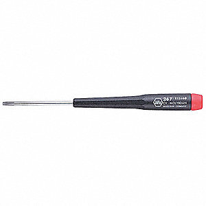

    I have a favorite little slotted driver for doing that. It sounds stupid, but it is one of my favorite tools. I've put it through hell for what it is and it is still store fresh.
    One of these guys:
    I keep meaning to grab a No. 0 or No. 1 crosshead.

    I used a larger/wider one with a twisting motion which worked well. I like the Whia stuff a lot. I just wish I could justify the $$ for more of them.

    I just have that one. I probably paid $5 for it over 20yrs ago. It seemed to be a stupid price then, but it has lived beyond anything that I would have expected, including metal to metal prying.
