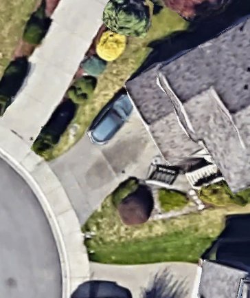

    Yes. For my Taco, it has to be a full stop to go in or out of Low Range. If I move at all, esp backward, it is one of those noises that you just don't want to hear. Once the actuator decides to go, it's sending it.
    Definitely try it out before you need it.
    I have used it in highway traffic a few times, controlled on ramps many times, and twice in the COVID vax wait lines. The killer app is always my short, sloped, and odd-shaped driveway and tight garage though. Just a clutch saver. This weekend, I reversed up over the curb and up the driveway without touching the throttle.
