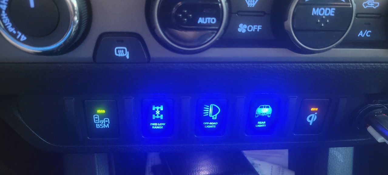

    Finally got around to installing mine. Nice instructions and probably under 1 hour. I had previously installed the switch(s) and ran the wiring harness when I installed my LCi6 and 4 channel amp.
    Mod works exactly as described ! Cheers.
    First time there was an error cycling out of it. But I followed card instructions and it reset also as card mentioned.
    May order up a custom dimmer plug and play harness to take the brightness of the switches down but currently my OCD is allowing it. 20221017_182911.jpg

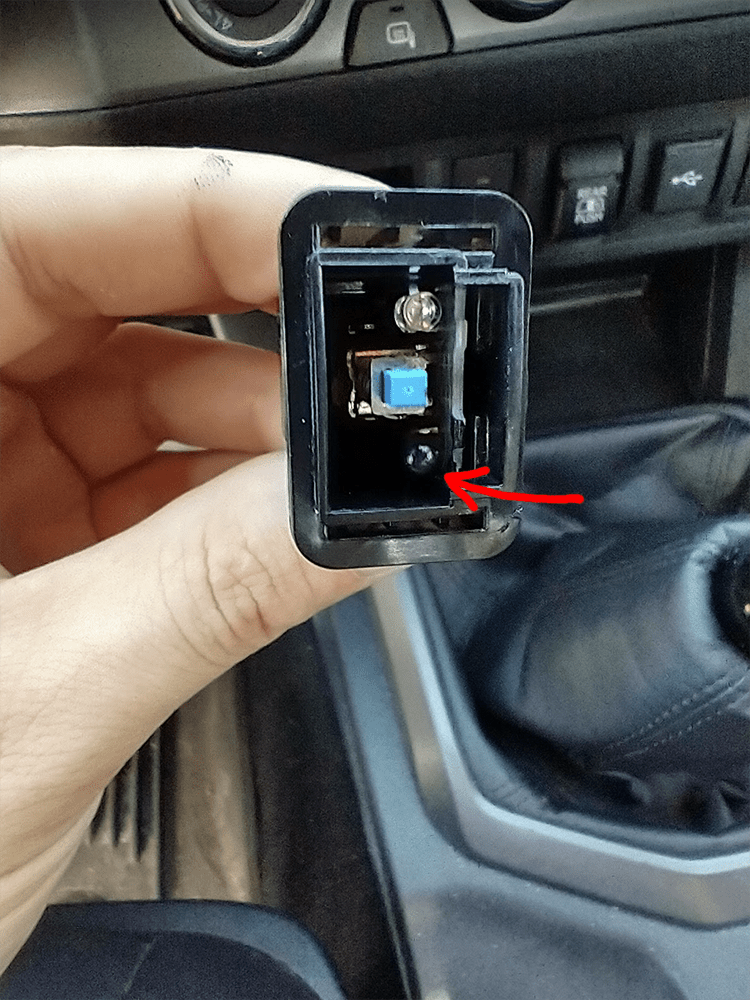

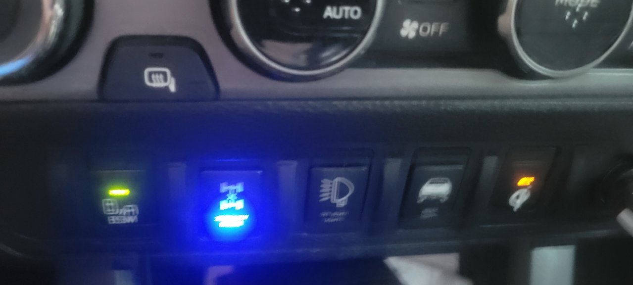

    I used a really low-tech method to reduce the brightness of my switch. I painted over the always-on LED with black paint. Now it's only a very very faint glow when the switch is inactive.
