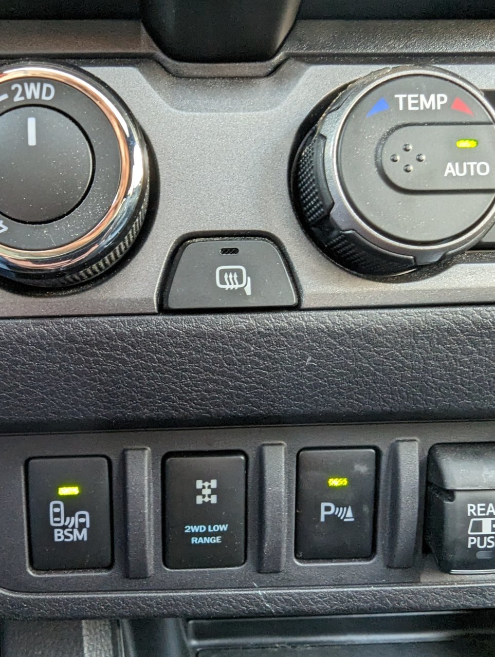

    Are you just dimming the switch backlighting or is it on all the time?
    Worst case can't the illumination be tapped into a neighboring switch?
    I didn't realize this came out, I was waiting for this and the "anytime locker".

    The LED is stupidly bright so it needed to be dimmed down because driving at night was annoying.
    helix66[QUOTED] likes this.

    Gotcha, I'd definitely cut it into the other switch illumination and that blue is super annoying as well but I'm not going to change all of the switches.
    For me even the "D" on the shifter was annoying, I cut a piece of dark window tint film and laid it over and it helped a bit.

    I agree. I hear that the dimmer is controlled through the ground.
    and this guy knows the answer
    @caribe makaira

    You are correct dimming is negatively controlled via the Combination Meter.

    Tested in automatic, I dont have any reason to expect different behavior in manual truck, but dont recall anybody ever testing it and letting me know...
    If dash selector is kept in 4lo, and the added switch is in 2lo ON position, the truck can be shut off, restarted, stall, etc and will still be in 2Lo.
    See my original instruction manual:
    https://www.tacomaworld.com/attachments/2whl-lo-rev-1-1-5-31-21-pdf.4559074/
    7. Note: The truck can be left in 2-Low when shut off, by leaving the dial selector in 4Lo and the added 2Wheel Low switch activated, but make sure spouses know this. If the truck is changed back to 2Hi with the 2Wheel Low switch activated, a computer error will result, (as the truck is confused by the front ADD refusing to switch back to 2wd. To clear the error; select 2Hi on the dash selector dial, deactivate the added 2Wheel Low switch, and power cycle the truck (ignition off, ignition on). Truck should return to normal operation.​

    I can confirm, truck in 4lo with 2lo switch on. Turned truck off. Restarted and was still in 2lo with no issues. I was crawling in a Walmart parking lot.:anonymous:

    I had no need for the Qi charger so I removed the switch and used the dimmer control wires off that to power the 2lo switch, Anytime back up camera switch and light bar switch. Worked well and now I have dimmable illumination on those three switches. Just wish the blue was a better match for the factory shade.

    Are your switches “air on board” brand? The light blue seems pretty good.
