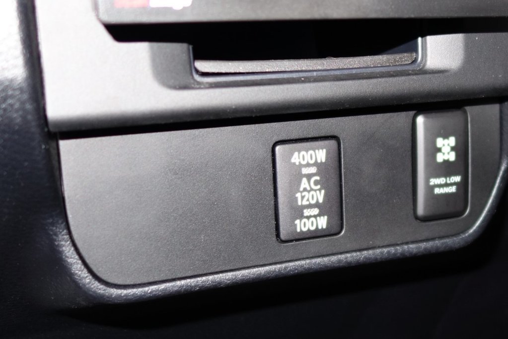

    Man, that card has some serious typos, and could use some more info on trac, vsc probably. (And a warning to not print on laser without laminating.)
    But I am blaming you all... come one guys, proof some stuff! JK
    Btw, I am using the AOB switch on the lh side of the steering wheel. The color and button shape are pretty good, but not perfect.
    I didnt bother wiring up the dimmer line on the switch.. I just wired the switch to illuminate when 2whl lo was active.

    Poor pic of AOB switch
    tonered and lapoltba[OP] like this.

    I have another one of their other switches in blue. Looks pretty close to factory

    No, I don't. Sorry, I realize it sounded like I was speaking from personal experience. AoB indicates that it is a more accurate match, and I've read several comments on TW that the light blue does in fact match better. I've also seen many comments that the regular blue does not match (too bright and too blue), but there are several DIY solutions to make them match better.

    Location wise, I know. Just wanted to give an idea of how their switches look cosmetically and all... too bad it's a poor picture.
    I have the 'blue' , not 'light blue' I believe. It's not a great match. I dont know if the light blue is better, but I assume so.
