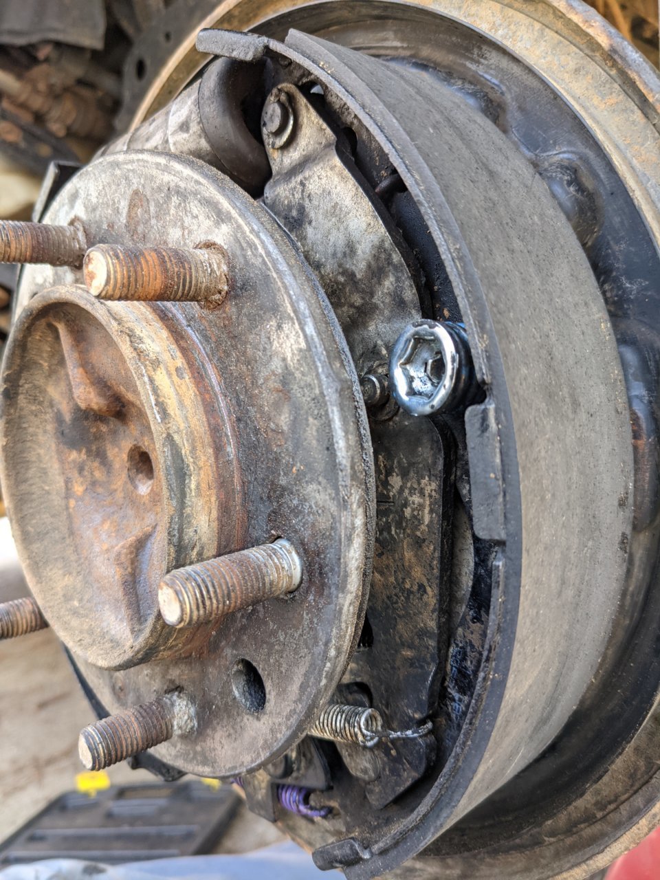

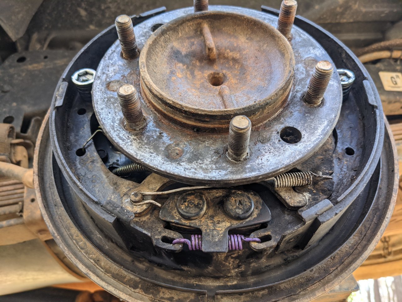

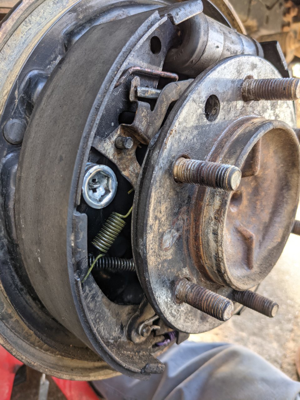

    Here's some more pics of the driverside. I had a axle seal leak...
