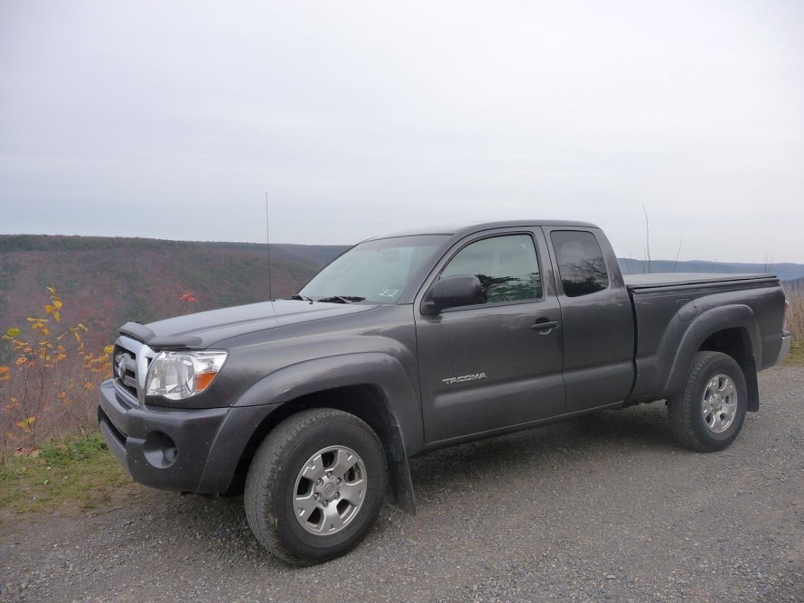

    No experience with installing oem cruise control, but I found a take-off OEM foglight kit and installed in my 2010 4cyl, 5sp, 4x4 SR5 Access Cab. I like having cruise, and didn't realize the 2wd base models came without.
    Only advice, expand your search, look farther north, there are plenty Access cabs in the 2009-2013 age for sale here. They do hold their value though.
