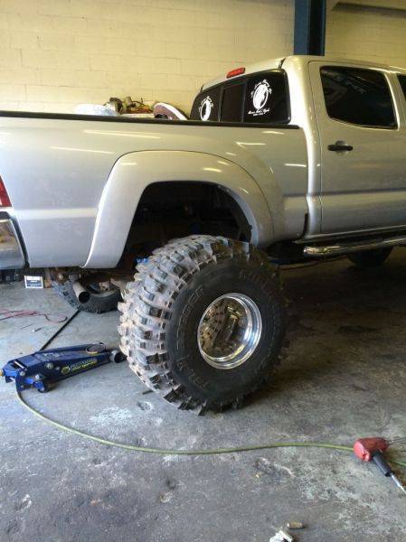

    What's everyone been doing about rubbing the frame while turning? 4.5" bs. Can hardly pull into a parking spot. Gonna throw my spidertrax back on the front to see how it works, worried it'll make them stick out real far.

    Cut mine back until it was good enough to park and turn on right trails

    Seems like most guys on 4.5"BS are putting at least a 1/4" wheel spacer on to get it off the frame.

    With 4.5 BS I recommend BORA .75" Spacers. I would have needed longer studs to do a 1/4" and that wasn't about to happen!

    Where are you rubbing on the frame? Front or bear the cab mount?

    I fit a 1/4" on with my stock studs
    those FN wheels should have a void in the back between the holes. that should give you space for the 3/4" and not have to worry about trimming your studs.

    I rub behind the shock where there's a cross member welded to the frame.
    No not the cab mount. That's why I said frame.
    I'll have to look at the 3/4" bora spacers. I don't think 1/4" would be enough and my studs would be too short.
