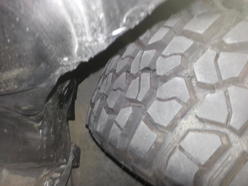

    That's the amount of trimming I did for my 33s. Cutting the pinch weld seems like a good way to get wet feet though; I hit with hammer and flattened.

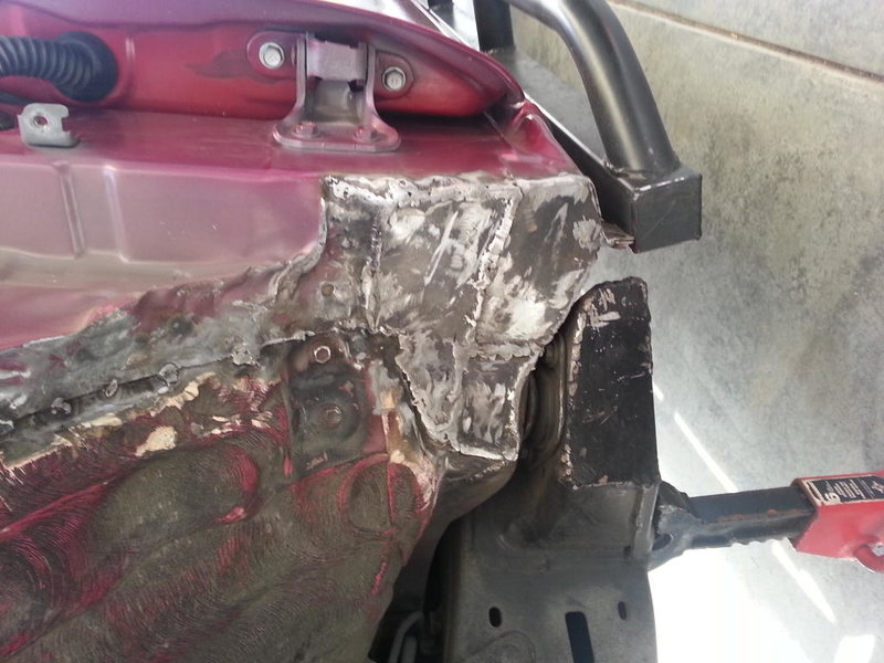

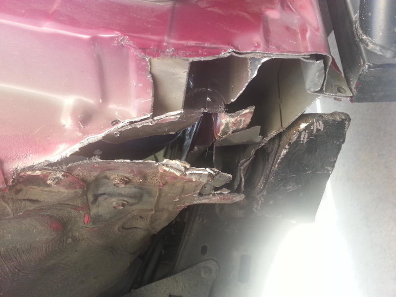

    This is what I did to clear my 31's... ha ha
    If youre gonna go over 33" dont look at it as "whats the least work necessary to fit them. If youre gonna have 1/8" or 1/4" while youre parked youre donna rub while youre driving or wheeling because of the movement of the bushings. Get it way out of the way and you know you are good :)
