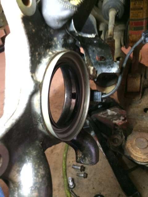

    I wouldn't say the wheel bearing design on the Tacoma is a design flaw, a lot of manufacturers use a wheel bearing module.
    I would say most wheel bearing failures are due to a compromised cv dust seal. that seal keeps all of the outside elements out of the spindle cavity where the bearing is bolted to. Once water, dirt, ect gets in there it will eventually cause the bearing to fail.
    I always recommend replacing the cv seals or at least giving them a good examination.
