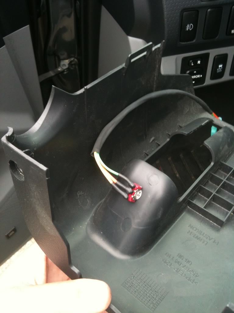

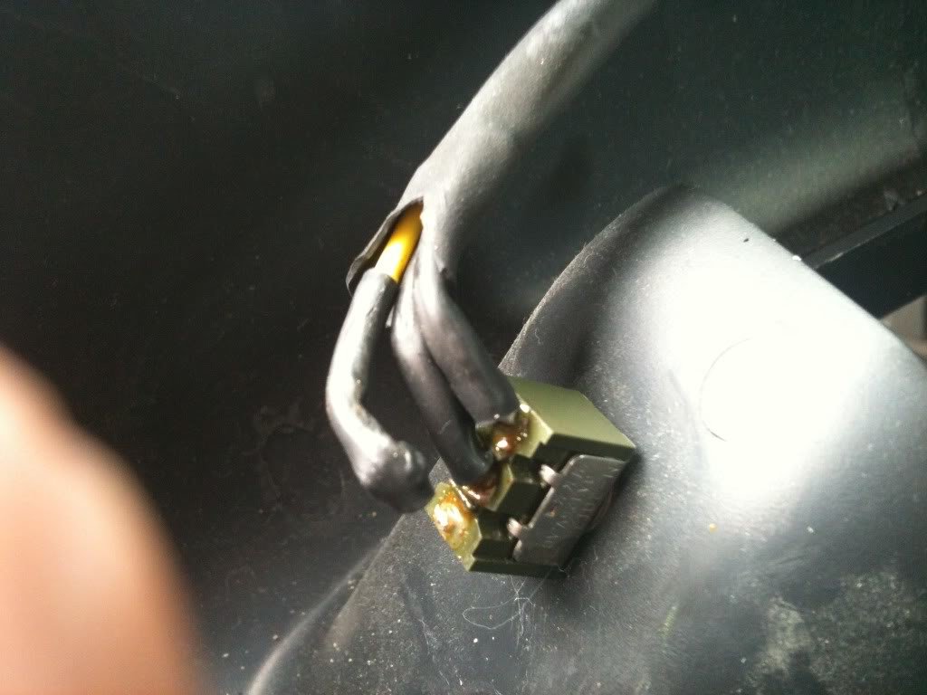

    Alright I pulled out a multimeter and narrowed down the error. Then i removed the steering panel and found this! :mad: Theres a harness (~clock spring) that pressed against the added switch and tore off a tab.
    So...I put a new switch and soldered them @ 90 degrees....
    I guess thats another tip for you guys hah....guess I was one heck of a guinea pig :p

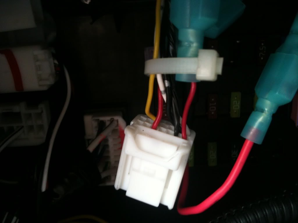

    Oh and here's how my connector looks. The correct one to cut is the red one to the left. I previously cut the red one towards the right which is incorrect.
    Thanks again guys for all your help and suggestions!

    Good to see you found the problem.
    Looking back at the pictures in this thread, I can see how you got confused about which red wire to cut.
    The REV red wire *should* be in the same pin location regardless of different accessories I would think. I wonder if Crom can help confirm this. It's in the same position on yours as mine, but it's a bit tricky to tell on Crom's pics.

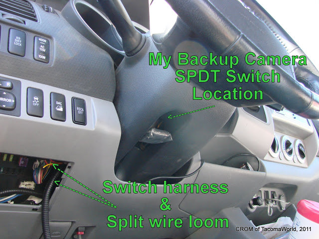

    I finally completed this mod this afternoon after having a hell of a time finding an SPDT switch that fits in place of a dash blank. I'm happy to say I was successful!
    For anyone interested, this is the switch I used: http://search.digikey.com/us/en/products/WR13ATN/WR13ATN-ND/2107124 (it's also available with quick disconnects instead of screw terminals on the back side). Fits great with a couple layers of electrical tape around it; no need to dremmel the socket.
