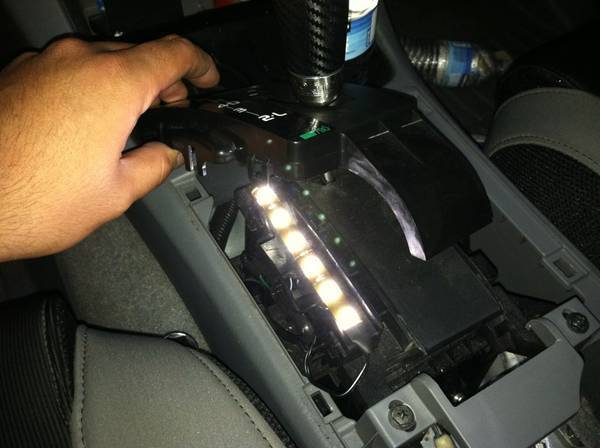

    Ok, so recently a couple of members have brought up questions about changing out that little light located next to our shifters...and a couple want brighter ones than the ones they sell out there.
    So this is what i came up with...

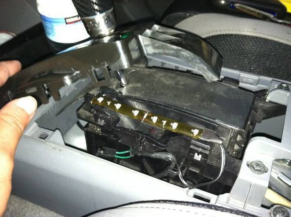

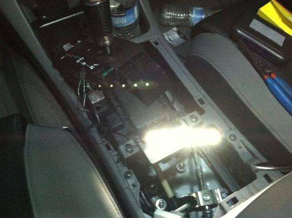

    bought a pack of 2 led strips from pepe boys (around $10-15)

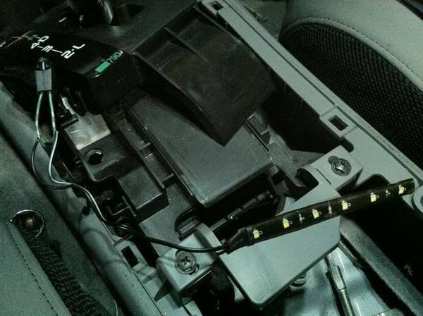

    took my truck apart (everything literally pops off these trucks if you dont already know that :rolleyes:)
    then unhooked the plug to splice into the wires (i threw a bit of solder just to be safe)
    test:
    they come with double sided 3mm tape so sticking is easy..

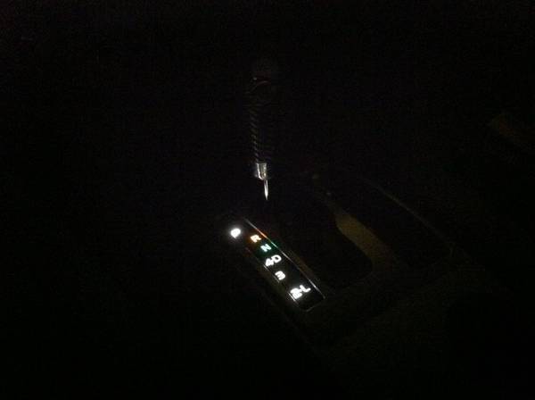

    on
    close up shop:

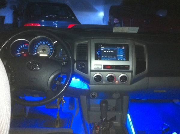

    everything on (or driving at night)
    sorry for the crappy cell pics....i literally just did this mod like 20 mins ago ;)
    these lights are really bright and they are the same ones used for your clusters
    since it comes with 2 strips you can maybe split the cost with another local member...those of you that are local to me, I will be having blue, red and white strips in "stock" with me incase you want it done...all you need to pay for is for one strip which will be like $8ish depending how much the pack cost....goodluck :thumbsup:
    any questions feel free to post on here and ill get back to you asap
