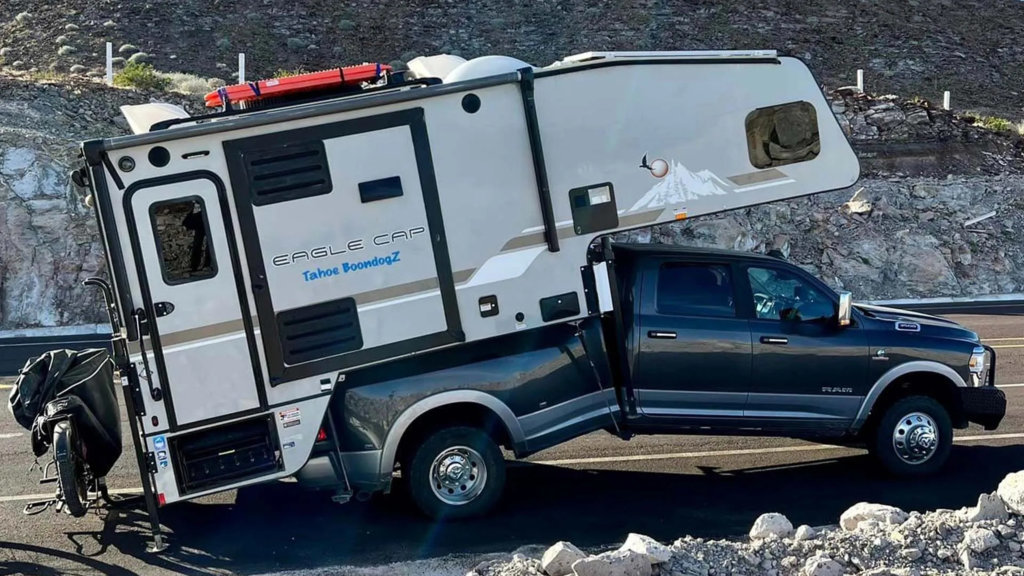

    Payload varies. Some Tacoma's are rated for as little as 900. Most will fall between 1000-1200 and a few could be closer to 1500 but those are rare. The GVWR is the same on all of them. That's the total weight of the truck and everything in it. The heavier the truck is, the less weight it can carry before exceeding GVWR.
    There has probably never been a truck made that wasn't overloaded at some point. A few hundred pounds occasionally is one thing. Putting double what it's rated for in it is dumb. Even 200 lbs overweight consistently will wear out parts prematurely and negatively affect handling. You get the best steering and braking with weight evenly distributed on all 4 wheels. But unloaded trucks have more weight on the front. That way when loaded it evens things out some. You'll end up with a little more weight on the rear axle unless you go crazy it's still OK.
    Grossly overloaded and your front wheels are not firmly in contact with the ground. The front wheels do 100% of the steering and about 70% of the braking. And unless you're using E rated tires you're asking for a tire failure.
    Don't be this guy. If he'd had a gas engine the weight would have pulled his front wheels completely off the ground. The added weight of a diesel engine kept the front end on the ground and broke the frame.
    This guy looked at the specs wrong. A regular cab had enough payload for his camper. But a crew cab did not.
