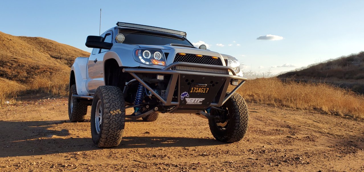

    So I have a full long travel suspension truck on 35's and definitely need bigger breaks up front.
    Any suggestions?

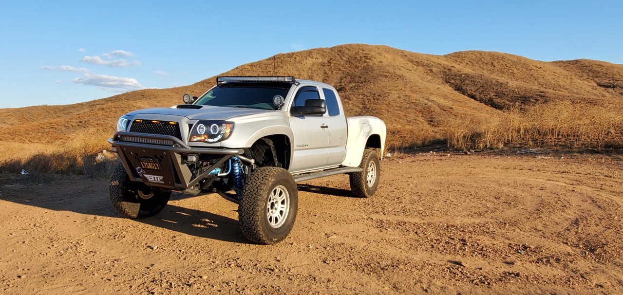

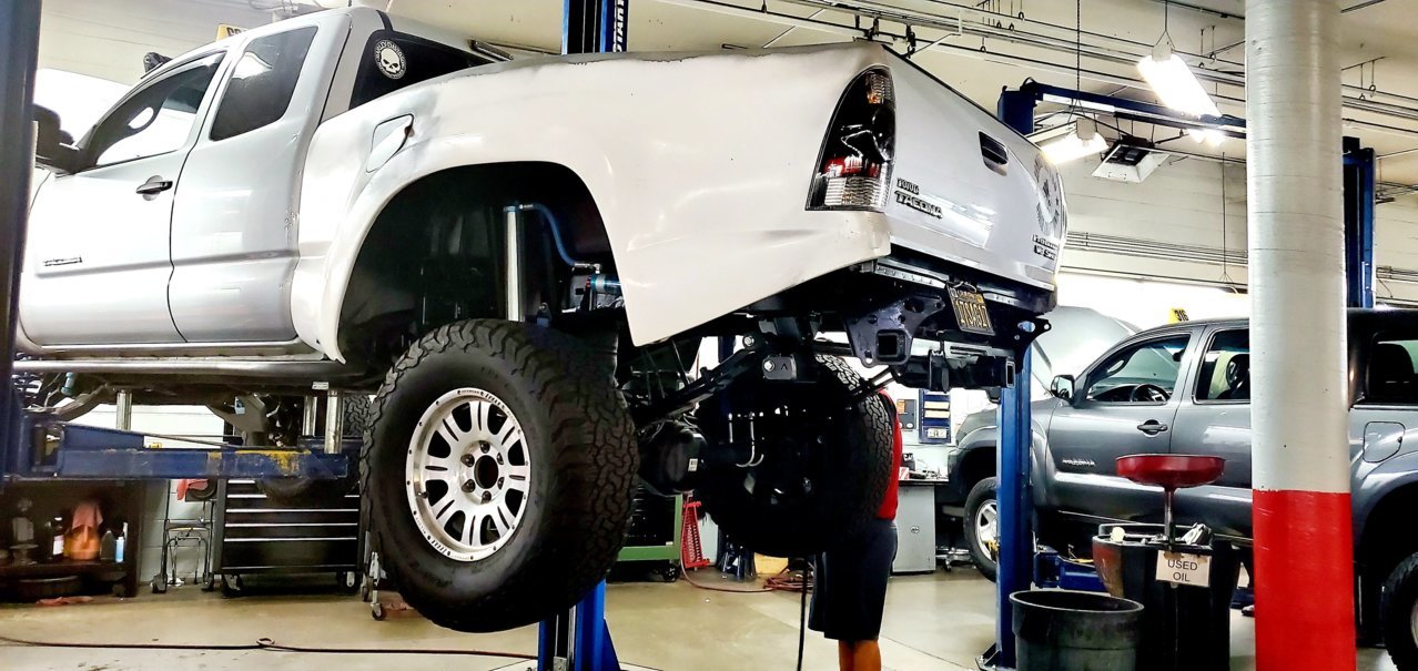

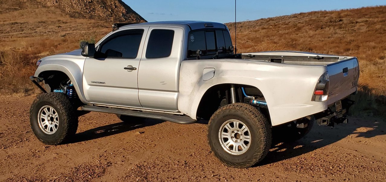

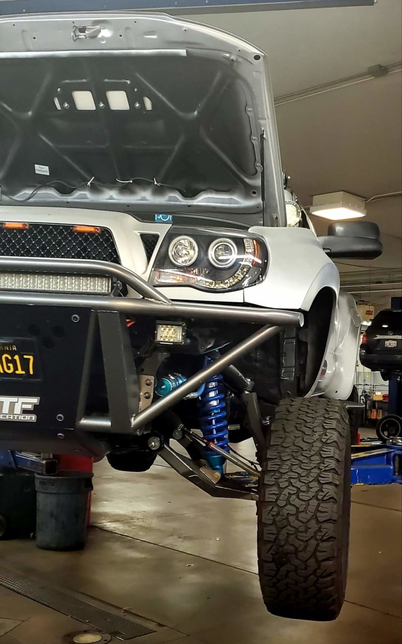

    Took me a minute to figure it out, but oi did post a couple pics.
