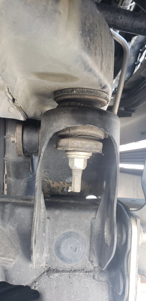

    I have been chasing down same squeaking clunking sound, ball joints were good but saw this radiator support bushing. I will change this next weekend as last weekend I replaced rear main seal. I really hope this is it.

    Went with the solid polyurethane energy suspension, have only done front upper noise is gone up front feels great. Cab mounts will be replaced soon, gonna be a pain in the ass to get to rear bolts
