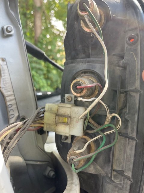

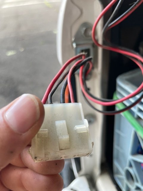

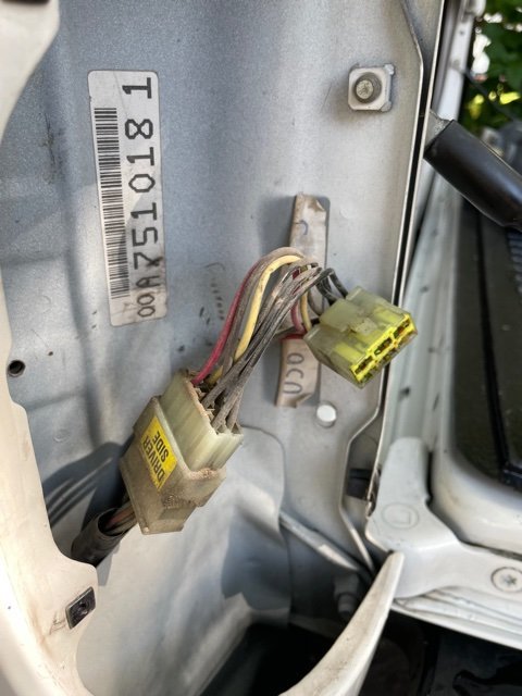

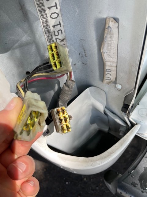

    Sorry to ask, but did the thought about creating a plug-and-play harness for the first gen tail light come to fruition? I read through both the 2nd and 3rd gen threads but couldn't see a place where the 1st gen harness had been created by the wizard(s) behind the other (gorgeous) harnesses. Similar to others, I have a camper shell with a third brake light and am reluctant to start splicing into the connectors behind the tail light if it can be helped. Could take pictures of the 1st gen wiring/connectors if that would be instructive.
    daveeasa likes this.

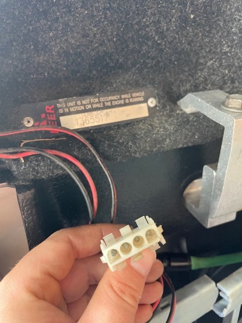

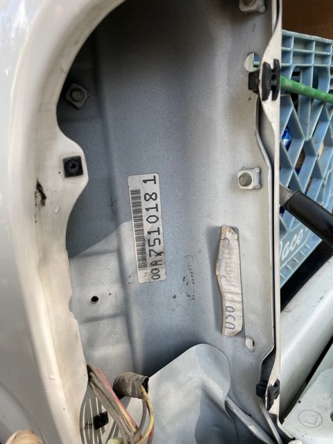

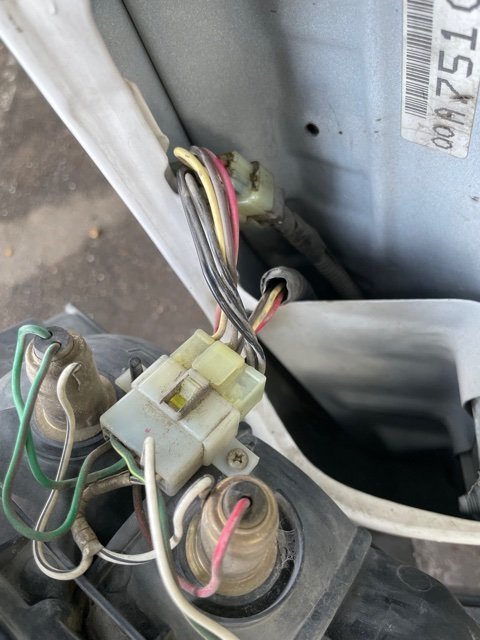

  19. Aug 21, 2021 at 10:01 AM
    #119
    scofflaw
    scofflaw Well-Known Member
    Aug 18, 2018
    #263278
    216
    Thought it would be helpful to also provide pictures of the various plugs down in the back of the tail light assembly. I'm fairly lost in terms of what goes where or how you would build a plug in that would allow for a connection out to the third brake light. The last two pictures are of the connector that comes down from the shell and connects to not only the third brake light but also three dome lights with switches (less concerned about those working since I have a headlamp etc.)
    There is a harness sold on eBay (link) and also one that looks pretty comprehensive on another store (link). The second link appears to be for a trailer wiring harness, which I already have up under the rear bumper, but maybe some of the parts overlap. Would be grateful for any guidance or links to how others have done it cleanly (whenever time allows of course).
  20. Aug 21, 2021 at 10:40 AM
    #120
    Puppypunter
    Puppypunter [OP] Well-Known Member
    Jan 4, 2020
    #315086
    2,737
    Johnny
    2019 Black SR
    Ok, this is doable. That looks like a Sumitomo 250 armlock connector.
    https://www.corsa-technic.com/item_images/250ARM-6S.jpg
    I have some terminals for that (Subaru’s use them too, the will be my first foray into the 1st Gen world), but will need to get some housings. If you are willing to get me a full pin out of it, I will make you one for your time :) also, am I mistaken in looking at that first picture, there is a small female to female (the gender on plugs is from the terminal, not the housing. The housing most people would call a male)? Is that on both sides? That would be an ideal spot to replicate if so. I could build a female to female, and just add the taps on one side of it.
