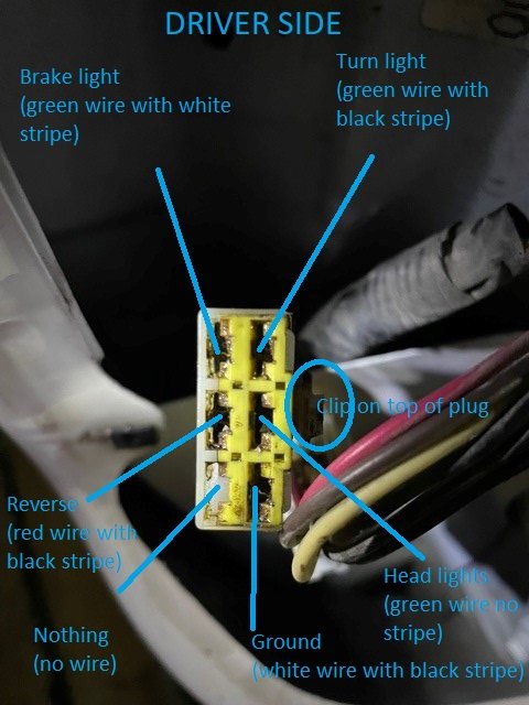

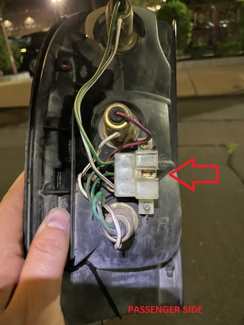

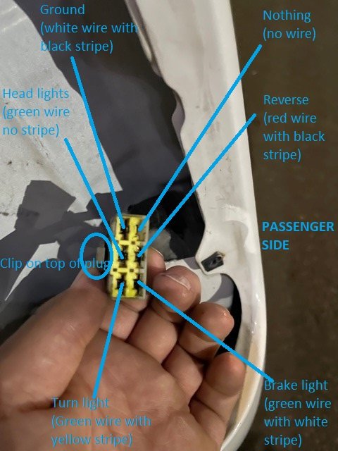

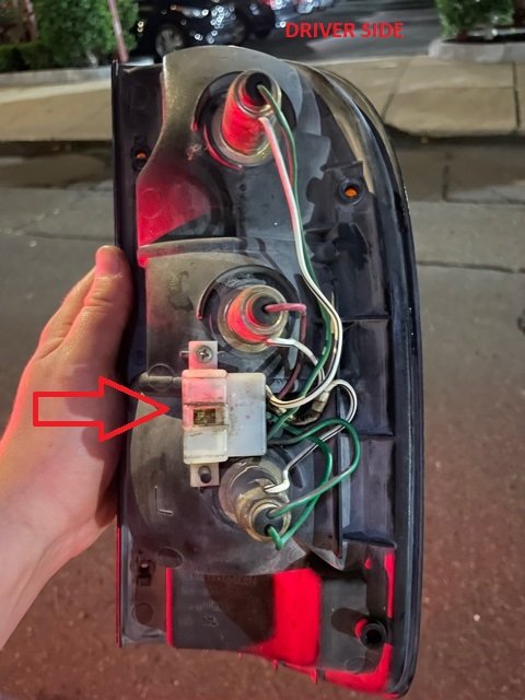

    Forgive the delay, but I have charted out both the driver and passenger side plugs using the test light. Pretty fun honestly.
    The turn signal lights were by far the most fun to find: ezgif.com-gif-maker.gif

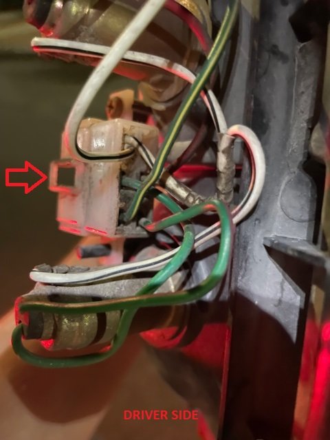

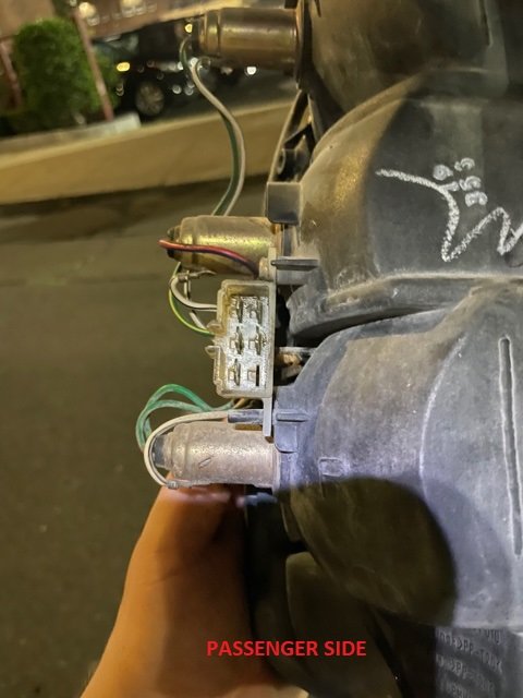

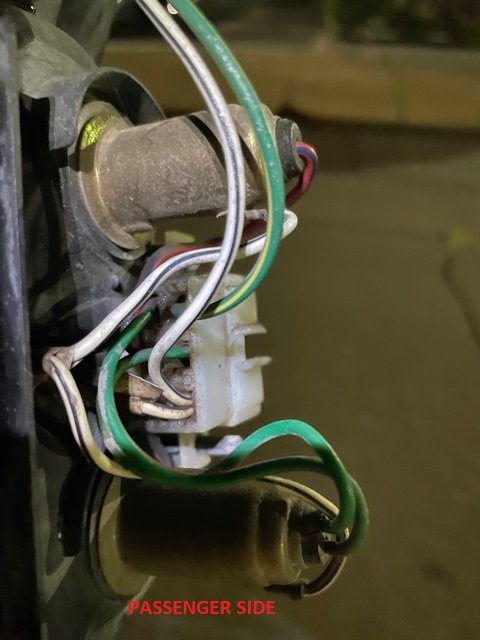

    Here are close-ups of the tail light assembly, including the lens and bulbs and wires that feed into the male plug that attaches to the female plugs pictured above.
    Starting with the driver side (left)
    And then the passenger side (right)
    If any of the pictures should be from a different angle or better resolution or light or just somehow improved, please let me know and I can re-take them (or take pictures of any other part/angle in the tail light assembly/plug/harness).

    Not sure if the pictures came through correctly in the post above so attaching them in-line here as well in case helpful.

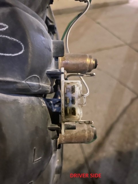

    I realized that you may have wanted pictures of the back side of the female plug with wire annotations, so those are below. Along with the way that I managed to keep the brake light on without a helper.
