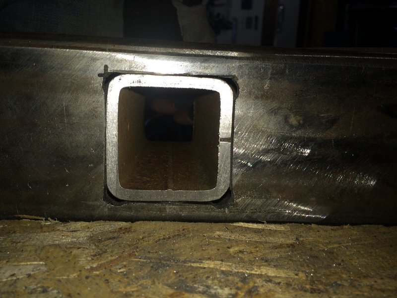

    I forgot to post this pic up yesterday it just shows how I slightly undersized the hole so I could file it to a tight fit. The holes I drilled will still be a little loose but I can fill that no problem.image.jpg

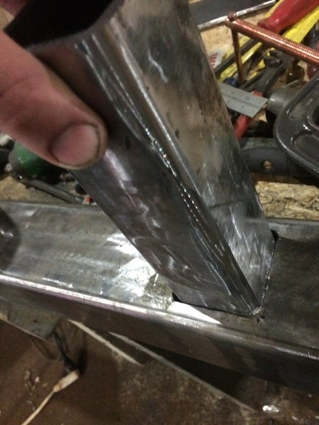

    Hand filed to a nice fit.
    Shouldn't be a problem filling in the corners.image.jpga view from a different angle to give you an idea of how it will look when it's finished.

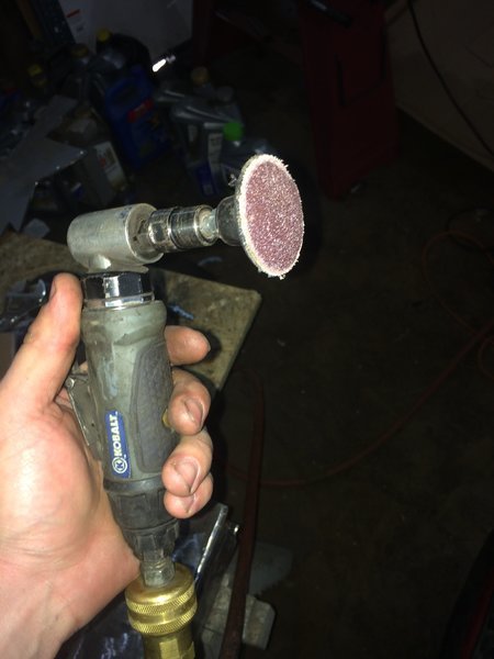

  8. Nov 11, 2016 at 8:03 AM
    #248
    GsxRtaco
    GsxRtaco [OP] Well-Known Member
    Mar 26, 2013
    #100653
    309
    Tony
    Wisconsin
    08

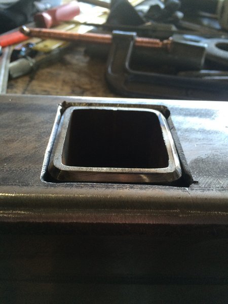

    Used this for getting the holes in the ball park.image.jpgworks well at knocking down bigger areas, but the hand file is where it's at for getting the edges straight.
    ChadsPride likes this.

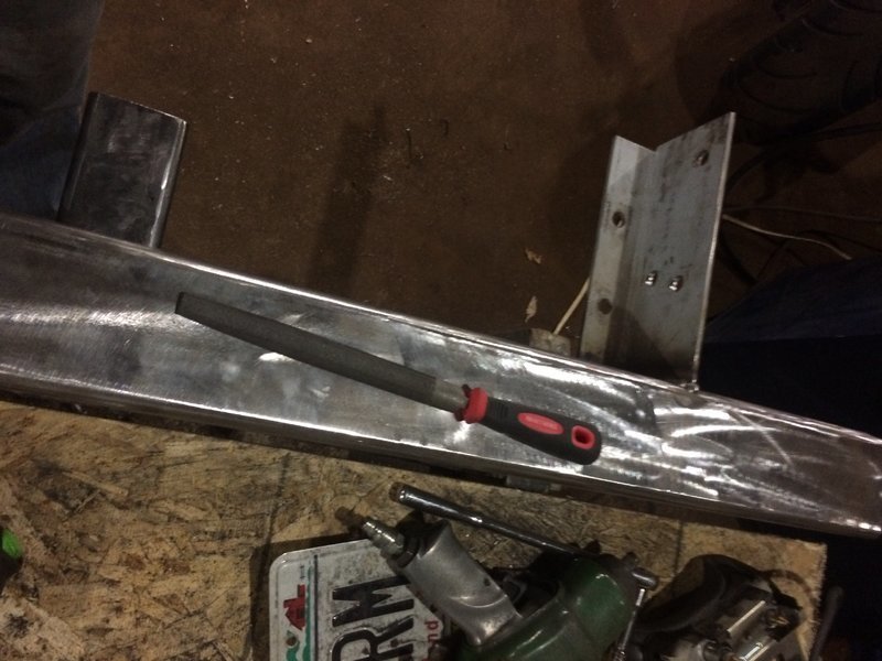

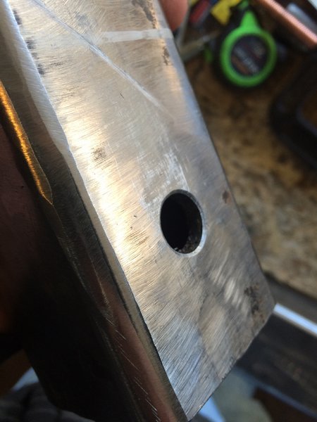

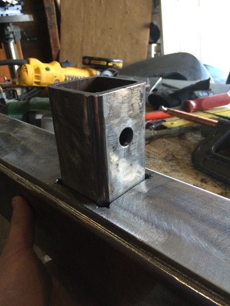

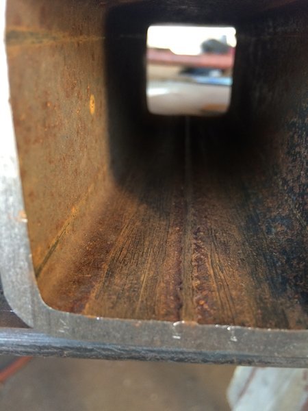

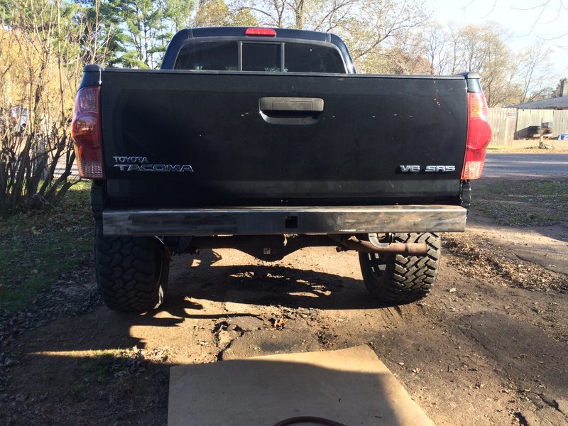

    Putting in some work on the hidden reciever this morning.

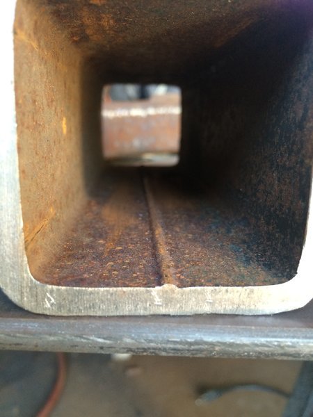

    First thing on the list was flattening out the weld seam a little bit so that a 2" square tube will slide into it.
    Before:image.jpgAnd after:image.jpgI just used a long flat hand file to knock it down a bit, fits nicely now.image.jpg
    Next on the list: drilling the hole.
    I ended up using a 5/8 drill bit. I'm not sure what size the hole usually is but 5/8 was the next size under that I have so if it's too tight I can go back later and make it s little bigger. I think it will work though.image.jpgi chamfered the edges with a 3/4" for easier pin starting, and to clean up the look a little bit.
    I placed the center of the pin 2" behind the bumper which should give me plenty of room to work with putting pins in and out.image.jpg Then I peeped the edges for welding.image.jpgsll set in place and ready to burn.image.jpgmore to come, I'll be working on it for a few more hours today.
    eccracer104 and ChadsPride like this.
  20. Nov 14, 2016 at 11:20 AM
    #260
    GsxRtaco
    Mar 26, 2013
    #100653
    309
    Tony
    Wisconsin
    08

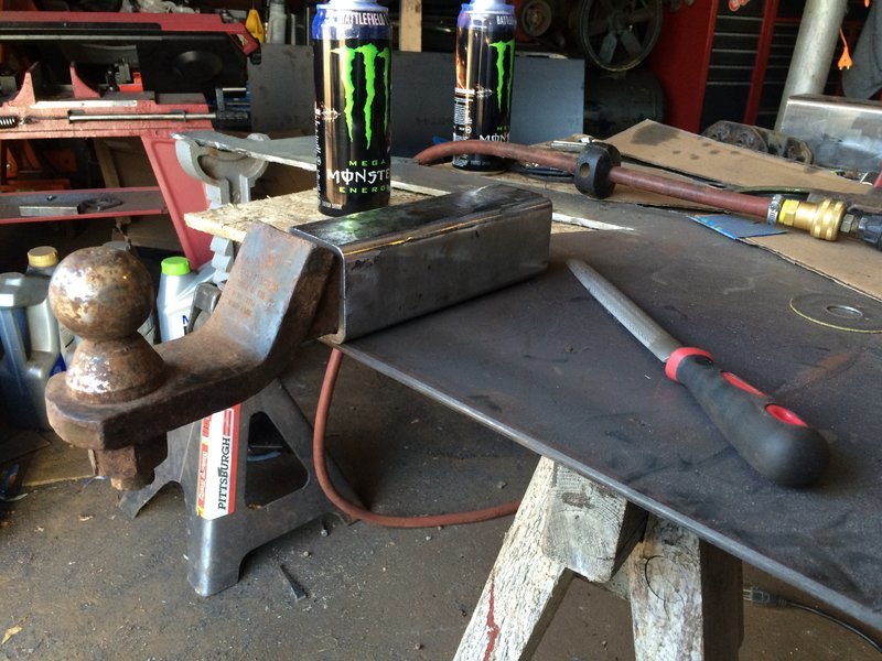

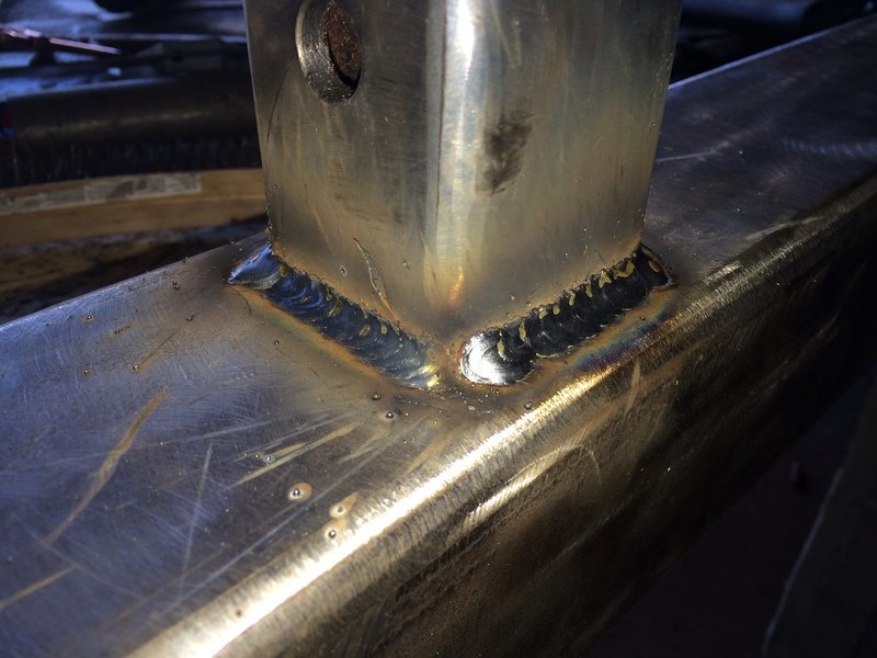

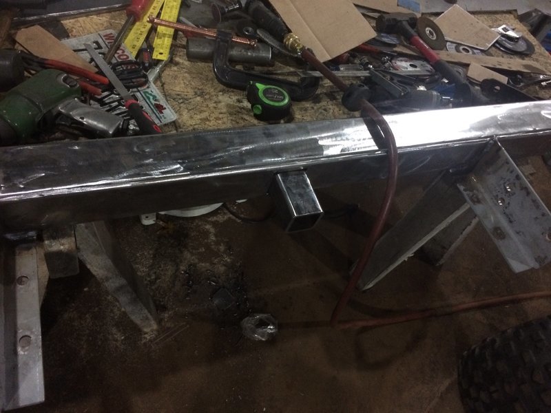

    NSome ugly welds but they will hold.image.jpgThe front welded and ground smooth.image.jpgsitting in the truck.image.jpgnow I'm cleaning up all the side pieces so they can be tacked in place. Removing mill scale is a pita but it is well worth the effort and time to have much nicer welds.
