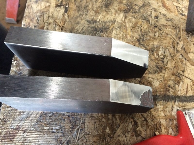

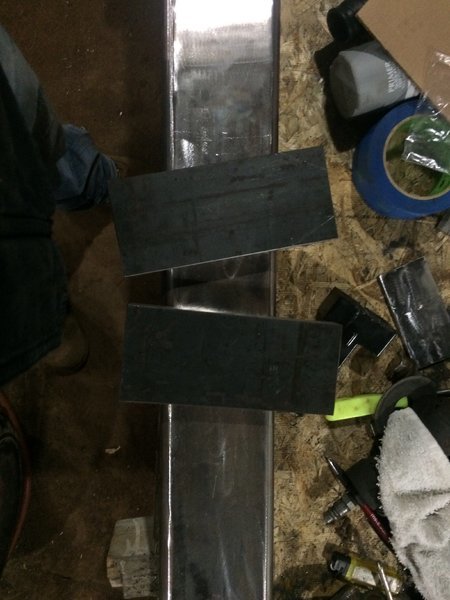

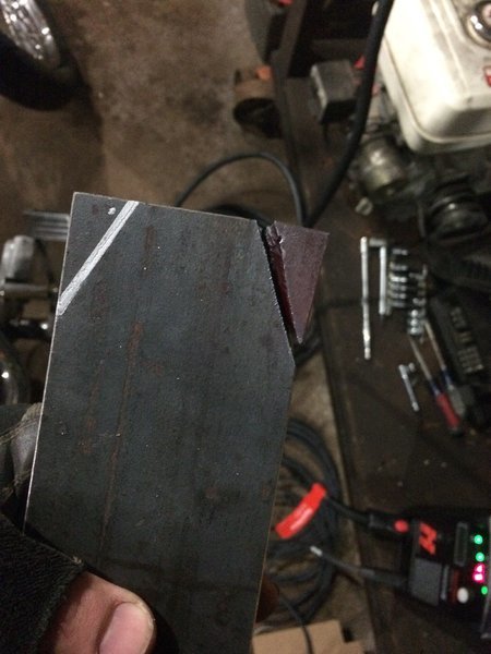

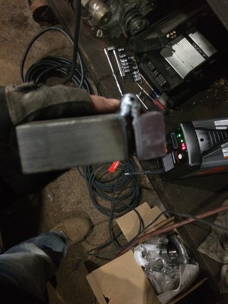

    image.jpg Okay finally made a little progress this morning, didn't get as far as I was hoping but at least it's moving in the right direction.
    Started out by cutting out some 3"x7" blocks out of s piece of 1" thick flat stock.
    Next it set my harbor freight band saw up in the vertical position. I started to make the first cut but got very impatient and decided I wanted to test out my new plasma cutter instead.
    The plasma cutter is rated to cut 5/8" and sever up to 1-1/8" so I wasn't expecting too much but figured it was worth a shot.
    image.jpgIt cut all the way through, but slag held the severed piece on to the main block.
    A little knock from the other block and it comes off nicely.
    Next I brought all the pieces over to the disc sander to start cleaning them up.
    I didn't clean them all the way to the tip because I'm going to end up shortening the ends any way and it is a very time consuming process.

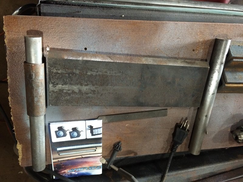

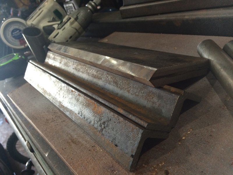

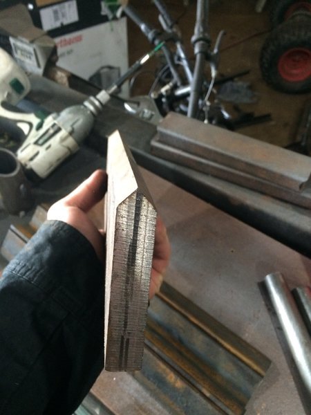

    And here's a sneak peek at a side project I've been slowly putting together. It is going to be a small press break for bending brackets an other short pieces.
    The angle iron will be the bottom die the large piece of steel will be the top die and a piece of tubing will be welded to the top die, which will slide on 1" round stock for alignment. Still need to make more pieces it's just a very slow work in progress that do when I get bored once in a while.
