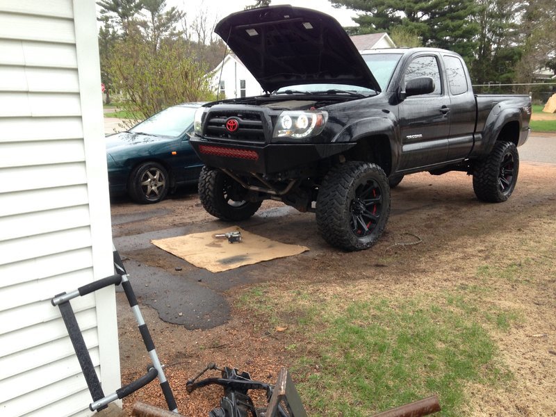

    image.jpg Finally got around to starting to build a skid plate sorry about the camera angle don't have the mounts finished yet so I had the wife snap a quick pic so I could see how it was looking. For the mounts I bent up a piece of 1-3/4" Dom tubing that will have plate welded to the bottom with holes that bolt into the sway bar mount location... I removed my sway bar about a year ago and there's no way I'll be putting that pos back on, rides and flexes a million times better without it. Still deciding on how I'm going to mount the top.

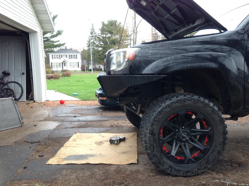

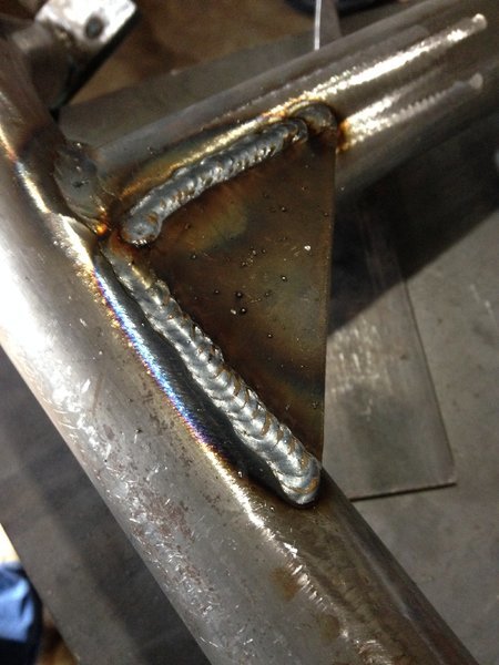

    Thanks guys it's a slow work in progress.... I have a Miller 211 welder @jackkpecoraa18. This whole bumper has been welded on 110v though because I bought a new house and still need to run 230v to the garage. image.jpgHere's what I came up with for a skid plate mount it is really solid.image.jpghere you can see the approach angle.image.jpgthis is just an example of the weld you can get on 110v this is one of the bottom mounts for the skid still needs holes and mounting hardware.image.jpghere is where it sits right now. As you can see I had to torch the holes out a little bit to get it to fit how I wanted it. I'm thinking when I'm done I'll paint the tubing red and the skid black.
