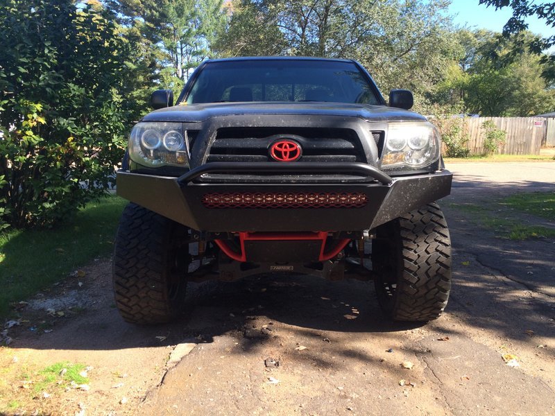

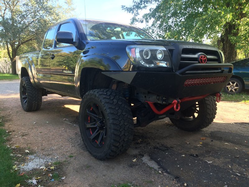

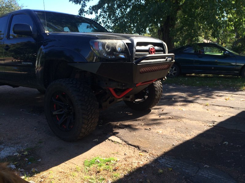

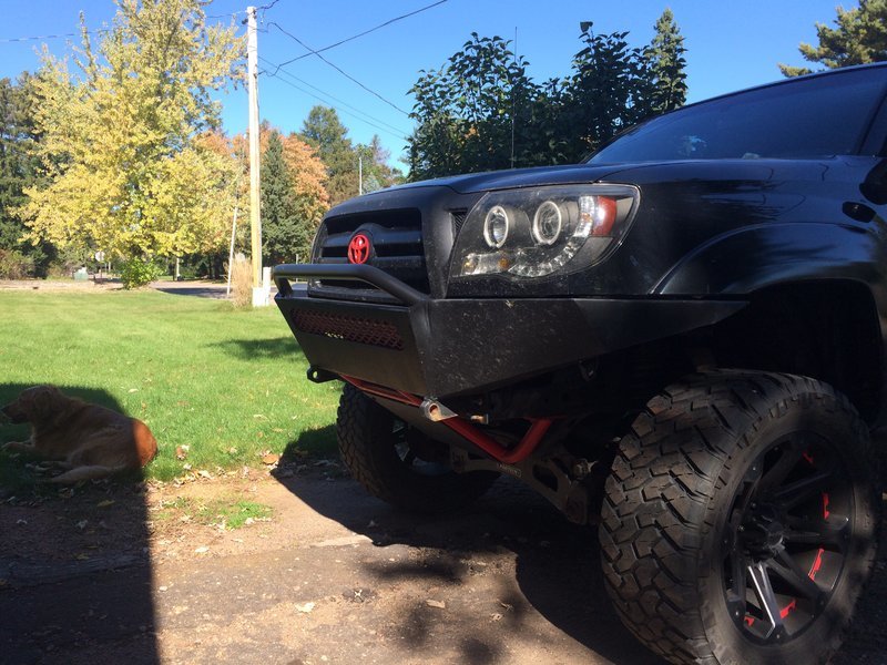

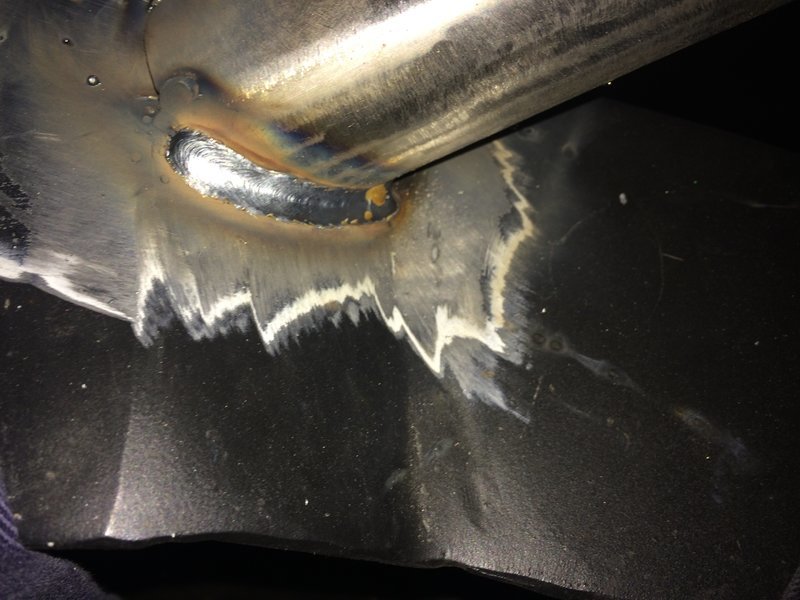

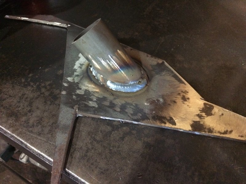

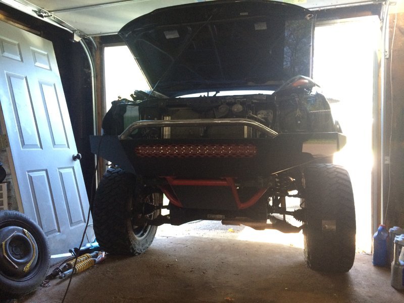

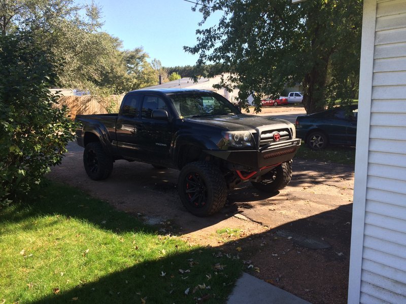

    Did a little more fitting on the tube this morning and decided it was good enough to weld on. So I took some scrap and set the welder up.image.jpg
    followed by tacking the bumper on image.jpgwhich was kinda a pain to balance just right with out a helper but managed.
    It didn't go too horribly the bottom angles were fairly tricky to weld up without removing the bumper but I didn't feel like ripping it off just for that.
    And paint

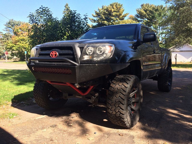

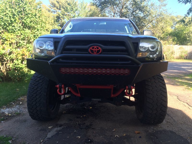

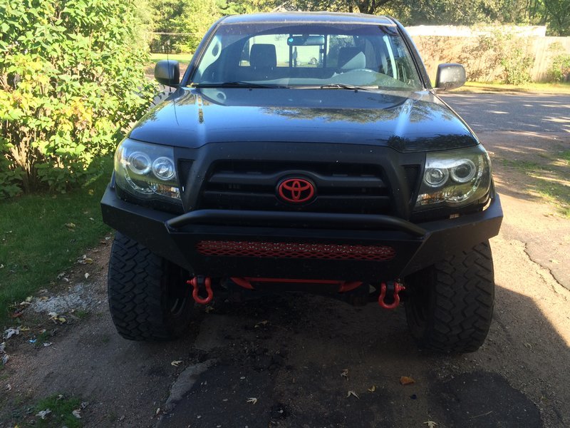

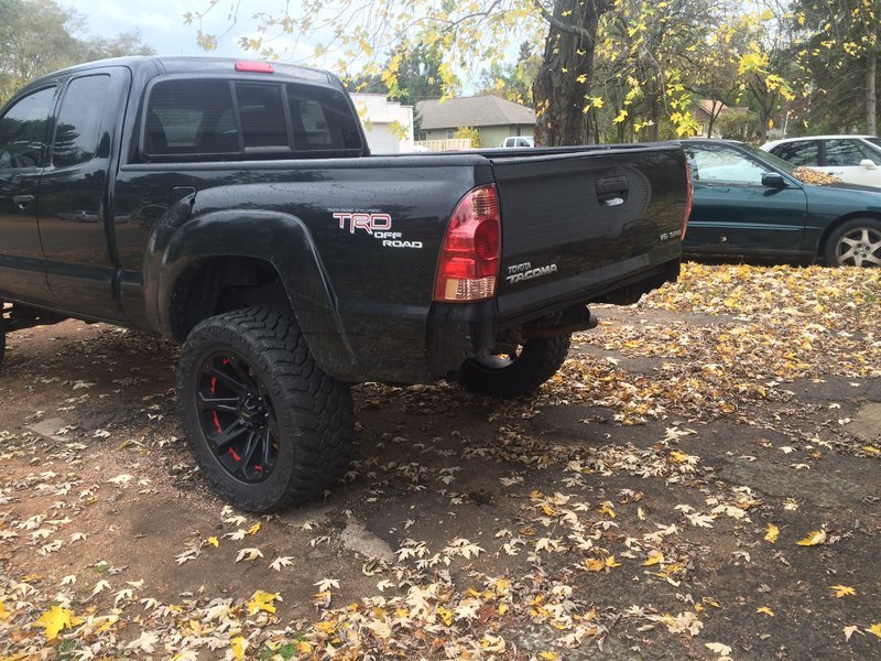

    And finally I put everything back together and backed it out into the drive way for a better look at it.
    I'm happy with the results. I decided against another light bar at this time. The nice thing about spray paint is it's easy to add more later.

    image.jpg image.jpg image.jpg Just because it looks better with the clevises in.

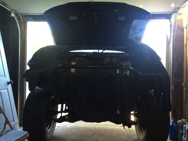

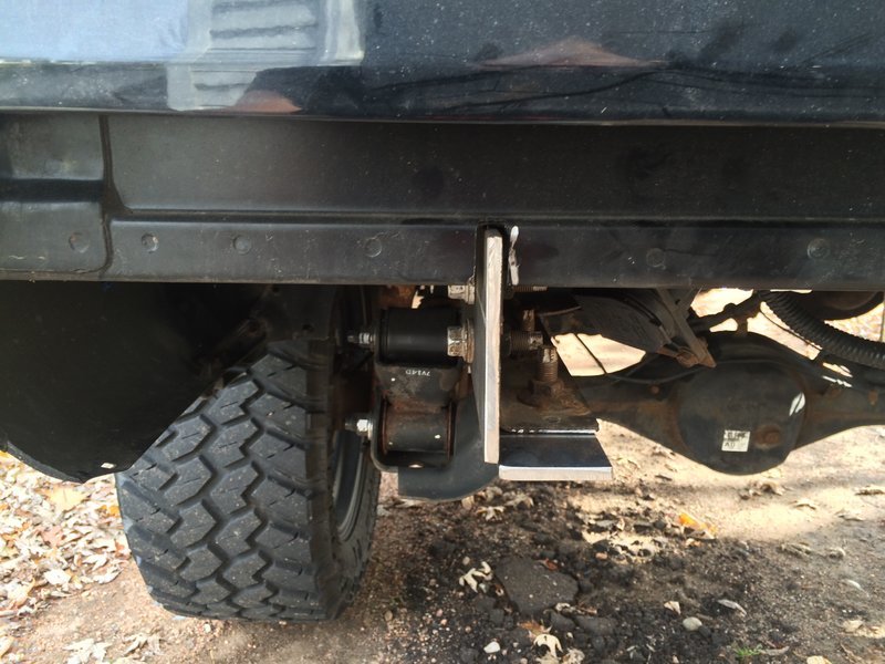

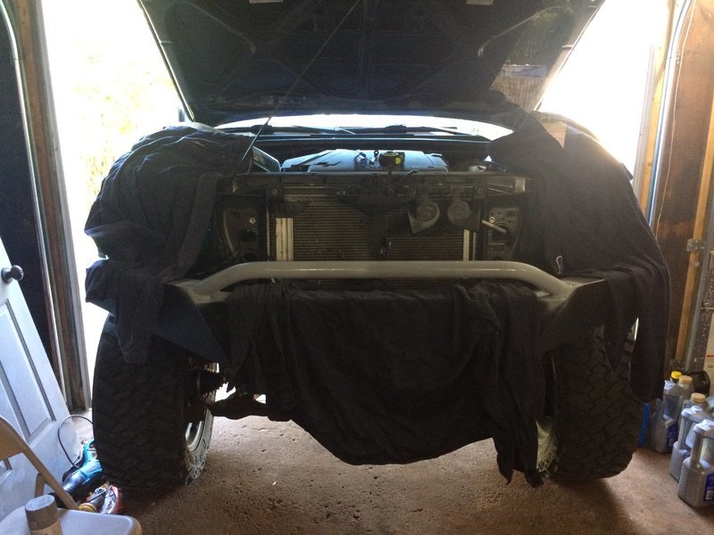

    And so it begins again......
    image.jpg image.jpgI think it looks better already just removing the fugly chrome bumper.

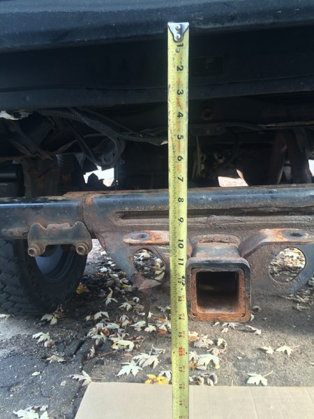

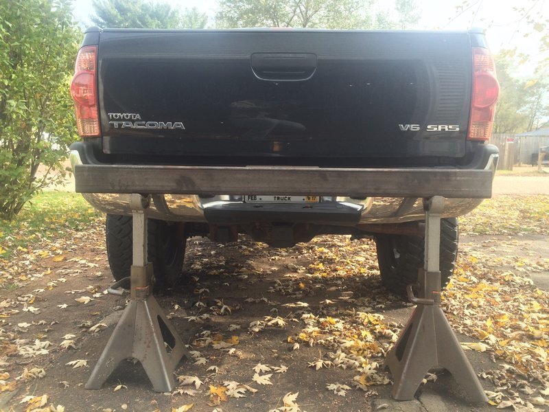

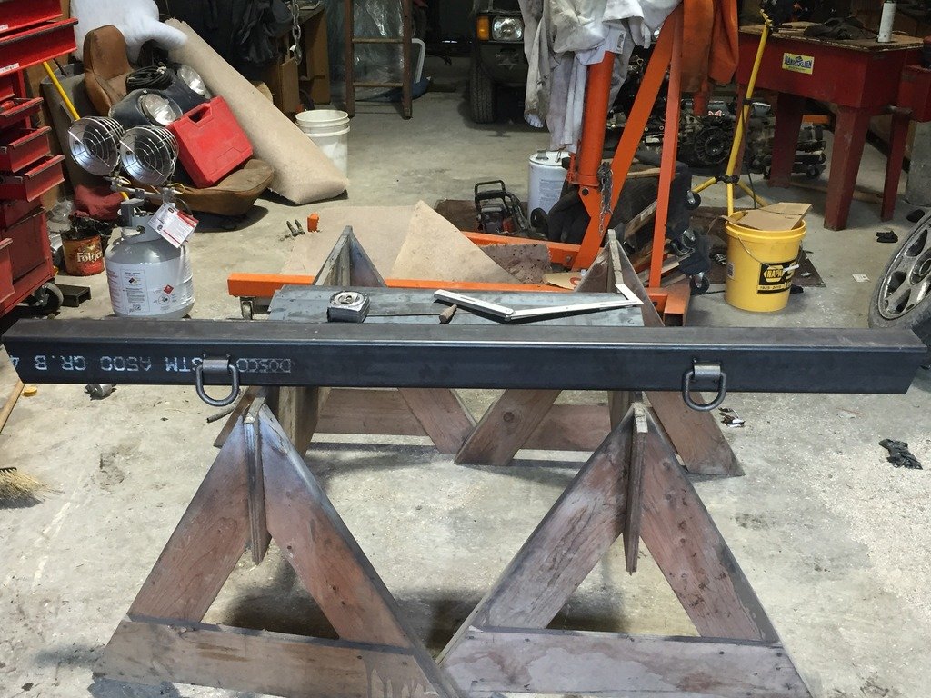

    Just to put the clearance difference in perspective the bottom of stock receiver sits about 14" below the bottom of the tail gate. image.jpgThe piece of tubing that will be sitting beneath the tail gate is 4"x4"x 1/4" and we will say maybe a 1/2" gap above it for body flex.... So just with those numbers were gaining 9 1/2" of clearance in the center. I forgot my die grinder with cut-off attachment at work so I'll have to wait on cutting the bed sides off, maybe tomorrow. If I have time this morning I'm going to try making mounting brackets for the main "beam"

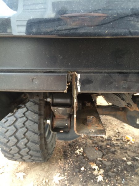

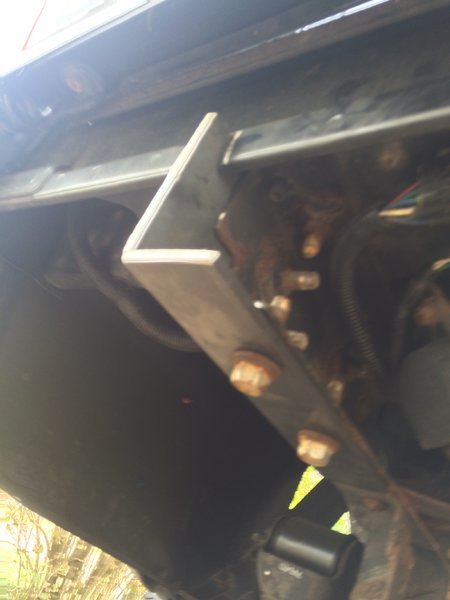

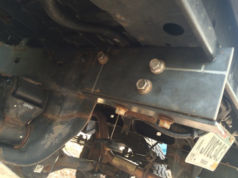

    Made some time to work on the bumper mounts this morning.
    The first thing I had to do was make a notch in the back pinch weld for the mounting bracket to go through.image.jpganother option would be tapering the mount down below the pinch weld but this way will be stronger.

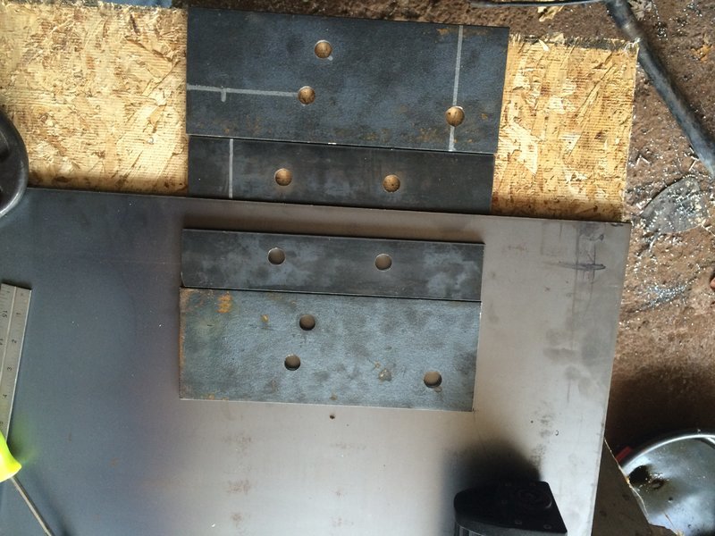

    Next I measured the holes about a million times, laid them out on my steel, and drilled them out.image.jpgthen came test fitting
    image.jpg image.jpgNot too bad... I think it will be extremely solid. Tomorrow I will try to get them welded together, and if I have time test for the back tube against it. image.jpg

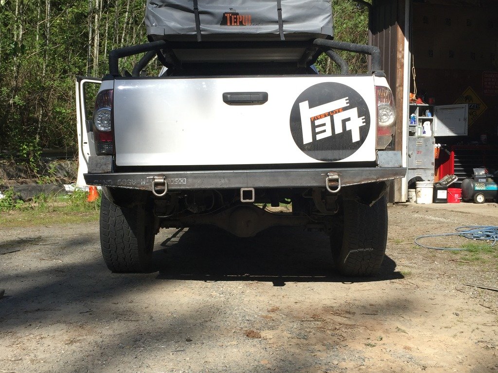

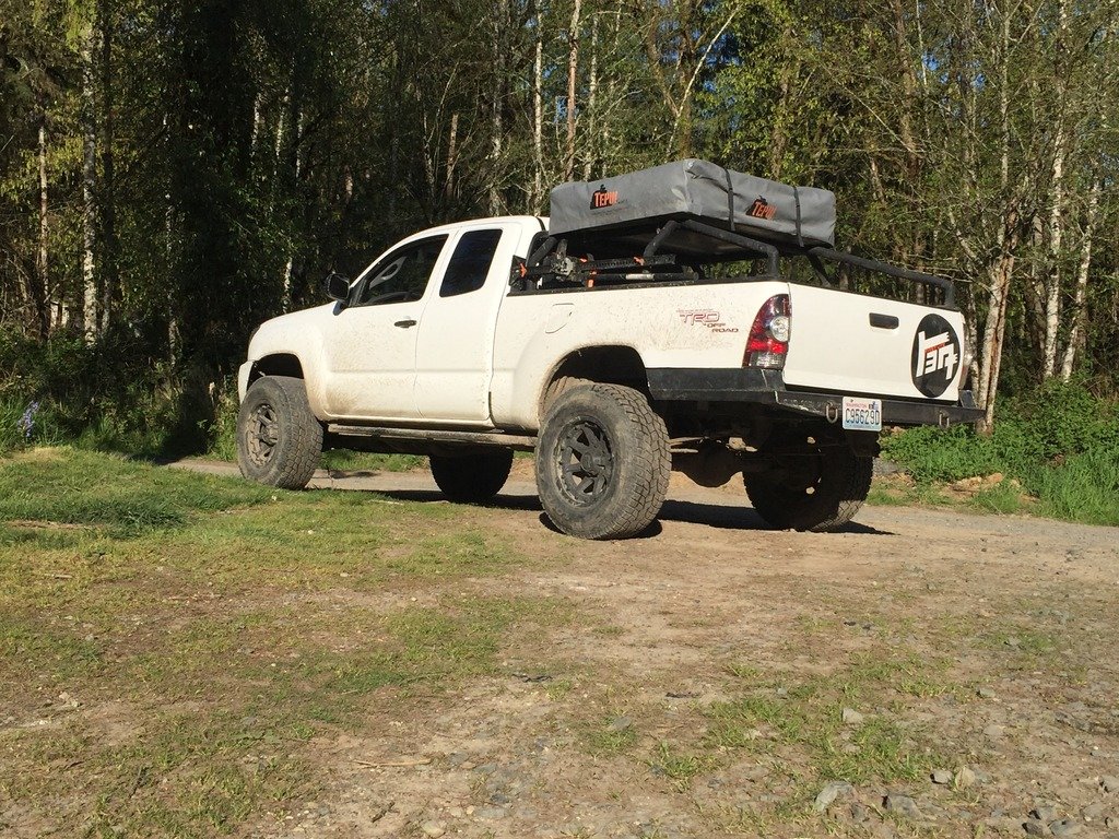

    DIY HC rears are best rears
    FF611C1A-639C-4FE7-B036-D9DC03522799_zps_d104f1d1377323c600897b258be93b0d77daf37d.jpg
    B94862AF-9AFE-4FD3-9636-5E6FE9B37228_zps_b6c23948b55ebfc7d7828e297784b85412816279.jpg
    3A0BFCEA-553C-408B-A1E9-6193D981BD19_zps_b8437cc5782660d4e001ac38f27db83bd339caa0.jpg

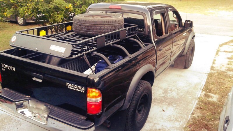

  17. Nov 2, 2016 at 1:03 PM

    Nice work, looks great, but I hope you aren't using those rings for recover purposes.
    GsxRtaco[OP] and ChadsPride like this.

    I like your bed rack, can you post a few pics of how it mounts on? Thanks.
