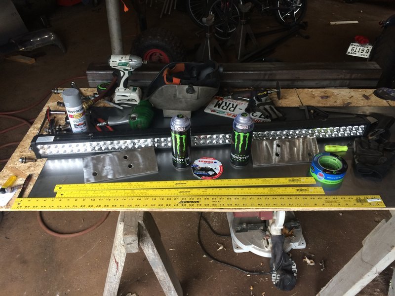

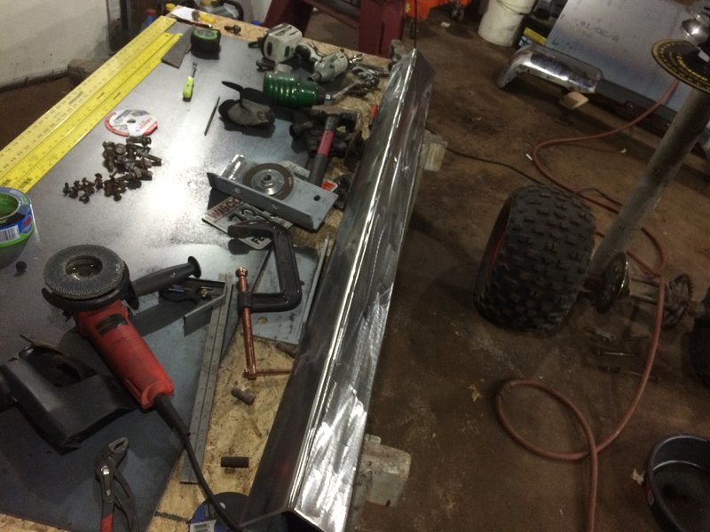

    Stopped and bought some suplys this morning.
    image.jpg I'm pretty much fueled by Monster energy drinks lol. I probably spend $50-100 a week on them.
    Primed the mounts for rust protection.

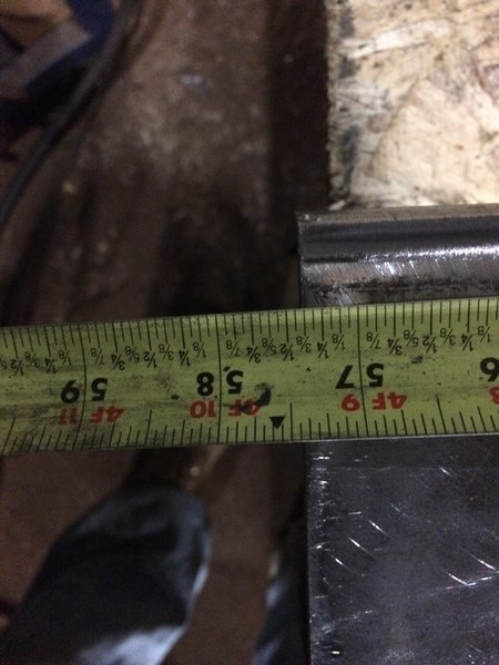

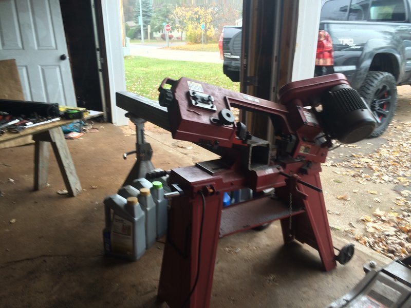

    image.jpgAnd now I'm cutting the back tube to 57 3/8" long. image.jpg
    It's been ten minutes... This may take awhile. I will try to update again before I go to work.

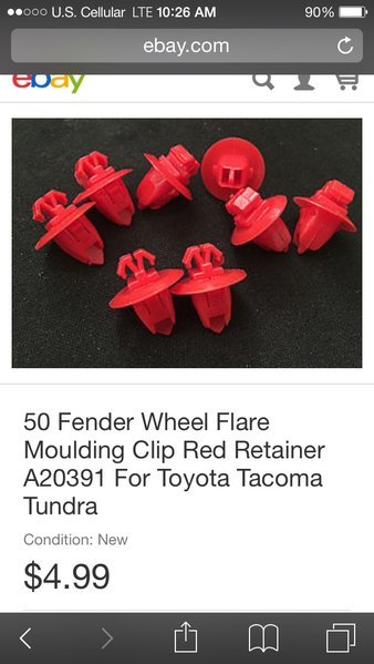

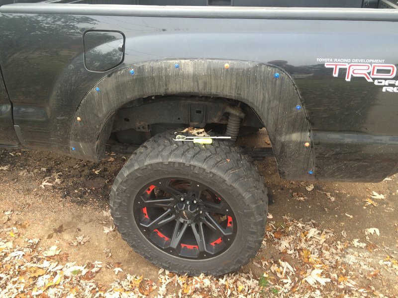

    After trying to get these off nicely for a few minutes I got sick of it and looked up how much replacements are online. $5 for 50. Not worth my time lol I broke every one and orderd a pack of new clips.

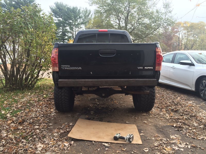

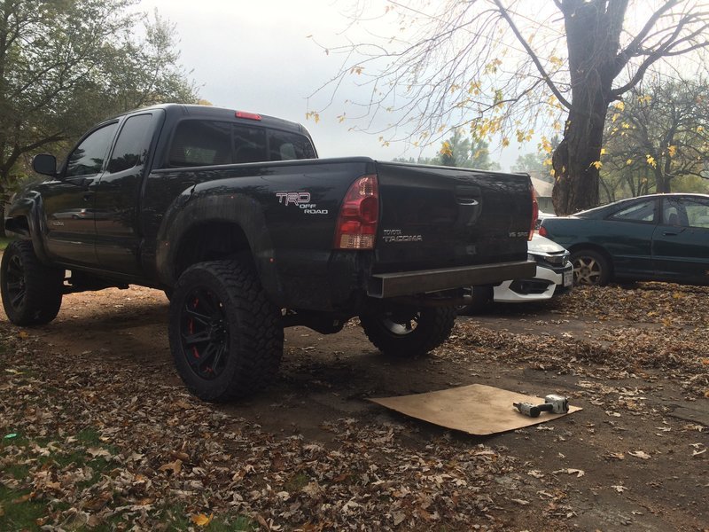

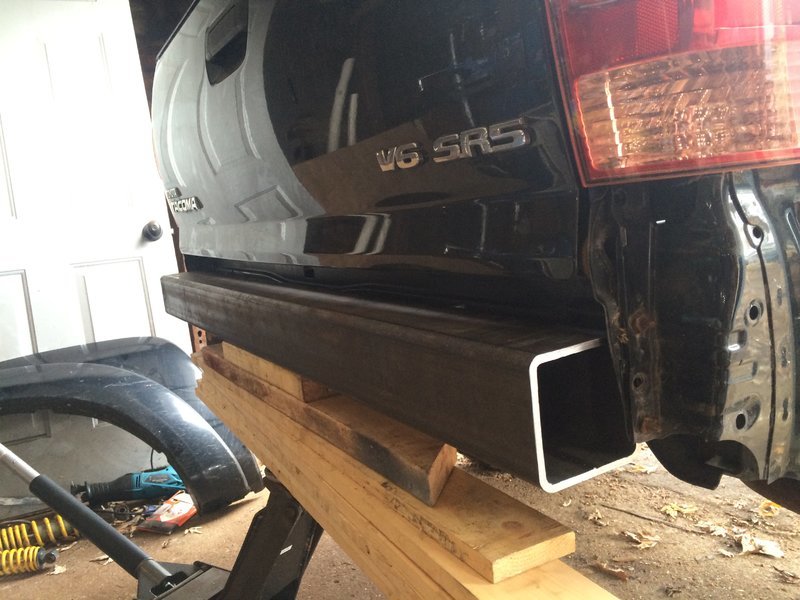

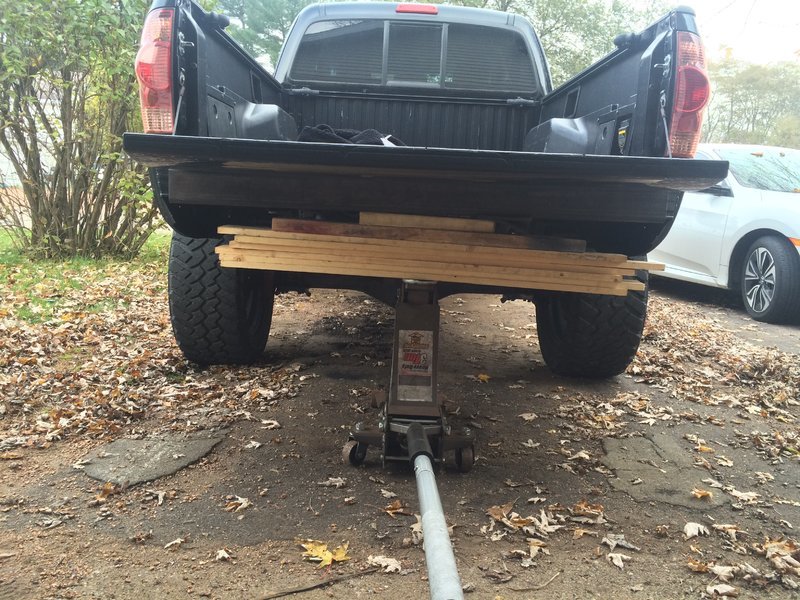

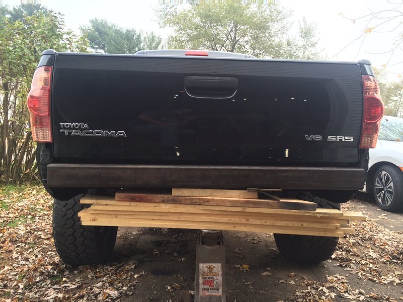

    Well I got the rear tube tacked on to the mounting brackets. Don't have time to weld them up today but at least I got it hung.
    Checking tail gate clearance.
    Side view...
    And holding its self...
    BlackPearl1 and ChadsPride like this.

    The gap between the tail gate and bumper had to be larger than I originally thought. I want to make sure I won't be wrecking my tail gate when I open it.

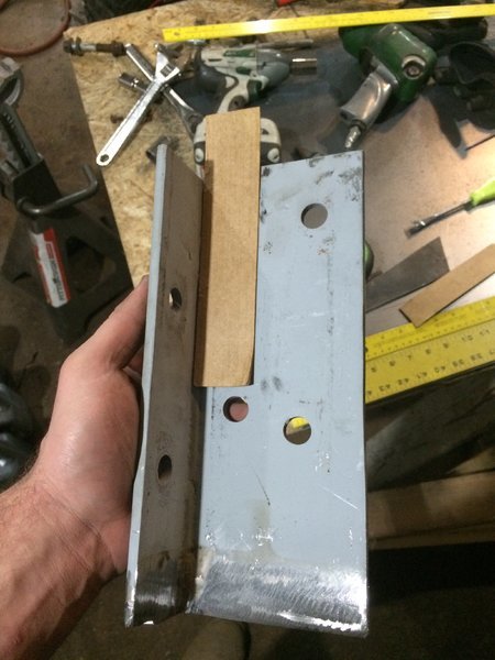

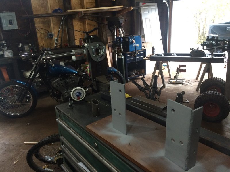

    Installed highly sophisticated shims behind mounts:
    Also had a small one in front of the two holes but it didn't make the pic.
    ChadsPride likes this.

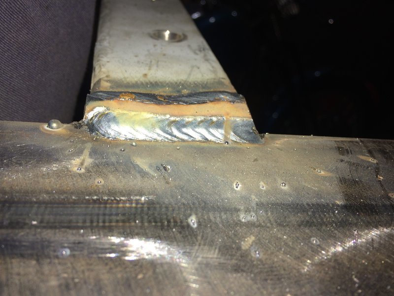

    Any ways welded everything solid.
    Made a mistake on the length of the bottom flat stock so I recycled the tabs I cut out of the tube earlier
    image.jpg Good as new. Triple passed the inside for strength. Just waiting for everything to cool off for a test fit.

    Just for reference double the shims. It fits but it's pretty tight.

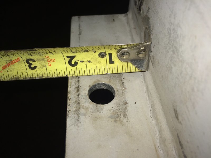

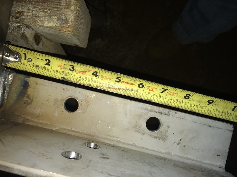

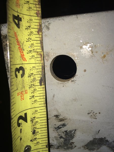

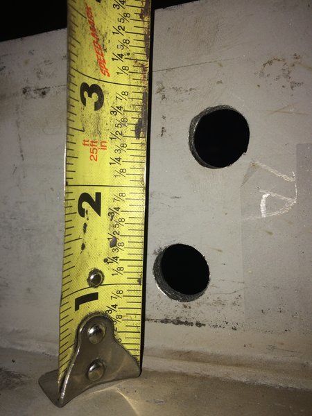

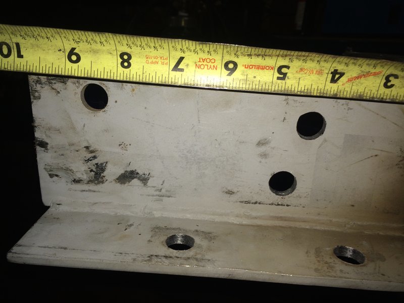

    Side holes
