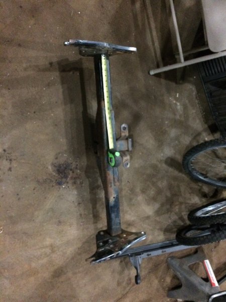

    Sorry about crappy phone pics it's the best I've got.

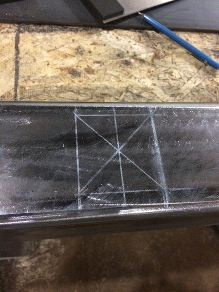

    Drew up the hole for my receiver.

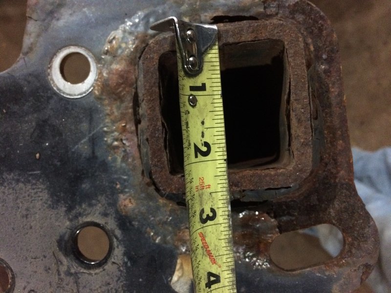

    image.jpgThen started thinking about where I was going to find a 2 1/2" x 1/4" square tube.... Well looks like I'm recycling again.
    image.jpg The side tube is the same size as the receiver so that will work out well.

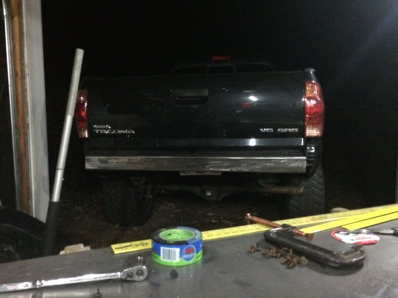

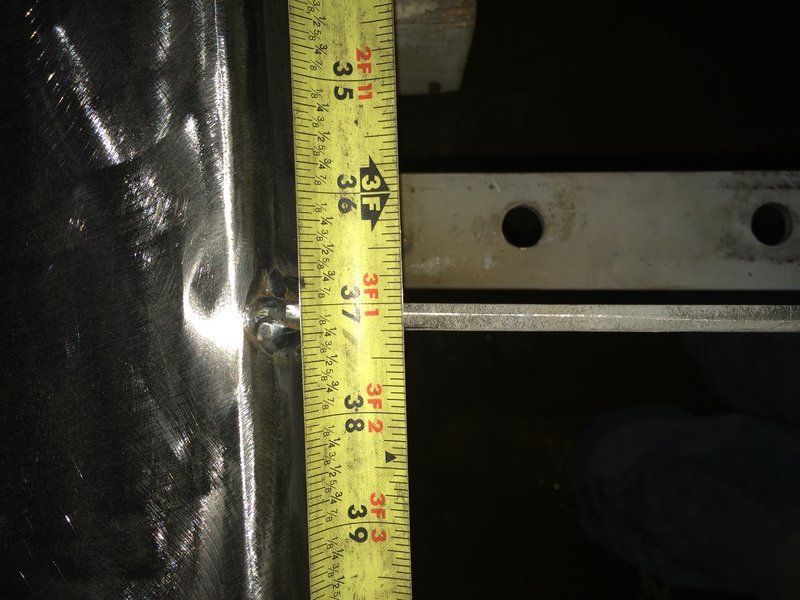

    Bumped bolted on.
    Tail gate up:
    Tail gate down:
    image.jpgIt's hard to see since it's so dark out but with the tail gate down the bumper has about a 3/8-1/2" inch gap. This was as high as I was comfortable mounting it.
