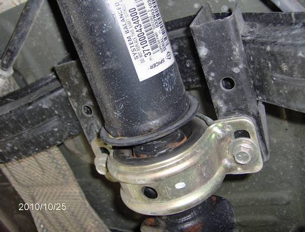

    Here is mine:

    I agree 100% the 2wd looks like its directly under while 4wd is offset. Anybody have and evidence to debate that. All of the pics with 4x4 are offset and 2wd is directly under. Any objections?

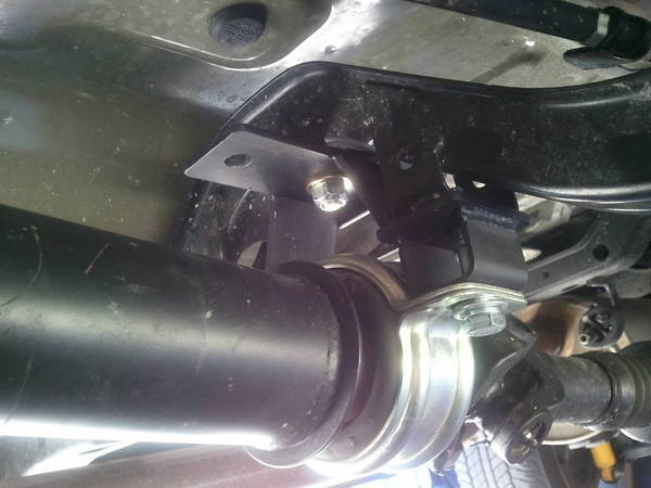

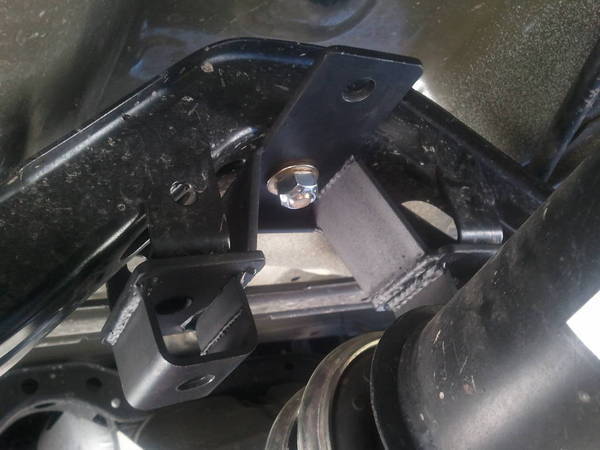

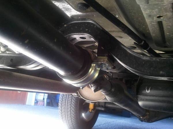

    Just slapped my Beefedtaco CB drop on this mornin'. I have an '11 DC/LB 4X4, and it has the centered mounting holes on the crossmember, not offset.
    Hope this helps alleviate some confusion.:)

    Not a problem Brian, thanks for your email replies, they helped out immensely. So far so good after the install. It got rid of the off the line shudder, no other driveline vibes at all. Now I just have to fix my differential bearing vibe (that should be a good dealer visit). Thanks again Brian.
