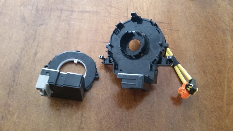

    I got a new on on ebay, the part numbers listed on the part itself did not match my TRD-Off Road's (2010) but I installed it anyway. Everything so far is working well, minus steering wheel controls (but I don't have my adapter installed to the new radio so I can't test it yet). Horn works, and the airbag light went off like a champ though!
    There is one last thing... on mine I had to swap a part onto the clock spring from the old one. It just snaps off, has a large grey connector going to it (I'm presuming this is steering controls or something). It snapped right onto the replacement no issues.

    Thanks for the instructions, did it yesterday.. had to wait to get steering puller, but finally steering came off almost by itself.
    Now I have to do it again because the clockspring that I have (and the one shown in the pictures) doesn't have the gray connector (maybe for steering controls?) like the one on my truck, so I need to order another one.
    edit: just read the post above mine... you're syaing the gray thing is swappable? damn I have to check that tomorrow!!!

    Beachboy, I think your '09 is covered by the recall. But either the dealer or Toyota will reimburse you something for your effort. And yes the grey thing is swappable.

    Great write up. My only problem was that my horn stopped working. Dealer wanted $450 to replace the clockspring. I paid $229 with shipping to Discount Toyota Parts and got the replacement clockspring. This project took me about an hour.
    As noted above there was a grey connector that needed to be snapped off the old spring and snapped on to the new one. Here is a picture of the grey connector. It seems to have a sensor to measure the movement of the steering wheel so maybe it's related to the vehicle stability control? I don't know.
