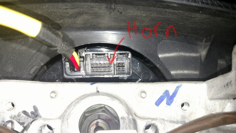

    now I dont have any horn
    again:frusty::help:

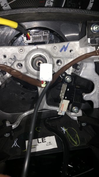

    so im stuck guys, I put in the new radio spring, hooked everything up and now when i put the cable on my battery the horn wont shut up. So i unplugged the wire harnesses that plug into the top on the radio spring and the horn stops. I grab my continuity tester and put it on the prong that meets up with the black wire that goes to the horn pressure switch/airbag and the other end on a ground and the horn goes off again. Im in a pickle can anyone help?
