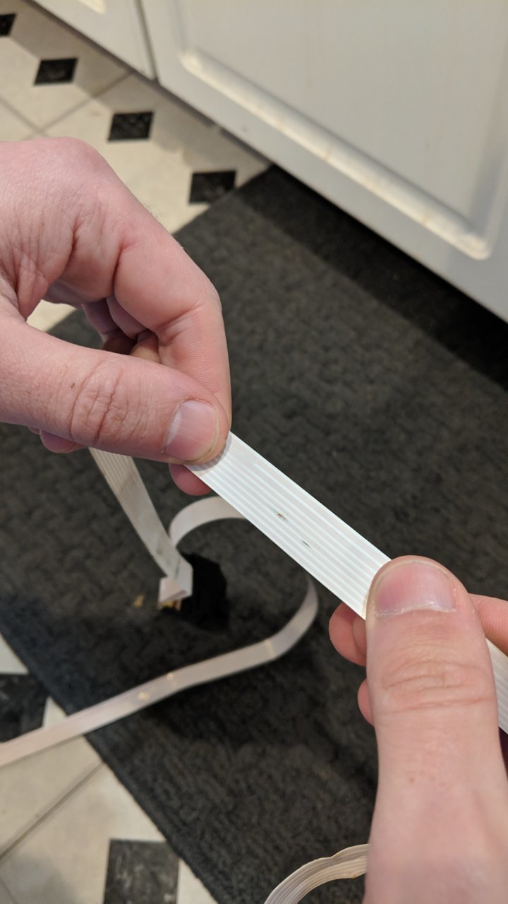

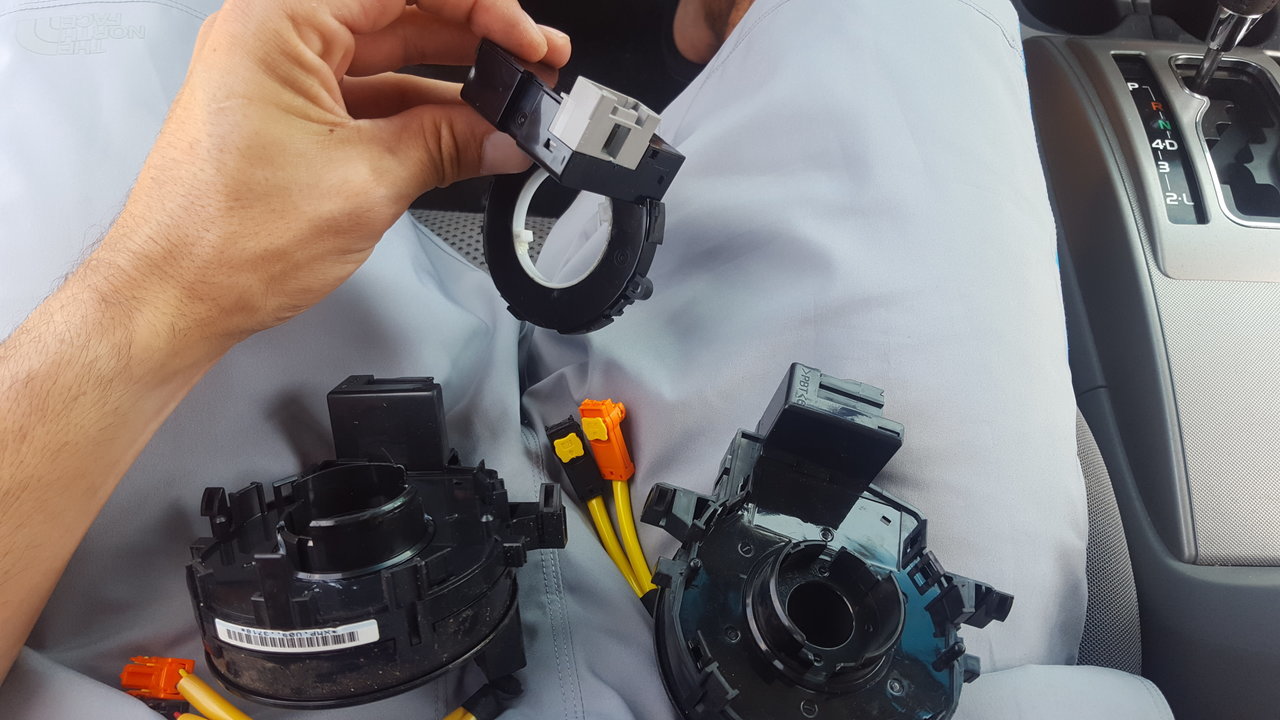

    Have you seen photos of the inside of the clock spring - specifically the tape on the inside with the contacts? Some people have damaged leads across the entire tape, others have just one or two burned or rubbed through. Point being - its easy to see how you can lose just one while the other work. I'm going to dissect mine today and report my findings. The ONLY thing that stopped working on mine was the cruise, so I'm expecting to see most of the other copper leads intact.

    I haven't but I'll be interested to hear what you find. I thought it was weird I didn't, or haven't yet lost my cruise. I did lose my steering wheel radio controls too.

    Just got it all apart, and didn't see anything as bad as some have posted. I did find one section that appeared to be worn through on both sides, but it was on one of the copper strips. Maybe it was my problem...?
    AR15xAR10 likes this.
