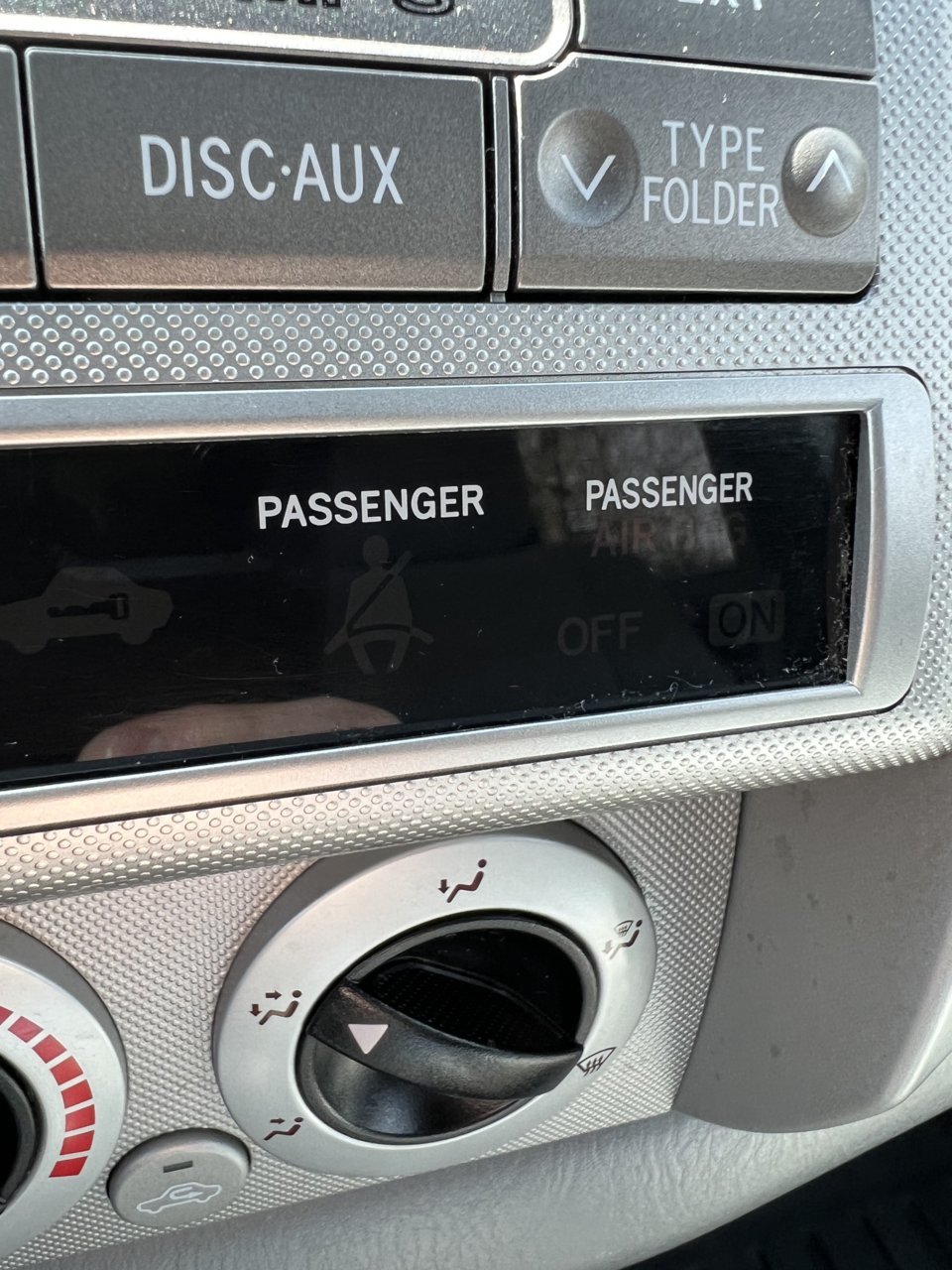

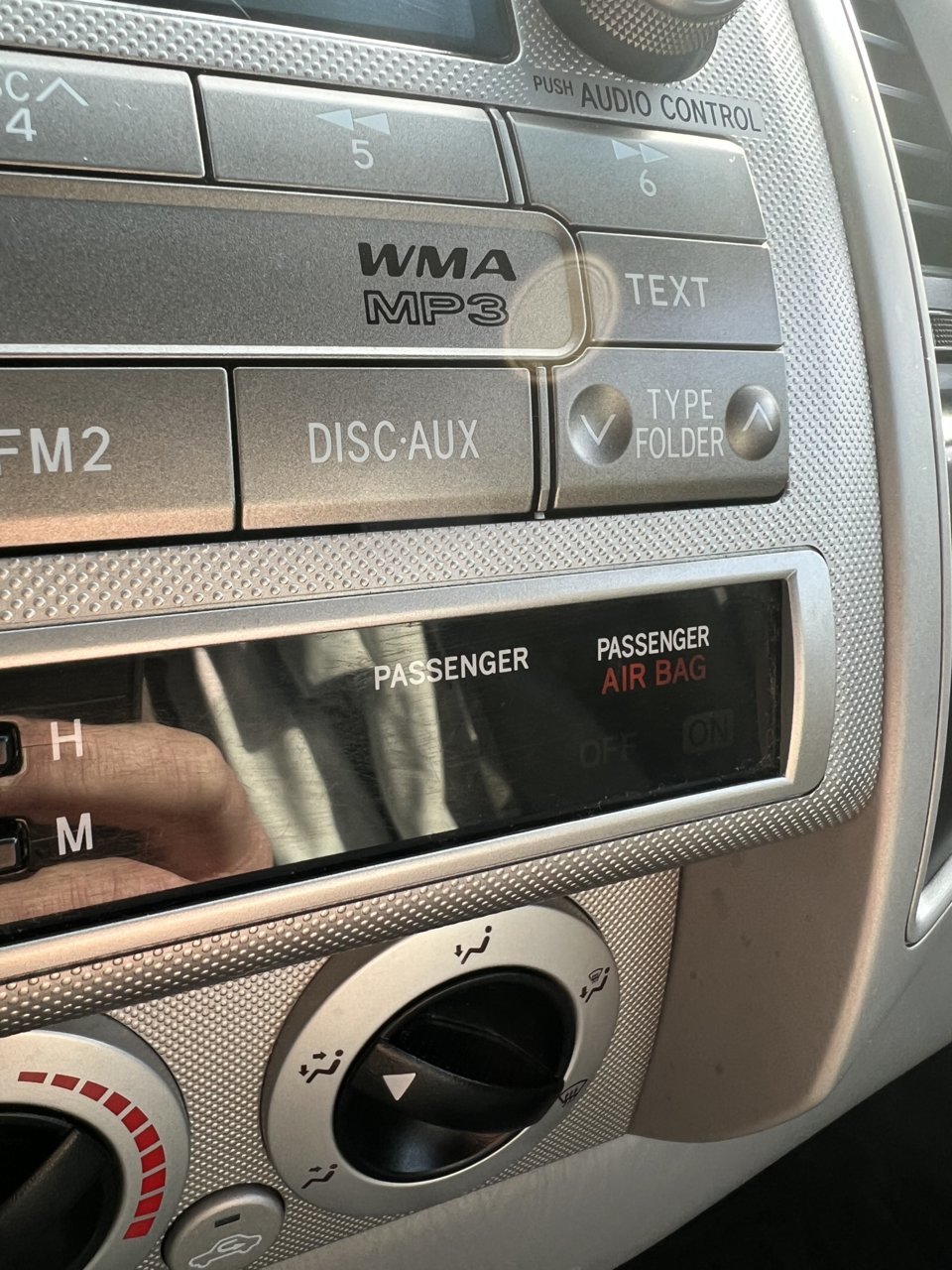

    Snapped a few pics (below) of airbag display. Anyone know if this means my drivers side airbag isn’t functional at the moment? Haven’t had a chance to check the manual, so thought I would check here in the meantime. As I said, horn doesn’t work, but just curious how you guys know if the airbag isn’t functioning based on lights on the airbag display or if another light shows up on the main dash display if there is an airbag fault. First pic bo lights are on, but can’t remember if truck was on or not. Second pic only passenger airbag is illuminated.
