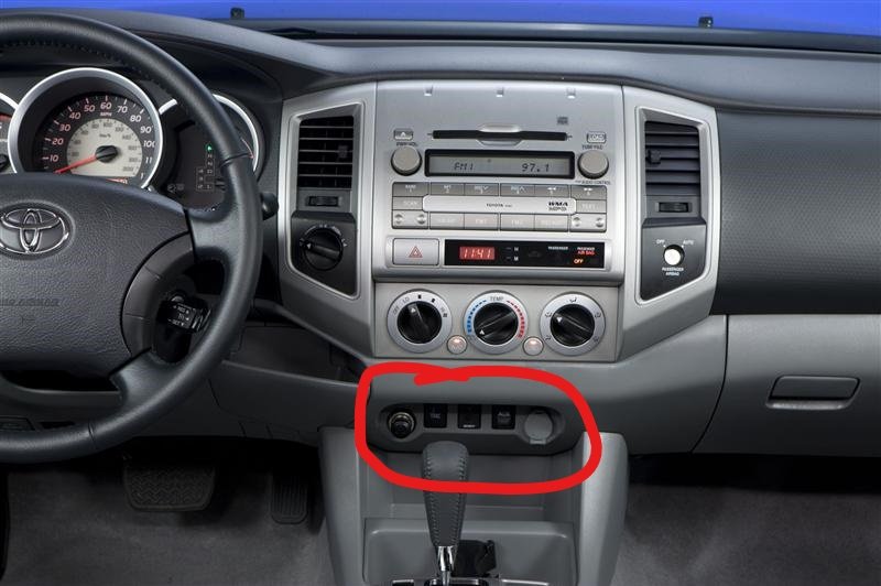

    Does anyone know where I can find port inserts for the unused ports (next to the aux input) on a 2nd gen dash? Specifically a USB port as I just installed an Alpine ILX650 head unit.
    Attached a picture for clarity:

    Get a blank cover and dremel a hole for the Alpine USB.

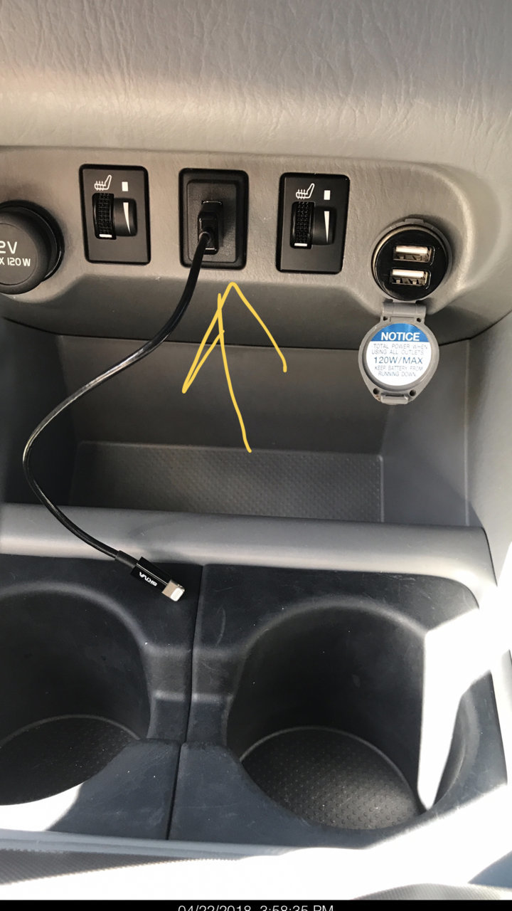

    I used the exact plug your going to have to trim the blank to fit. 5D72855C-8697-4E1C-AEFE-CEAE8AD82260.jpg

    I installed the same Alpine in my 09 in Aug and used this cable: https://www.amazon.com/gp/product/B078LRSZDB/ref=ppx_yo_dt_b_asin_title_o05_s00?ie=UTF8&psc=1
    BATIGE Square Single Port USB 3.0 Panel Flush Mount Extension Cable with Buckle for Car Truck Boat Motorcycle Dashboard 3ft
    Works great for Apple and Android. Just got a blank and used a exacto knife and a dremel to make a hole in the blank so the plug fit.
