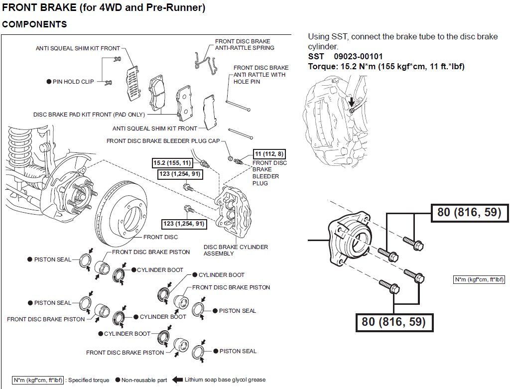

    Hood Struts, My version Fogs always ON, Map & Overhead Light Mod,
    OP..if yous around still, can you verify torques for installed parts? Or didya wing it?

    I'm not the OP but I did the mod and used the factory spec torque on a 4x4.

    The specs on your attached diagrams is fine..

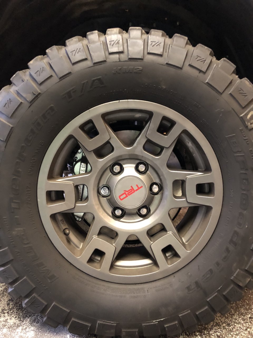

    Thanks OP for the write up! I went with the 4Runner / GX set up.
    The wheels are 17” TRD wheels in matte gray
    I also replaced then small hard lines going to each caliper, so I wouldn’t have to “re work” the factory Tacoma ones. Went with the lines that correspond to the calipers used.
    edit: brake line p/n 47314-35320 and 47316-35280
