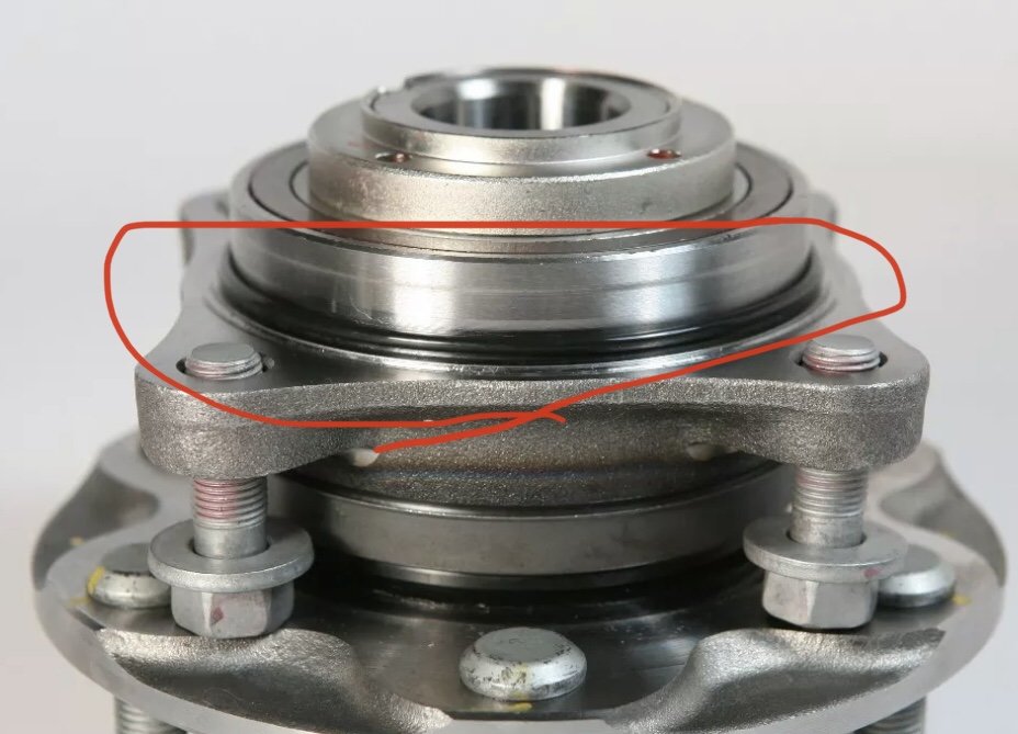

    When replacing the dust covers for the 4Runner ones which are larger, is there any sort of gasket or seal that goes between the hubs and spindle?

    It's been a couple beers since I did mine but I believe they're just metal to metal. Do pay attention to the correct orientation, since I know someone that screwed it up...

    There is no gasket, as it’s hub, dust shield, knuckle. But there is a large o ring that goes on the hub to seal it against the knuckle

    No gaskets or sealants. Just metal to metal

    Isn’t the o ring for 4x4 only?

    No it’s for all the front hubs. this pic is a 2wd assembly. You can see the see the o ring circled. D9CD7314-9925-4A8A-B772-411090CED3AA.jpg

    Got it. Forgot there was a small o ring on the new hubs.

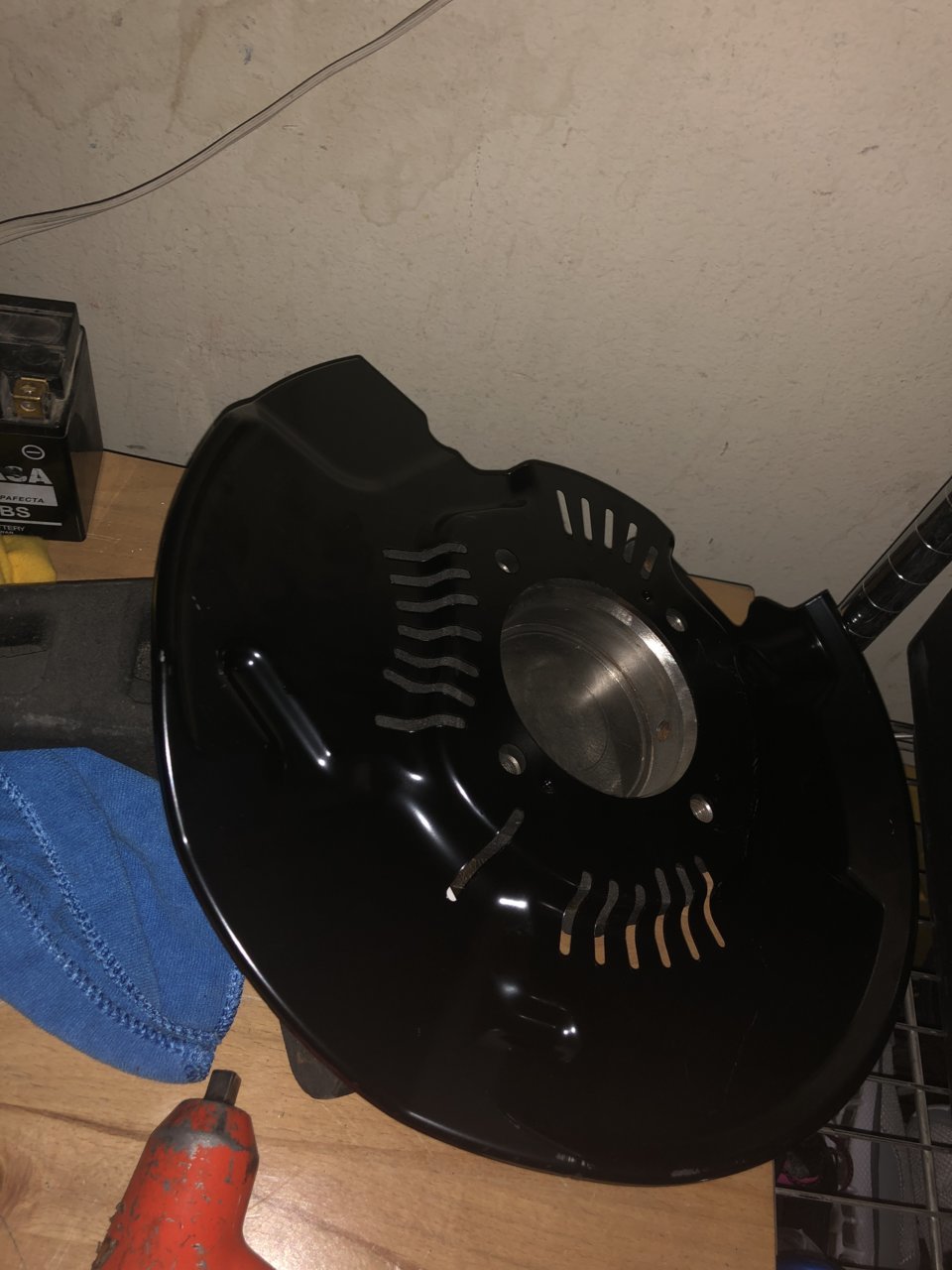

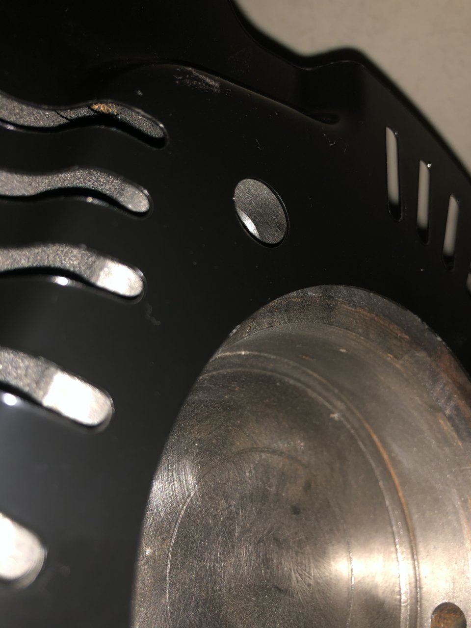

    Now I have a question, has anyone done this upgrade with Maxtrac spindles installed, because I’m pretty sure these 4 runner dust shields aren’t sitting flat on the spindle, which sucks because now I’ll have to make cuts to brand new set of $100+ dust shields.

    Bump, anyone know where I should cut if anyone has installed with Maxtracs or if I should forgo installing dust shields?
