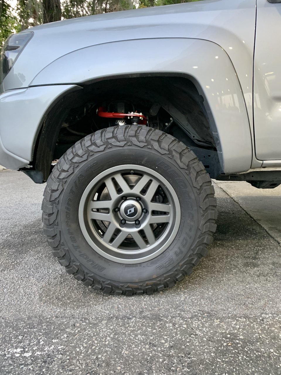

    BE AWARE REGARDING CLEARANCE ISSUES- this kit will work on 17" wheels and the top edge of the caliper will clear the "tire" side of the rim; however, it is VERY possible that the back side of the wheel spokes (or whatever your center webbing looks like) can hit the outer edge of the caliper.
    SUGGEST you *lightly* tighten the lug nuts and then spin each wheel to check for interference before torqueing them. We had to put 3/4" wheel spacers on his hubs to move the wheels out in order to clear the calipers.

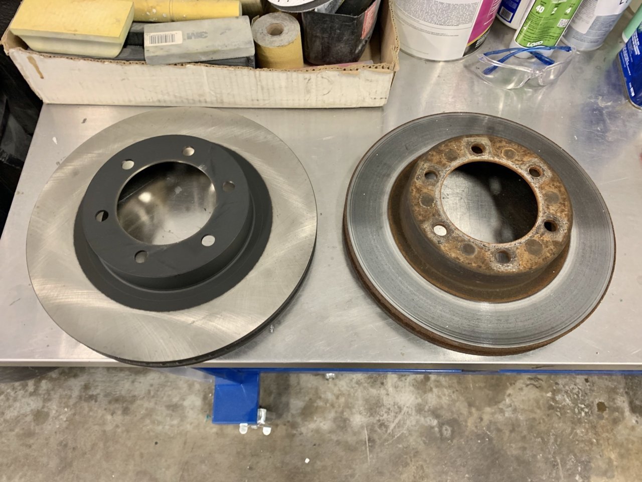

    I will always recommend this anytime the front brakes are replaced. I've been rolling with the GX brakes for over a year.
    It was definitely time for the swap.
    Before
    Not a massive size difference in the GX470 rotors vs the Tacoma, but you for sure feel it while stopping.
    I bought all the parts listed in this thread.
    As a bonus the bigger brakes fill out the 17'' wheels nicely.

    Were the 17" wheels that were very close to the "wheel spokes" Toyota OEM wheels? Any chance that you know what the offset of your wheels were?
    If not, could you post a picture of the wheels - please!
    Thanks in advance :thumbsup:
