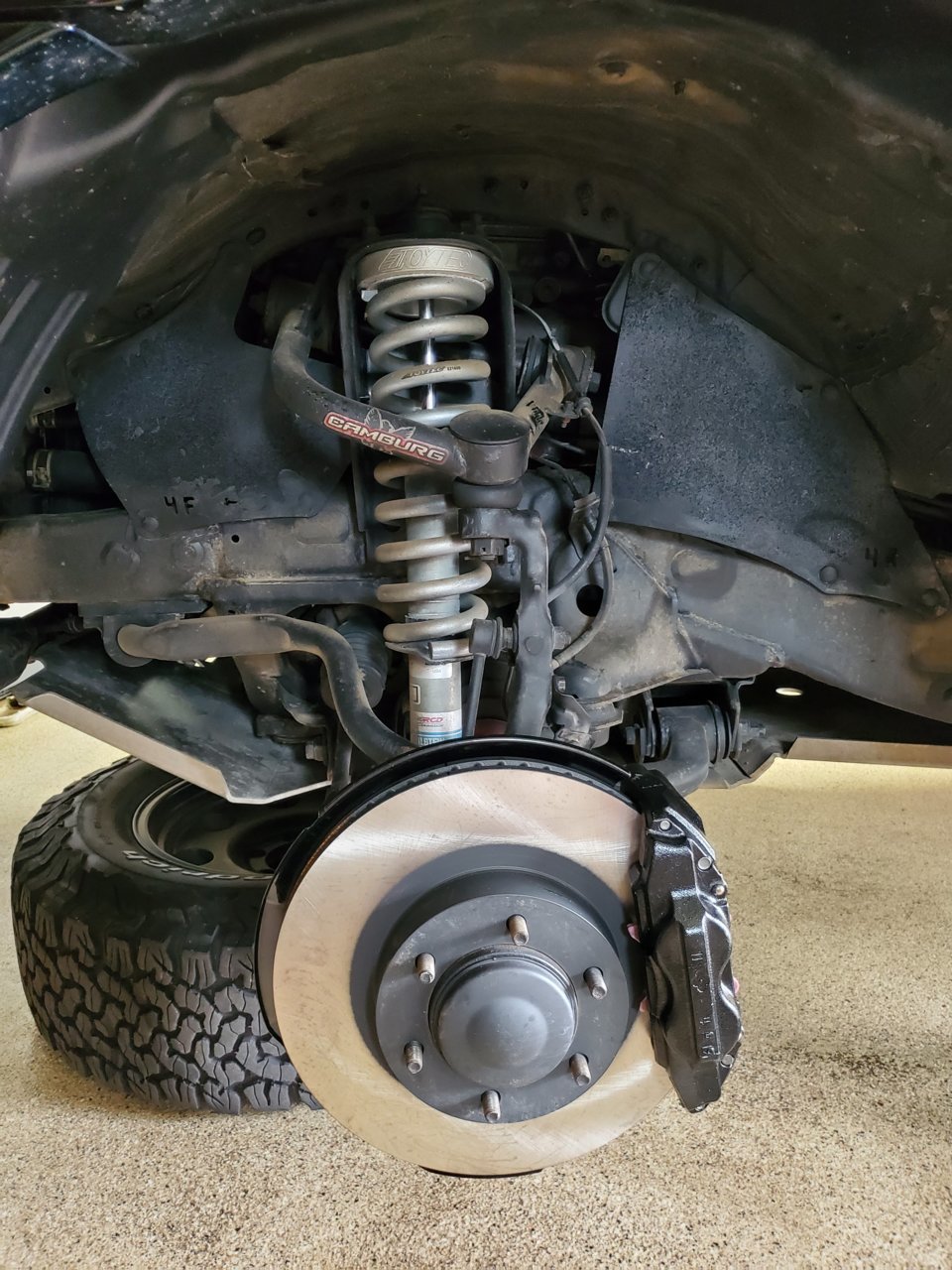

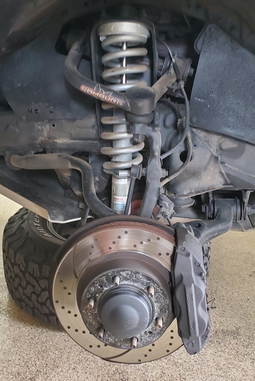

    Very simple and straightforward brake upgrade.
    I am running American Racing 17" rims with no clearance issues.20210904_123430.jpg
    Previously I was running the EBC rotors with Green Stuff pads. I was happy with performance, but they were worn. I had gone through 1.5 sets of pads and the rotors had worn to the bottom of the drilled holes and slots. Saw this mod and decided to go for it.
    20210904_085019.jpg Did the driver's side 1st and checked for wheel fitnent. All was good so I continued. Altogether it took 5 hours working at a relaxed pace.
    Took a brief test ride and the brakes feel like an improvement, looking forward to more windshield time.

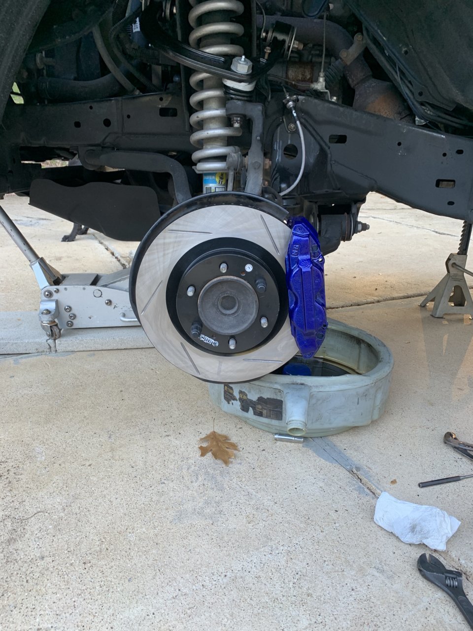

    I did this upgrade, no need for master swap imo, brake work great. I used 4runner calipers, StopTech Cryo slotted rotors and hawk pads. I also had calipers powder coated to match the truck. Great easy mod
