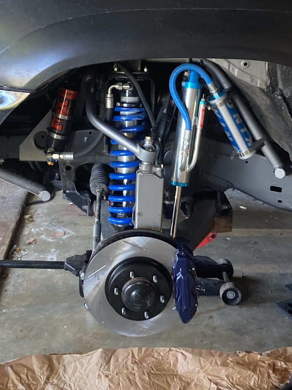

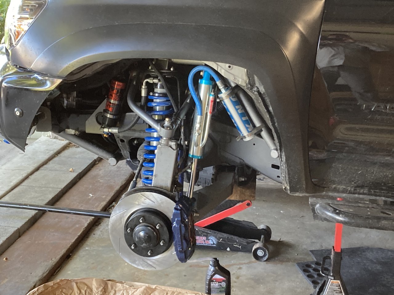

    Finally got around to doing the install with the help of 99% of work by @El Taco Diablo and @roguegs. Passenger side went pretty smoothly, until we realized that the Akebono pads that I'd ordered were in fact the ones for the rear discs of a 2003-2009 GX470. Oops. Bought a set of Napa Premiums to use for now. Driver side was a complete clusterfuck, with us resorting to using a 3-arm puller to get the axle out, and then finding (during bleeding) that the driver-side Napa Eclipse caliper had poor QC and had the bleeder system clogged with sealant. After we removed the sealant, we were able to get it to bleed, but the bleeder valve itself leaked from the tip repeatedly. Ended up running over to O'Reilly's and buying a second driver-side reman caliper, which thankfully installed fine. No problems bedding the pads.

    glad it all got sorted out…honestly I need to upgrade my stuff too but holding out for the 6 position BBK kit since I’m a heavy pig. At least I know I can stop with the current setup thanks to the brake test earlier today :anonymous: Saturday shenanigans in Hughson today with all the horrible drivers :rofl: those two old ladies were getting into it!

    2011 Tacoma SR5 (V6/AC/4WD)
    Feels no different from OEM to me.
