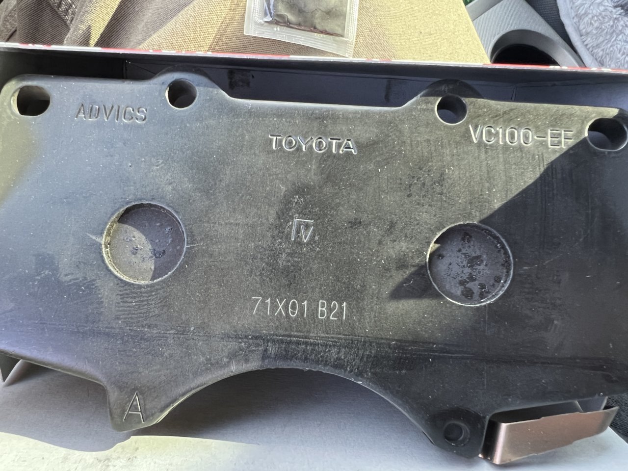

    Has anyone used the aftermarket Advic pads & rotors? Wanted to know if they are any good since they are the OEM manufacture that toyota uses to make them.
  6. Mar 3, 2022 at 8:25 AM
    #386
    Murphinator
    Murphinator Well-Known Member
    Mar 1, 2015
    #149903
    3,335
    Anthony
    SoCal
    14 DCSB 4x4
    I haven’t used them, but I wonder if they aren’t the same pad just not labeled toyota? Here is the back of the oem pads since I am going to be replacing mine soon. 2A0505A1-908D-4767-B09B-05A847A49BFE.jpg

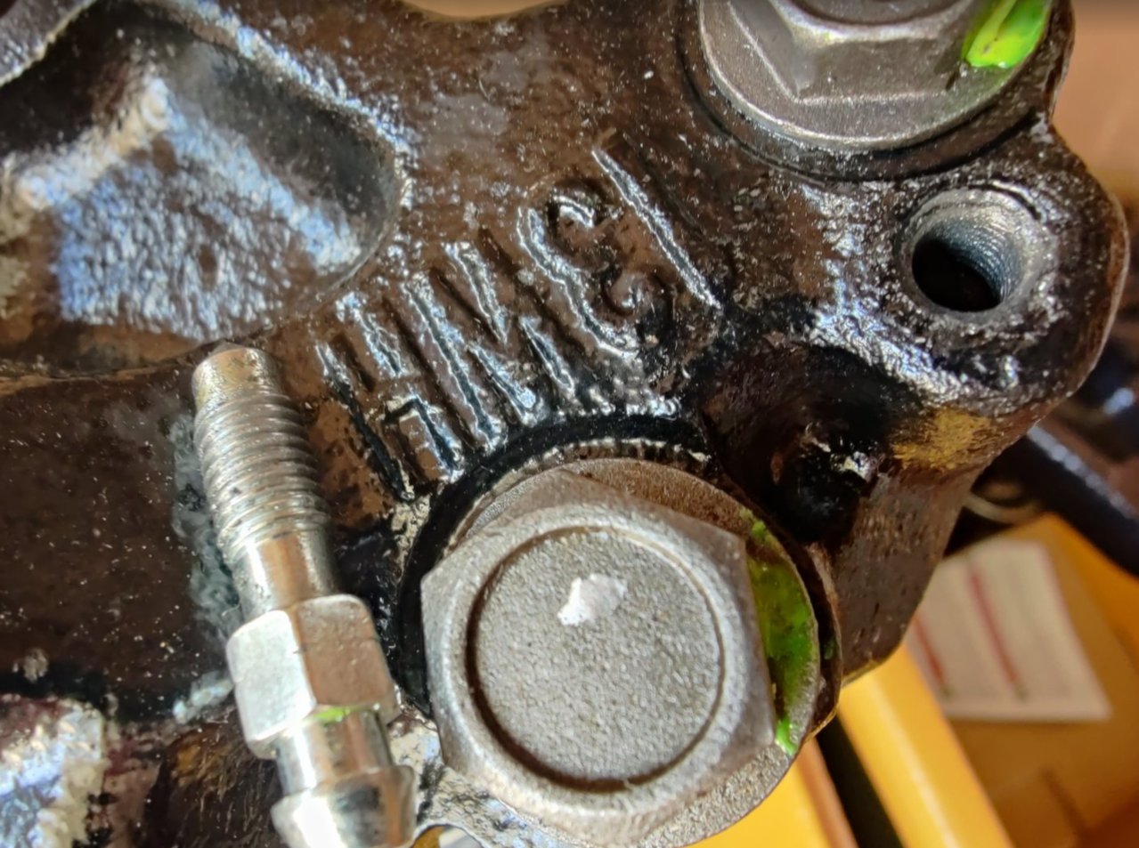

    The bleeder screw on one mine was stripped out and wouldn't seal. Unfortunately I didn't notice it until I was bleeding them. NAPA exchanged it no problem but I lost a day waiting. Give it a check before you start.

    Mine was the same problem, except it was also filled with sealant, so it went from being unbleedable to uncontrollable bleeding. Great QC...

    Was it the right side? (3317)
    I just checked, and the left bleeder threads are clean, but the right is stripped/tight/dirty.

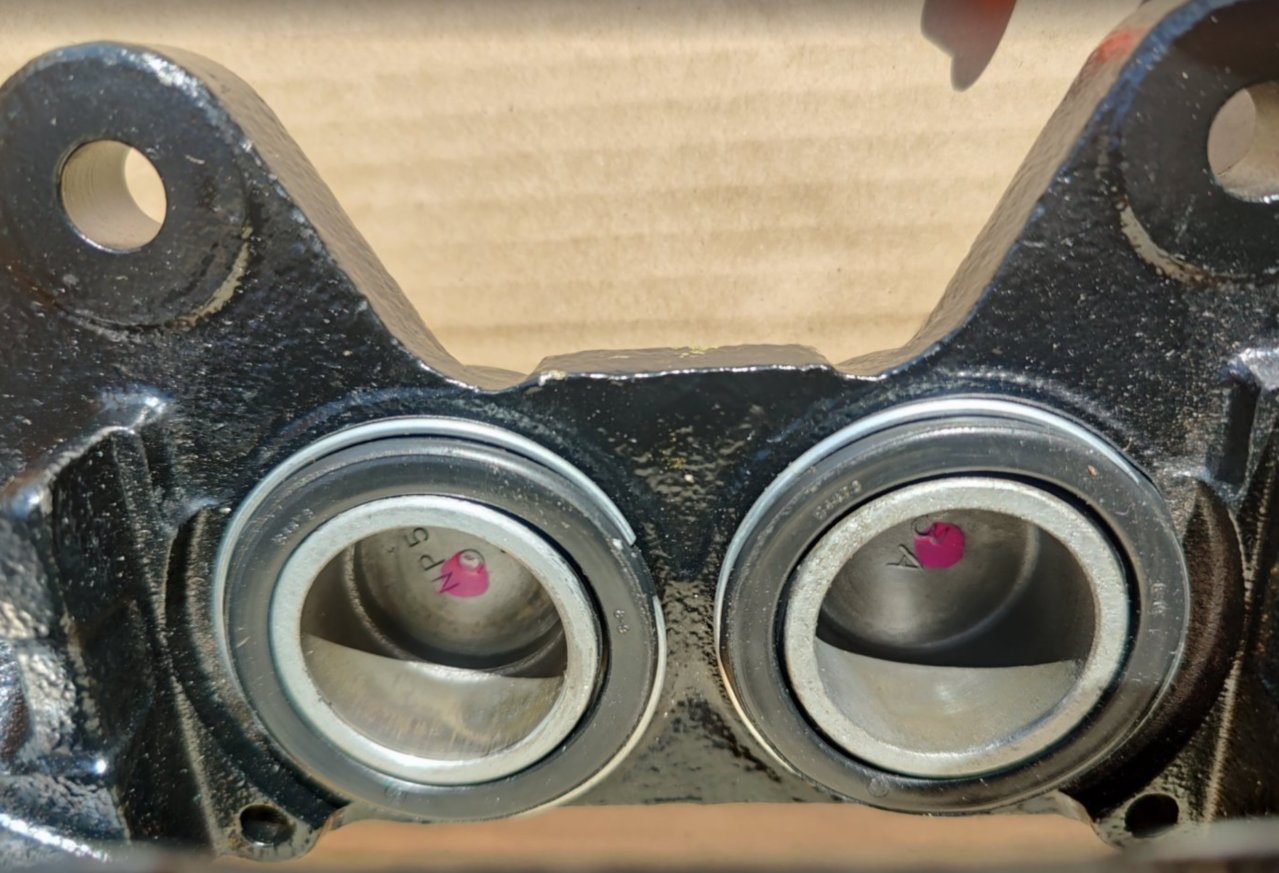

    Ok, so I just dropped off the SE3317 at Napa for a warranty exchange.
    News: Napa has changed their Eclipse product line to ADO (Adaptive One Brake Calipers).
    https://www.napaonline.com/en/p/ADC1797XA?impressionRank=2
    I'm told this is due to the bleeder valve issues...
    They're currently replacing my right caliper with an ADO variant, and I should have it tomorrow to inspect. He was apprehensive about swapping both out, since he's eating a price difference.
    The other option was to pay another $29 in freight to ship the closest Eclipse from Nebraska.
    Anyone use ADO calipers before?

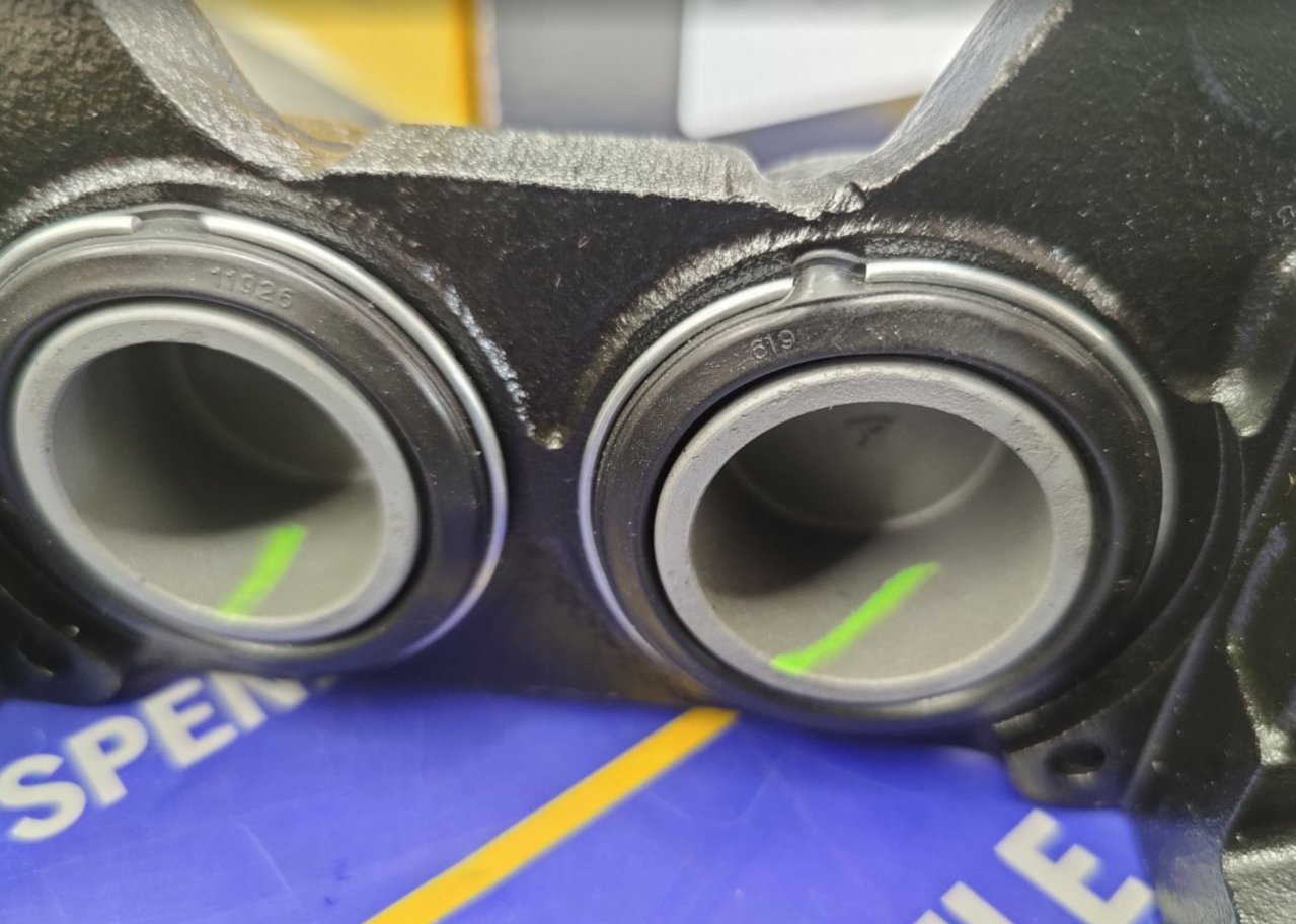

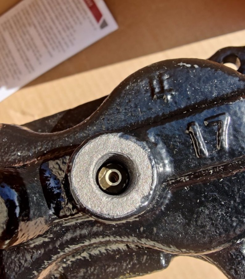

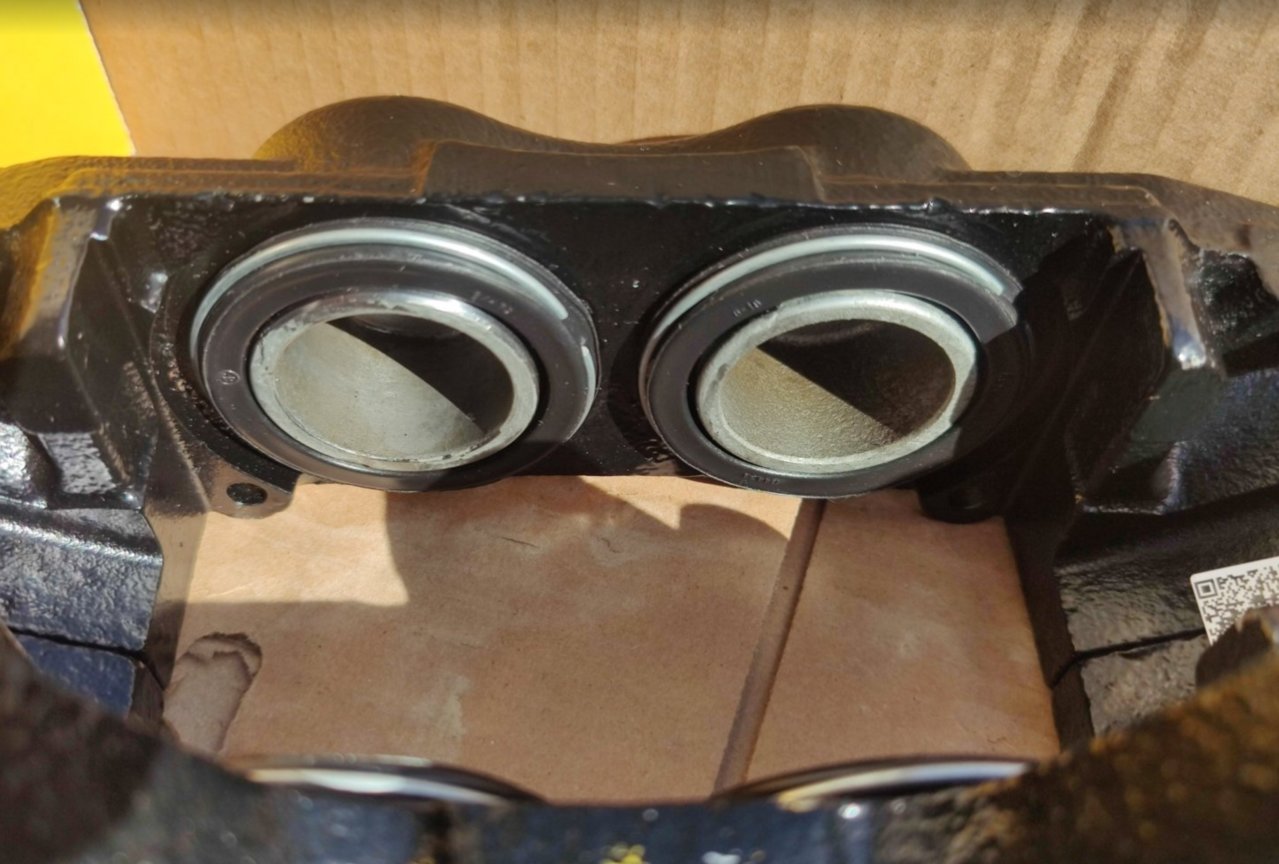

    Well, after checking the brake-line inlet on the other Eclipse, I determined it needed to be swapped out too.
    Picked up the replacement ADO yesterday, and was told to return today for the other side.
    Here's the ADO on the left, and Eclipse on the right.
    Threads on the ADO look good, but the coating isn't anywhere near as thick/nice as the Eclipse.
    The ADO has a few gouges and scratches down to metal, but the pistons are not pitted like they are on the Eclipse.
    Here was the inlet on the Eclipse I took for exchange yesterday:
    Eclipse pitted/gouged pistons:
    Eclipse again:
    ADO pistons, also pitted, but minimally:
    Drainbung likes this.
