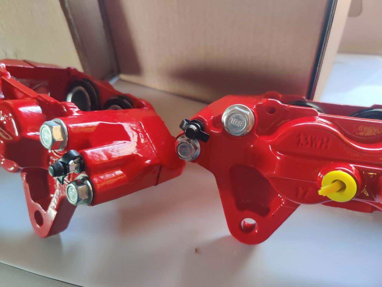

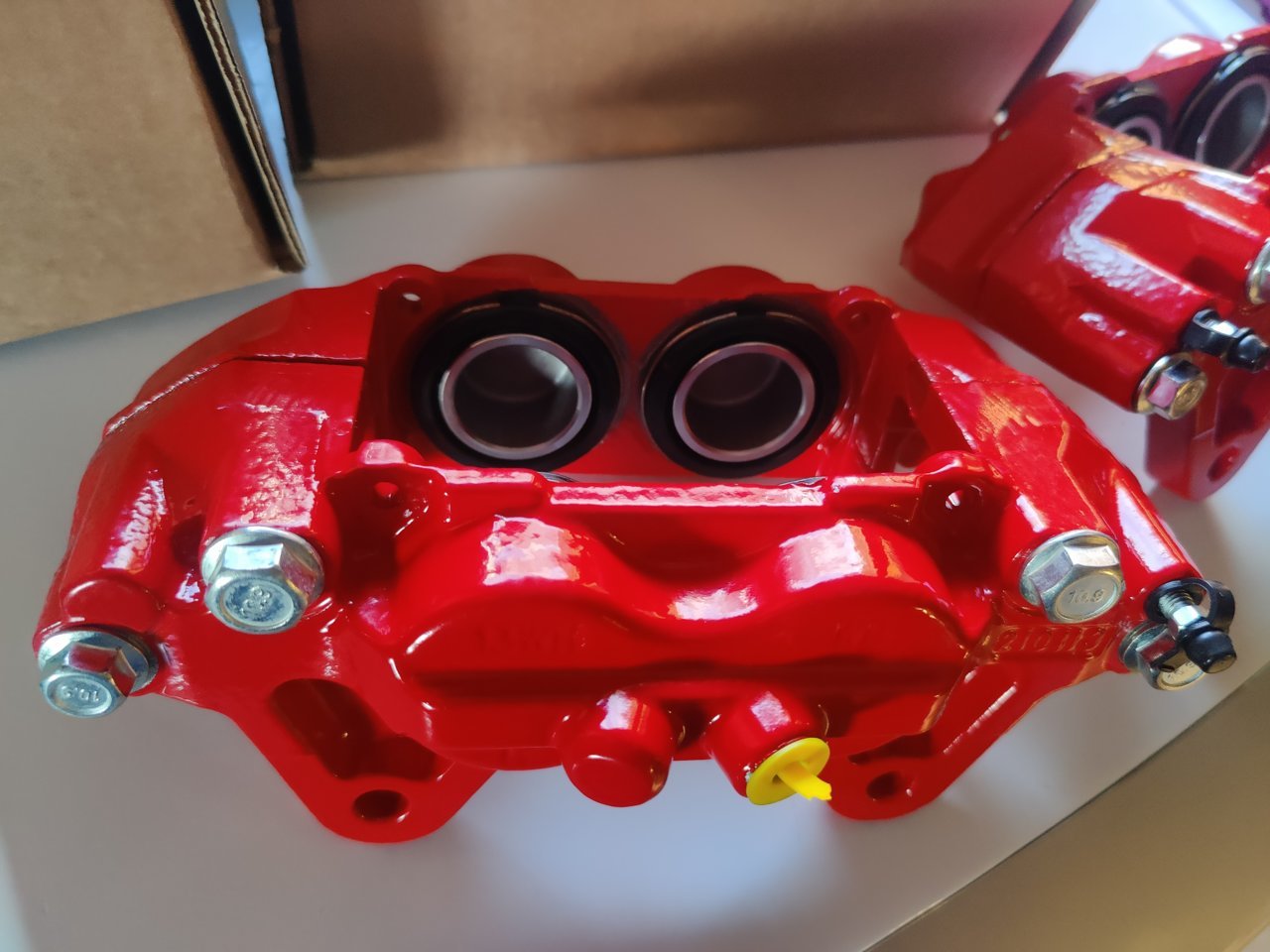

    After getting my money back from Napa, I now have a pair of red powder coated Power Stop calipers. They look much better, and cost about the same. I was waiting for warmer weather, so I could swap these brakes and my coilovers; maybe sometime next month...
    Drainbung and Jared8907[QUOTED] like this.

    Those look nice.
