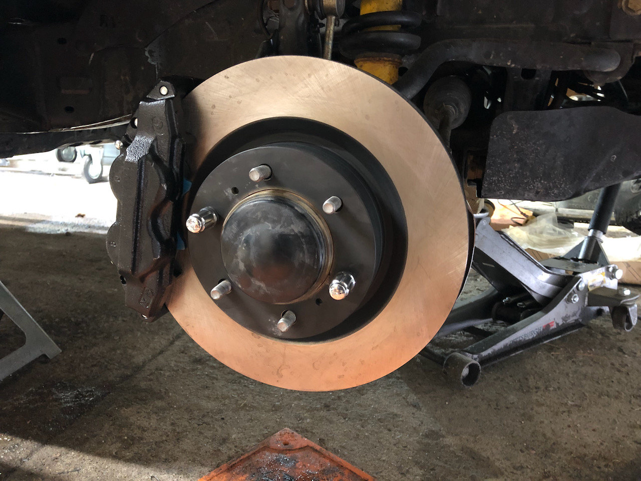

    I have been running them for a few months now...maybe since April? No issues with install and no issues since then. Let me know if there's anything else specific you'd like feedback on.

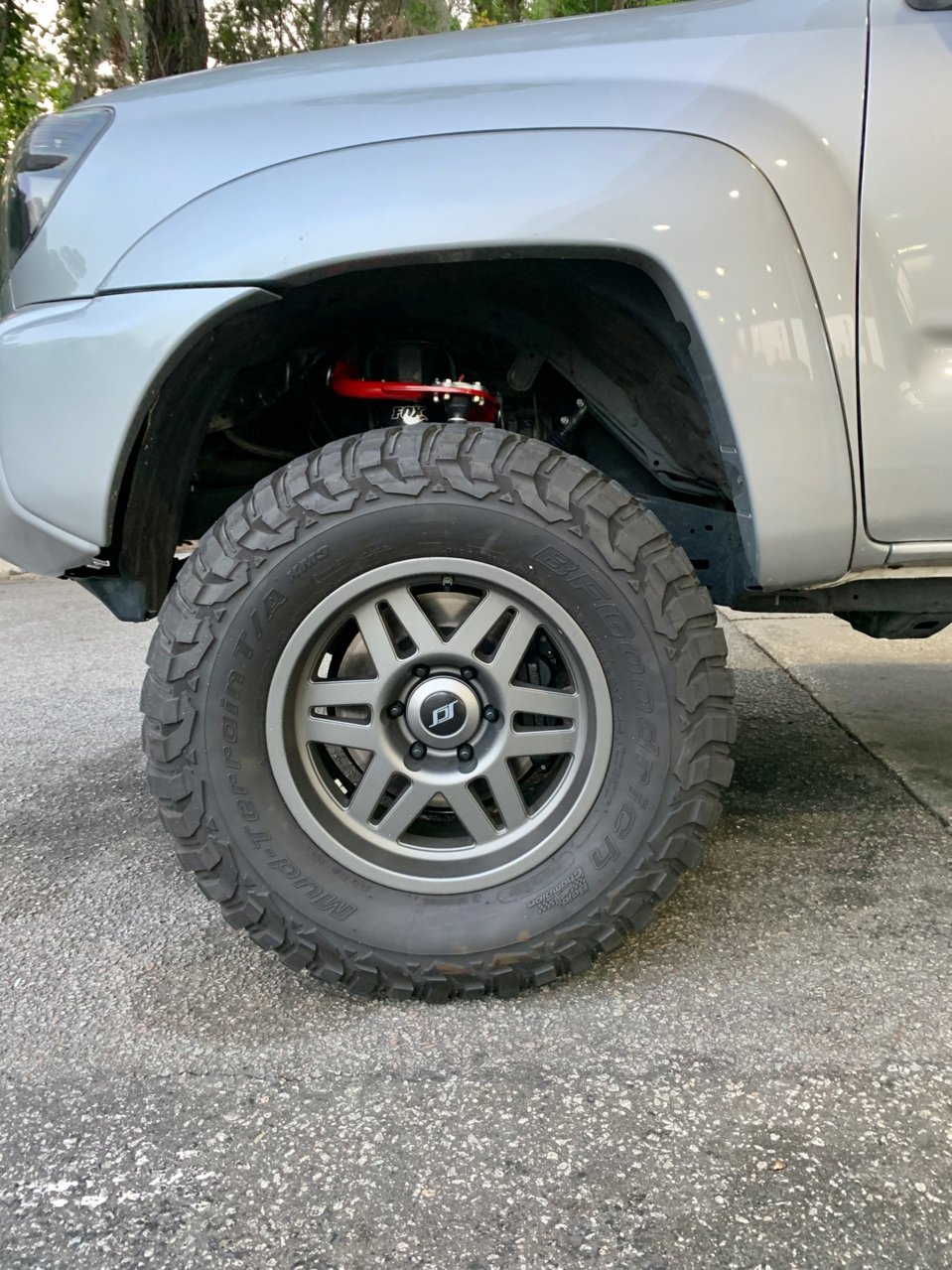

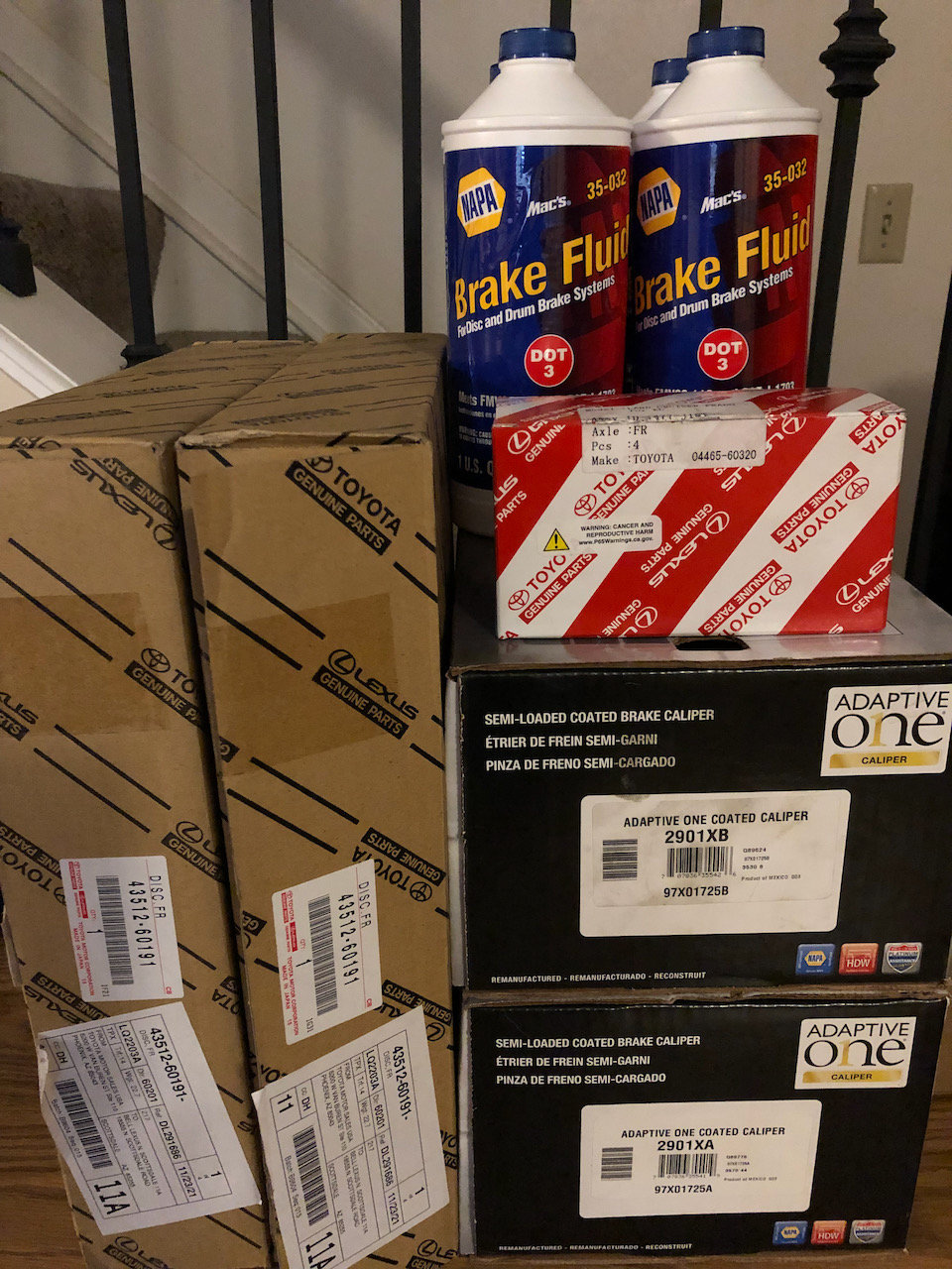

    Had this done in January. Overall I'm happy with the upgrade. I went with OEM pads/rotors for the 2013 T4R & NAPA calipers. Also swapped out all 4 brake lines for the braided stainless lines from Wheeler's.
    Brake pedal travel did not change noticeably & is firmer - still not great, but better than stock! Only issue so far was a fitting that came loose on the driver's side in July & bled out all my fluid. Made for a scary drive home from the grocery store with only the E-Brake functional! :eek: Easy fix & has been solid since.

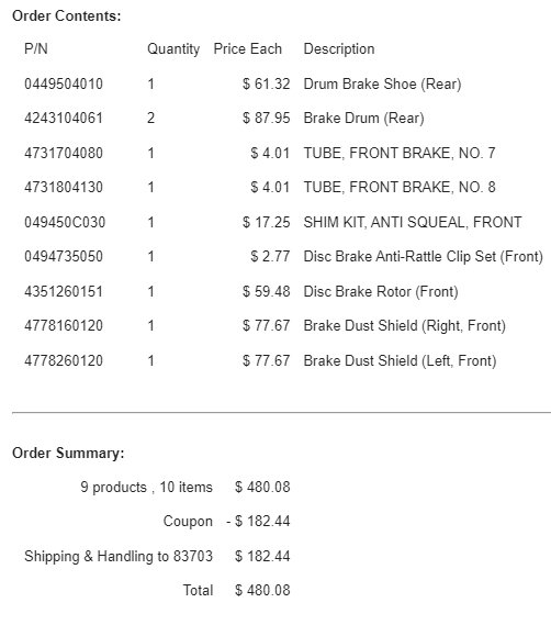

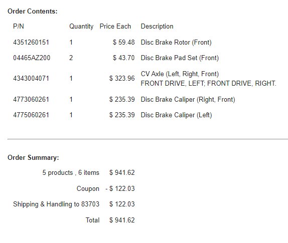

    Worked like a charm! And you cant beat free shipping when it comes to car parts haha.
    Here is what I ordered and current prices from this vendor. I opted to go with new calipers vs reman's. Also, popped my inner cv joint out while hunting over Thanksgiving. Got it apart and put back together to get home, but this would be the third rebuild (the other two were boot tear related) so I think its just time for a new axle. I will likely rebuild it though since I already have a boot kit and then throw it in as a spare that's ready to go.

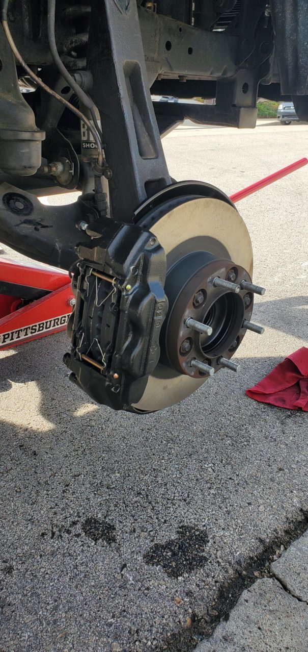

    Excuse the dirty wheel spacers, just completed the swap today. I will say that the bleeder screws on the Napa calipers are horrible. When trying to bleed the system, fluid creeps past the threads and air gets into the lines. Going to try and swap them with my oem screws

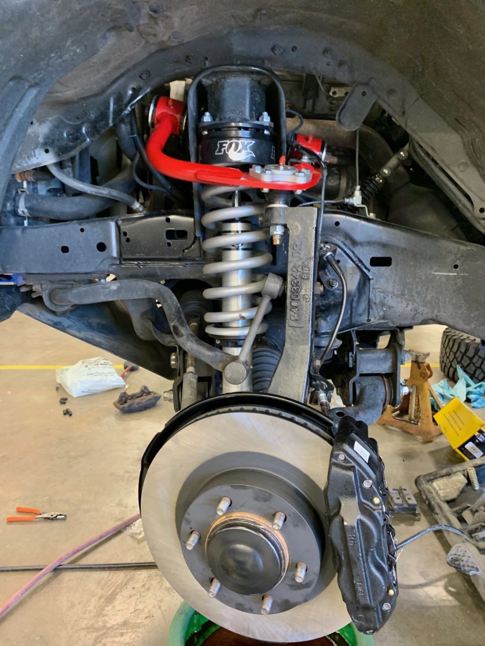

    This swap has been great for a few years now, I will say after a while the Napa calipers allow the brake pads to shift enough they give a very audible click any time you shift from reverse to drive. So I'll most likely be going with OEM calipers next time I replace the brake pads.
